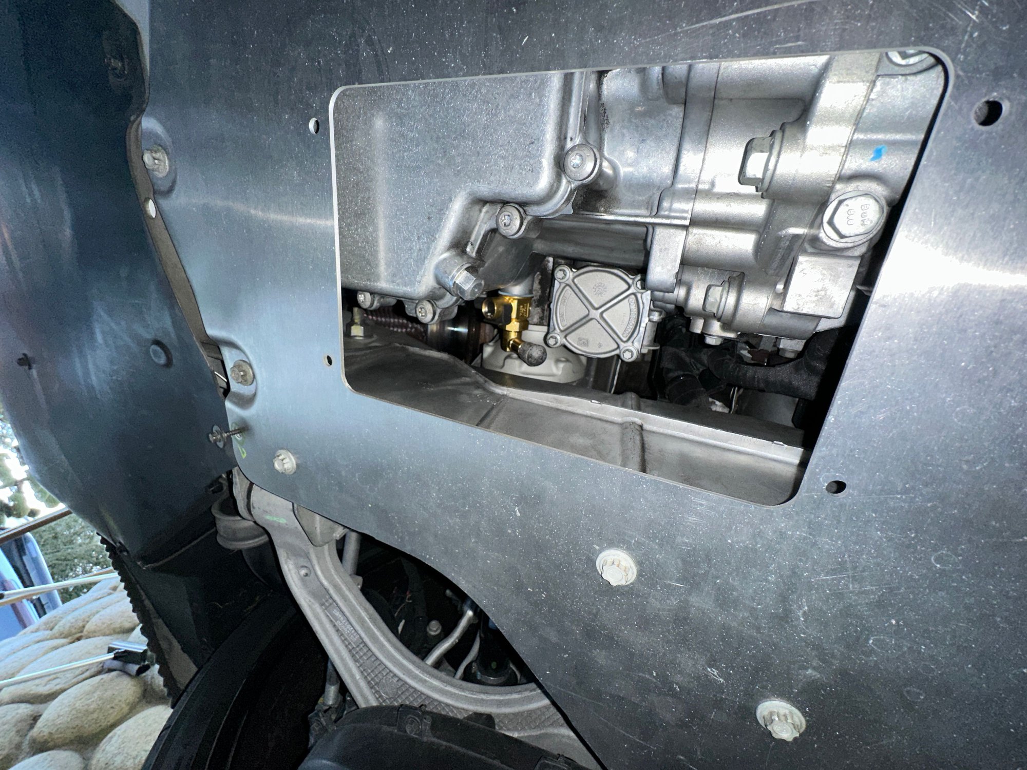

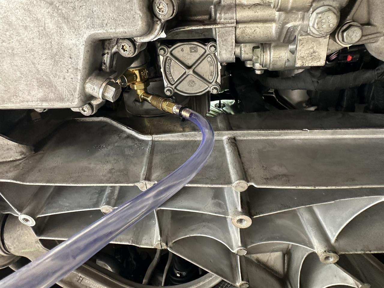

Changing the transmission oil is a tedious process that requires removing a total of 43 bolts ?an
d two panels.
So my friend and I came up with the idea of ​​creating a small window in the underpanel. This allows us to access the transmission drain bolt and filter by removing just 4 screws, saving us time.

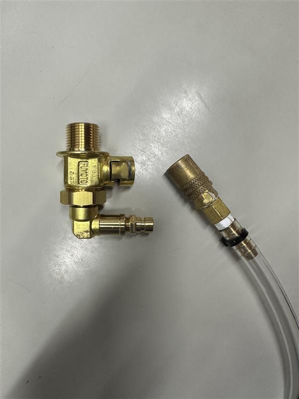

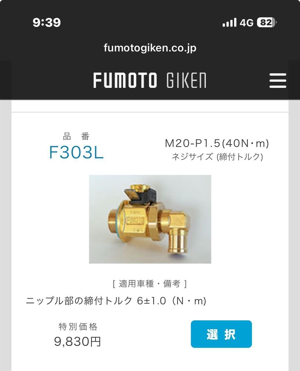

We also installed a FUMOTO valved oil changer F303L on the transmission fluid filler port, drilled a 1/8 tap on the inside of the outlet port, and attached a Jiffy-Tite one-touch nipple.
We then used a 12V Oil Extractor Pump (about $20) to connect a Jiffy-Tite one-touch coupler to the end of the hose, and pressure-fed the transmission oil. This allowed us to fill 10.5 liters, which would normally only be possible from the top of the transmission. This eliminated the need for the tedious process of removing the air cleaner, among other things.

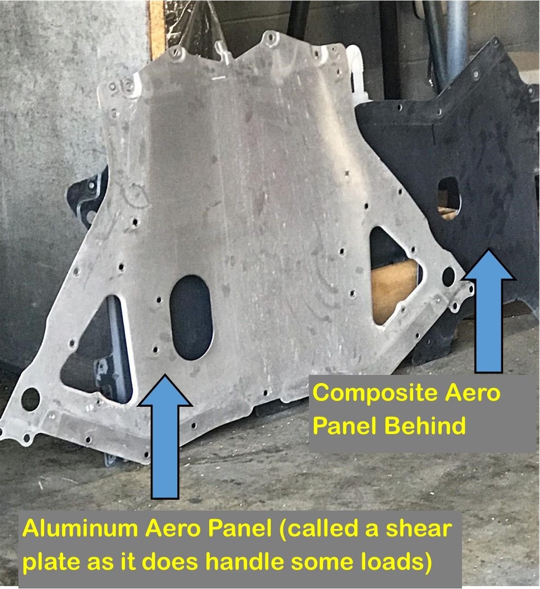

Cutting a hole in the shear plate isn’t a new idea, people have been doing it for years now. However, it’s a structural part, not just a close out panel. It takes me 2 mins to zip the bolts out with an impact, not worth cutting it up.
I did a similar thing with a Fumoto valve And a 2.5 Gallon Air assisted Mityvac.

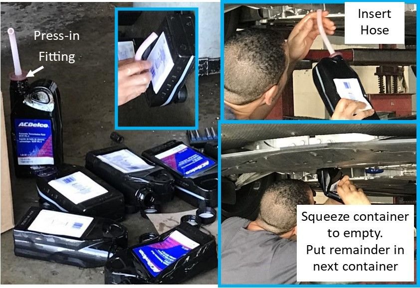

My Dealer C8 Trained Tech has a somewhat unique way he filled my 2020 C8 DCT. Took ~5 minutes no pump needed! I watched. BTW, dealing with all the bolts is a non issue with a battery powered wrench, as he used.
He has filled "a few" transmissions over the years. Uses this method that took a total of about 5 minutes! He has a semi-flexible tube extension that "presses" into the 1 Liter bottle. Does not have to thread on, it's a rubber tapered bottom. An advantage of today's "thin for low cost" bottles (not quite as bad as some water bottles but easily collapsed.) After placing the tube end into the fill hole he just squeezed the bottle getting 90+% of the contents into the DCT. Then put the remaining fluid left in that bottle into the next bottle! I waited and was sure he would have to put some residual into an empty bottle. But never did, the residual left fit, into the next full bottle, there was room!
In year one of my 2020 C8 where I had the DCT filter changed on GMs dime, he just removed the aluminum panel and loosened the panel bolts behind. Had to fiddle to get the aluminum rear panel off. In year 3 he just removed both panels. Easy with his battery powered wrench!
