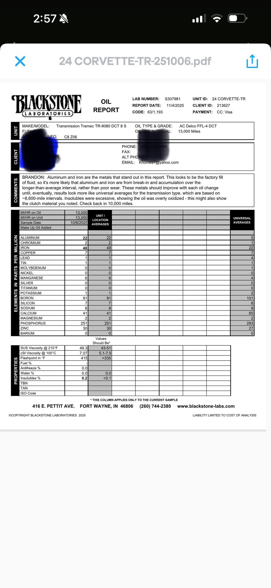

are you quoting the right person? I have never had a conversation with Josh Holder . Where is the oil analysis you are talking about. I will post mine. Have you had your valve body out of your car ? I have. Have you changed it ? I have. Have you fixed a valve body failure yourself and done both the clutch relearn and tcm relearn procedure on your car yourself with no help aside from a eBay service manual? I have. I’m just curious what qualifies you in a way to think your opinion holds more validity over mine and why you would instantly assume the claims you are making above. Did you open my filter ? I did , did you examine my fluid ? I did. It just seems like you are either quoting the wrong person here or making assumptions about my experiences based on whatever experiences you have had thus far from your car.

well when someone tells me what my filter in my car contains or doesn’t contain I’m going to take offense. It’s presumptuous, insulting and the conversation ends right then and there. I have a valve body sitting in my garage covered in these insoluables mentioned above and shown in my oil analysis so I have a pretty good idea what caused my failure. That same failure I also fixed myself. He’s going on a tangent about the flush procedure that I’m not even talking about and has no relevance to my post or the conversation. He must be misquoting because his post doesn’t even make sense or hold relevance to my one line statement. How does a one line statement illicit a multi paragraph response trying to make points on topics not even discussed or mentioned? Meanwhile there is a flush thread directly above this which there might be relevance which leads me to believe this was post/quote was perhaps made in error.

I saw the photos showing literally a bucked load of debris in your transmission. Yet, your oil analysis shows a low number for insoluables. How does Blackstone define what they label as insoluables? What they are labeling as insoluables is more clearly defined in a particle test - which Blackstone does not offer. And I am pretty sure I know why this number is so low when clearly, there are more 'insoluables' than they indicate. What might have gone wrong? I am pretty sure I know. Oh, my qualifications? I was a fleet manager for a very large transportation entity and I have looked at thousands of oil analysis reports and the subsequent repair actions when required.

you obviously have tunnel vision. Click the picture again. I will quote “insoluables are excessive , showing the oil was overly oxidized, this might also show the clutch material you noted.”
I didn’t need an oil analysis to tell me this but it’s nice to have to confirm my suspicion .
So sorry, but I’ll believe my eyes and the company performing the analysis over some dude on the internet.
if you have questions about what is defined as an insoluble . Goto their website they have a FAQ section on it. I’m not gonna post it here because I’ve already read it 6 months ago and I’m not gonna do your research for you.
