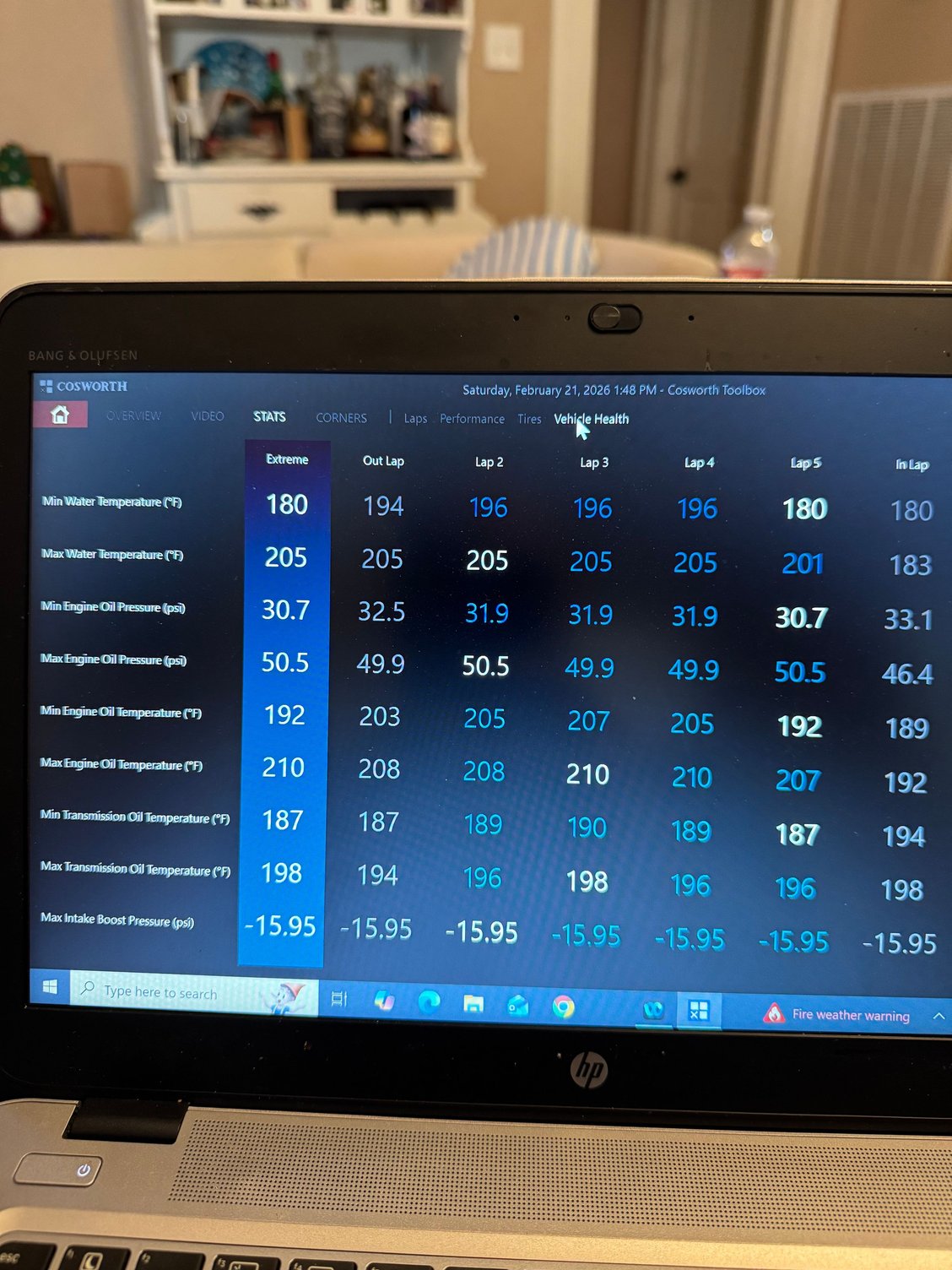

So the track was NOLA Motorsports, 84 degrees air temp, P1 tires 2020 stingray E15 fuel, heads headers, Lingenfelter ram intake. car has V09 and Z06 center radiator installed.

pretty good numbers

You got to be happy with those numbers.

Very happy with those numbers. did full 25-minute sessions.

Numbers look great. Coolant temp looks excellent, too, and should keep the engine at its highest HP map.

My highest MPH and fastest lap was the last lap, so it wasn't pulling power.

Very good numbers. I was there on Sunday the 22nd. Live in Metairie
