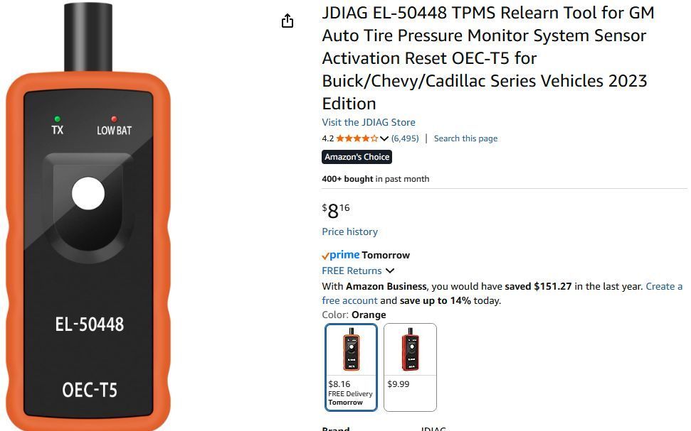

This is what I used on 23 and 25 c8, very easy and quick.

Same tool I used on my '26 as well. Works well on all C8 model years. And the least expensive "tool" one will ever find!

Post # 6... I have that exact (inexpensive) tool...used on 2023 HTC SR.... works perfect.
Go to the left side dash screen display, find tire reset, hold button for 5 seconds,
right front (drivers) blicker illuminates, hold tool to valve stem, horn beeps, go to pass. front, repeat,
go to pass. rear, blinker flashes once, repeat, go to driver rear, repeat. When
completed honks twice. Procedure from my memory
Yes, TPMS will auto learn, yet the tool sets TPMS from the "get-go".
