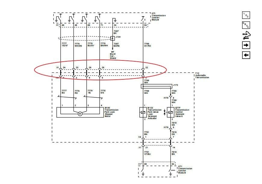

I wonder if a simulator could be inserted between the transmission plug and the harness. It could modify the position to remain in tolerance. It would have to also intecept and interpret the position commands so that it would know what the position is supposed to be. To maintain safety, it could limit the correction it would apply so that if way out of tolerance it would still trigger the necessary logic.
Attached are the schematics showing what I think are connections for the position sensors, and the connections for the position commands. Everything else could be a pass through.

Originally Posted by Andybump
A software change would sure be easy.
Spoken like an electrical engineer I assume? Awesome thoughts on this.
Alex peitz reached out to one of his tremec engineer friends and was told no current option for manipulating the stock programming of the TCM to change the ranges at this time (basically told I will need to replace the parking pawl) . I did not speak to this person so this is all third hand so specifics I do not know nor do I have verification of this information but it makes sense to me. So frustrating knowing there really probably isnt a physical issue here but merely a calibration issue due to misreading electromagnetic sensor. I really appreciate your thoughts on this and taking the time to pull up that diagram. With AI and programming now these emulators I would assume are a lot easier to do than in the past. A friend of mine works in cybersecurity and created a OBD2 dongle that automatically deletes the cat codes using an app on your phone in a couple days. Crazy times we live and also crazy that something like this can essentially brick a DCT.

Well, I figure if they can build a simulator for the muffler valves, this would be possible too. I pulled up the schematic mainly to see if the connections for sensing and control are direct connections (they are apparently) to be distinguished from a serial or digital data connection which would be harder to simulate. Serial data comms are depicted differently in the schematics.
Don't need an degree in engineering to come up with that idea. But to build it.......hmmm.
