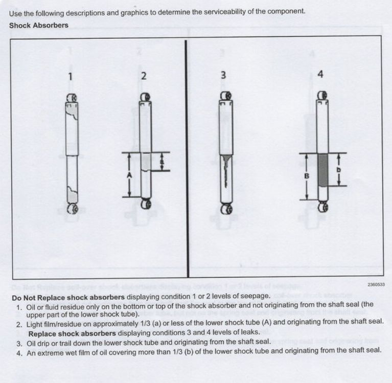

Here's the GM doc on determining an actual MagRide shock leak:

Thanks, that's great info. Looks like I'm either #2 or #4. I'd say I have a wet film but will have to determine if it covers more than 1/3.

If it's getting things behind it they should call it bad. That is more than a weep.
