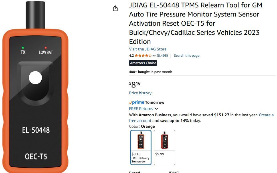

Cheap and worked great.
This is what I use. I actually have a more advanced/expensive TPMS tool that reads battery level, but it has issues working with the C8 TPMS (will trigger about 75% of the time).

that orange tool is exactly the one I bought. triggered 7 of 8. sensor shows good
i bought an autel off of amazon. if it doesnt work any better i can send it back
