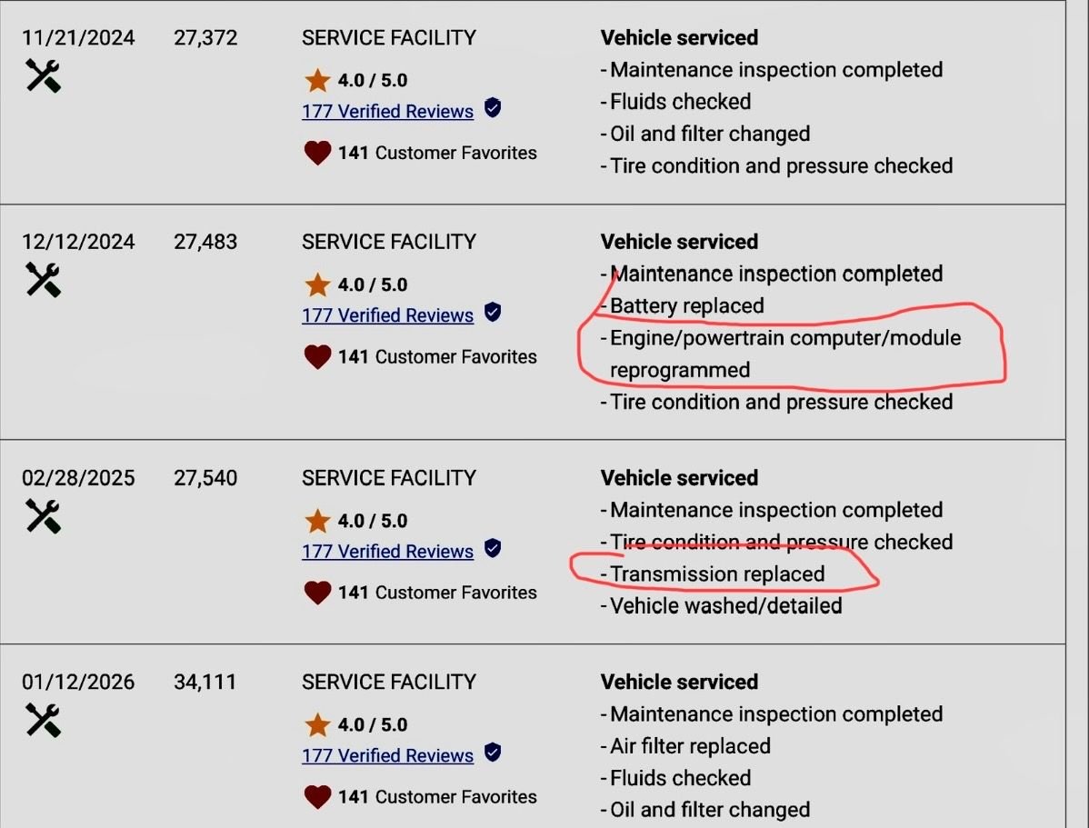

Can anyone tell me what these two circled sentences mean? Was the second one the much-discussed transmission that wasn't very good? It's a 2022 C8 R HTC. Thanks

My guess is the DCT had a problem. They tried changing the batteryand reporgramming the module which didn't fix the problem. They then replaced the transmission.
Is the car a buyback? The previous owner may have lost confidence in the car.

Thanks for your reply. The second owner had driven the C8 about 16,000 miles when the problem arose. The entry from 12/01/2026 is the last one; now the C8 is being offered for sale on 06/05/2026 with 35,953 miles. Does that mean the problem has been fixed since nothing else has been noted? I don’t think it was a buyback.

Context? Are you looking to buy this car? Keep in mind that with a replacement transmission, at 27540 miles, the maintenance schedule starts over. That means the filter needs to be changed between 7000-8000 miles since the replacement mileage, so between 34540 miles and 35540 miles, so 35953 miles it is past due for that service. So it needs a DCT external canister filter change now. And the next filter change needs to be 22,500 miles since the replacement mileage. Fluid replacement 45000 miles since replacement or 3 years since replacement whichever if first.
I don't know the answer to your question - "does that mean the problem has been fixed"

I'd assume it was fixed but you'd need to do a thorough test drive to be sure. Is the car being offered from a Chevrolet dealership as CPO (Certified Pre-Owned)? As @Andybump mentioned it is a little past due for a DCT filter change. It is past the window to get a Chevrolet Protection Plan for a reasonable price.

The transmission was replaced at 27,540 miles, which would have come with a new filter ... correct.
The filter then needs to be changed 7000 - 8000 miles later, so needs to be replaced again between 34,540 - 35,540 miles. This is becasue of the transmission break-in procedure.
After that 1st replacement, it then needs to be replaced again 15k miles later, so around 50k miles .... and then every 22,500 miles after that.

Good point. And, as noted in post 4, at 35953, this car is already past due for the "first" filter change for the new transmission.
