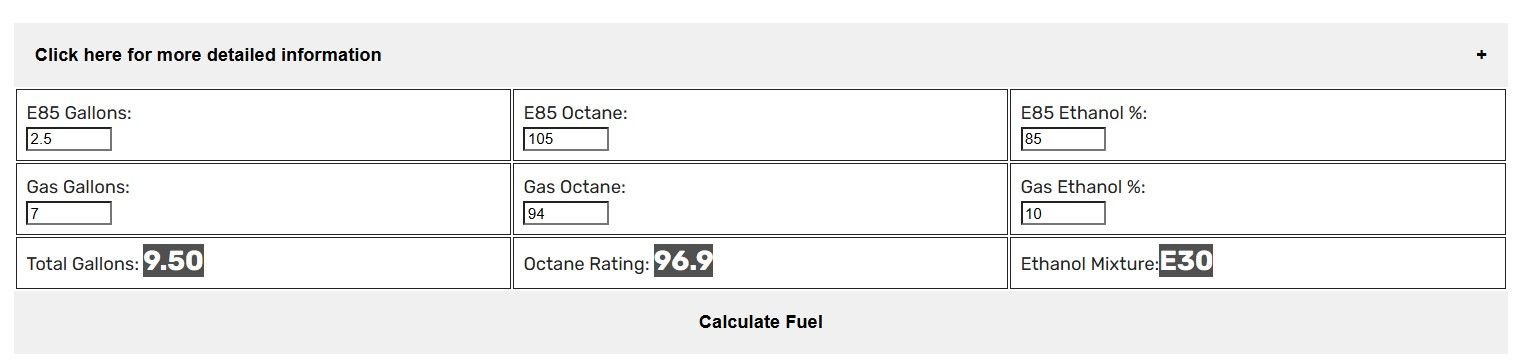

So my earlier post, 3rd time at the drag strip, I purchased some E85 race fuel and mixed up what should have been closer to E25 ratio of fuel in my car.
I added just over 2 gallons to the estimated 7 gallons of gas in the tank (app % plus gage looked accurate). I had 1/2 tank after mixing. I burnt almost 1/4 tank driving there, but got a CEL on the way (I had previously had one from my exhaust valve sticking and figured it was the same. The car went into competition mode and I launched it 5x. I also topped up with 93 octane on the way home so that should have diluted the E85 low enough.
The next day I tried to read the code and the door chime would not turn off so I pulled the negative battery cable for 10 minutes. The CEL went away. Drove the car 20 miles or so and stayed out, but came on when I started the car in the garage. The Code says P015B O2 Sensor Delayed Response - Lean to Rich (Bank 1 Sensor 1). Any experience with this? Did I damage an O2 sensor? Did I damage my car? My mechanic is pretty good and knows the mods (GM borla, Mamo throttle body and haltech hornet) I have and says they don't penalize warranty coverage for what I have done. I was hoping the issue would just clear itself.

Yeah you got too high on the Short term fuel trims. Once they hit like 25/30 percent added fuel which too much e85 will do they will trip a code. Remember your 93 octane is already 10 percent ethanol when you do the math on how much to add. Put 93 back in it , clear the code and it will probably go away.

Thank you! I’ll reset the code a put some miles on it this weekend!
I did factor in 10% ethanol in my 94 octane in Canada. Maybe it was off?

I agree with the above members. I was using the 5 to 1 ratio......5 gallons 93 octane and 1 gallon E85 mixture or 1/4 tank of 93 octane and 1 gallon E85. It worked and it made gains at the dragstrip with my bolt-ons. Just maybe it was too much E85 to the gallons you were using.
