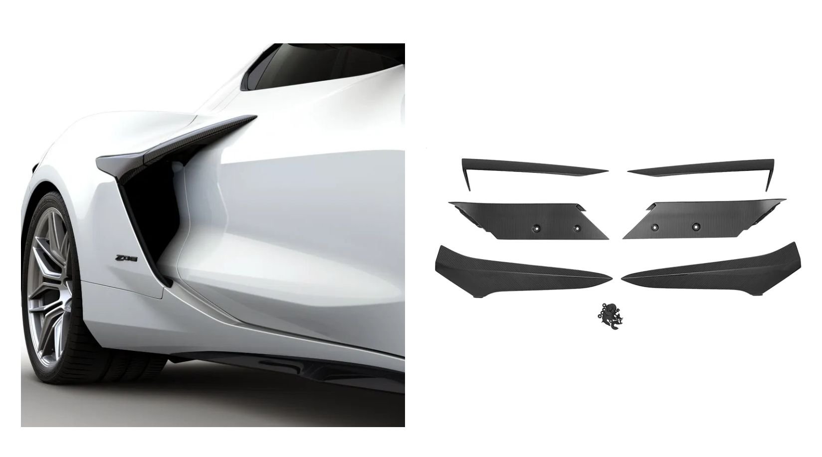

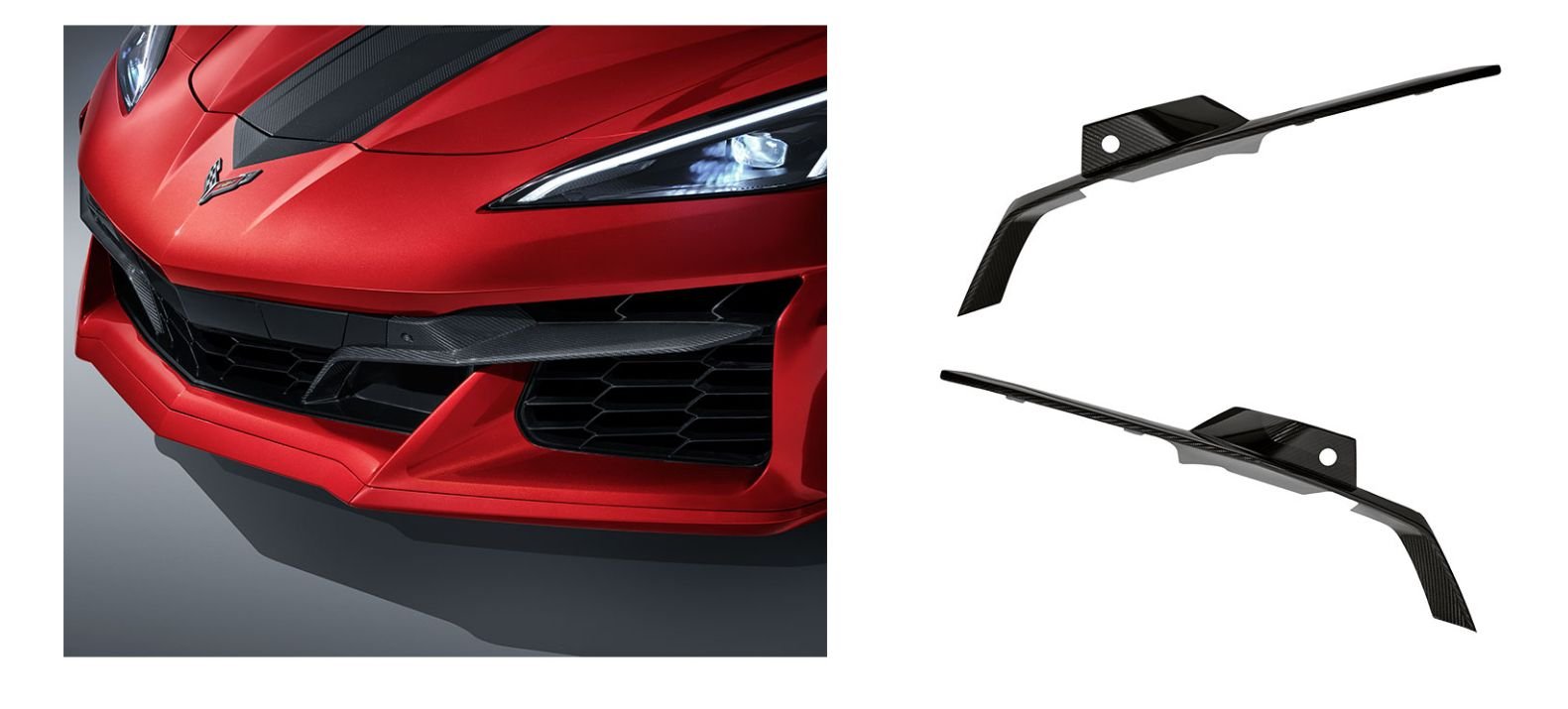

I’m interested in adding some GM aftermarket CF parts. Unfortunately I couldn’t order my car with them but they are available from the parts department.
for example the door intake trim
Or the front grille inserts

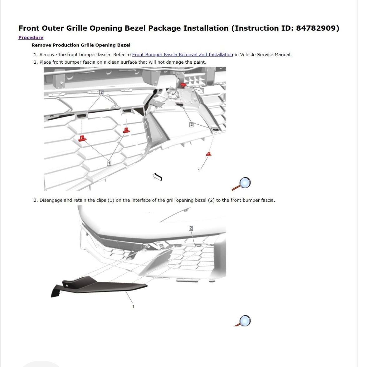

Here you go. You have to remove the front bumper, I’m actually going to do the install this weekend.

I understand you’re doing your project this weekend, and I would love to hear impressions of how it went.
From the instructions provided it looks like there may be a way to do it without removing the bumper. I’ve removed and reinstalled all the bumpers on my C8 before, so I am comfortable doing that but it’s just more time-consuming if i can get someone (maybe my wife &#128513 with small hands to work around the front end maybe the clips can come off from outside.
I also did this project on the C8 but obviously it’s different here because the pieces are bigger and they involve a camera also.
it sounds like you’re familiar with doing the project so I don’t know if this will help but I did post a video on the front bumper removal of my C8.

To install the wishbones you have to remove your door panels. The quarter panel piece pops off but the door piece is bolted on.

that’s what I was afraid of, I removed the door panels on my C6 and it wasn’t something I was looking forward to doing again. I do really want the carbon fiber wishbones though, so I guess that project is ahead of me. Maybe somebody’s put a video online….

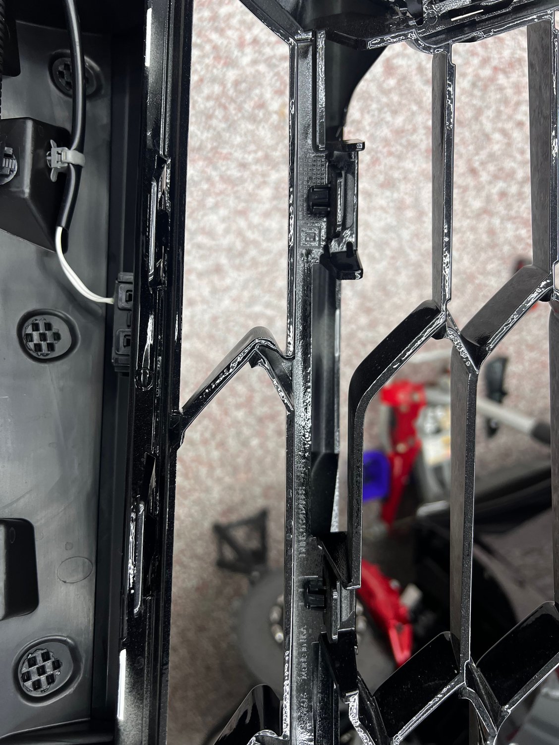

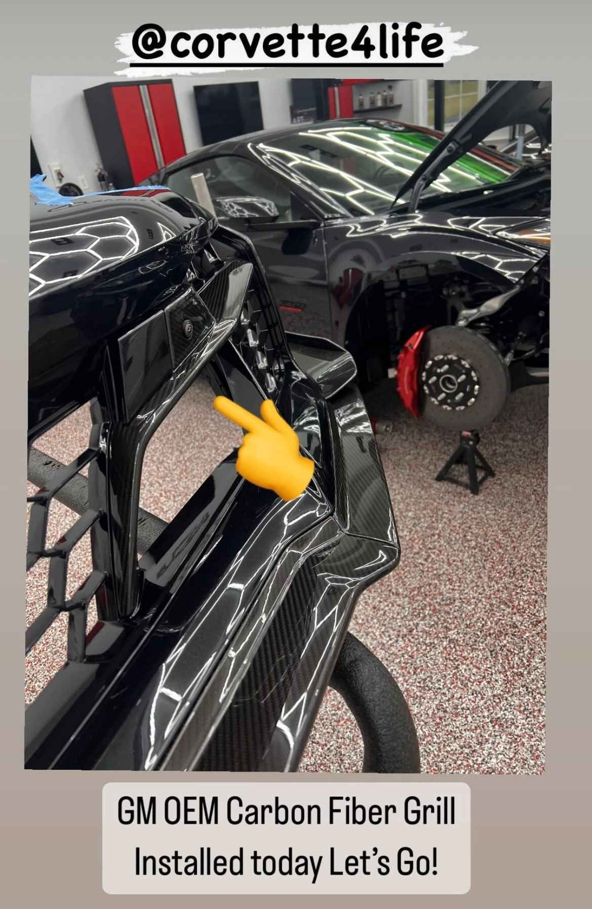

Definitely you need take the bumper off unless you have a tool to press the clips. Some clips pop up and some pop down. I would advise to buy spare clips if you try to do it with the bumper on.

Ok good tip, thank you!
they look good😁👍🏻
