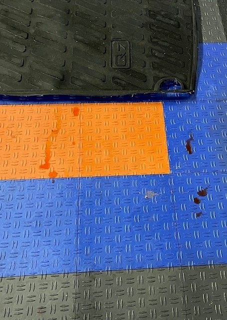

Backed the new Z06 out of the garage this morning and discovered a few small puddles of a reddish fluid under the rear end,
anybody want to guess or got thoughts ??

Typically Power Steering fluid is that color

The left looks orangish, DEX coolant maybe?

Smell it and feel it Looks like Dex cool to me. Use a white paper towel to verify the color.

Looks like coolant... taste it if you're old school. DCT fluid is golden. These cars don't have any power steering fluid (it's electric).

Looks like a coolant leak. I had this happen. Was a coolant line. Took 1 week to get the part and fix it. Was a quick fix.
