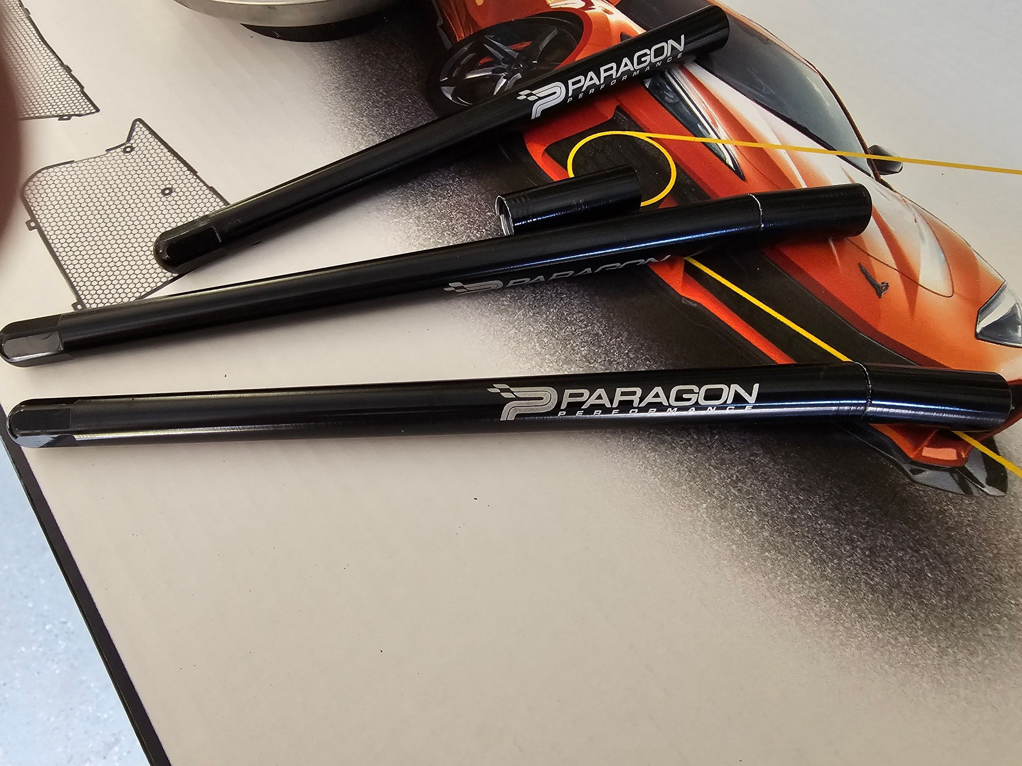

I borrowed a set of the Paragon extenders from a friend and ended up snapping all three. My mistake was having the car higher up than it should have been. Fortunately the wheel was away from the rotor when the extenders snapped. I think the trick to using the aluminum extenders is to have the tire barely off of the surface you're working on. I now have the ACS extenders and they work just fine. I replaced my friend's extenders with the ACS units as well.
Two cracked and one snapped clean.
Total junk. The one I broke happened after the wheel was all the way off. I went to move it out of the way and the edge of the tire touched an extender…snap. It was done.
CS was good though. Immediate refund.
