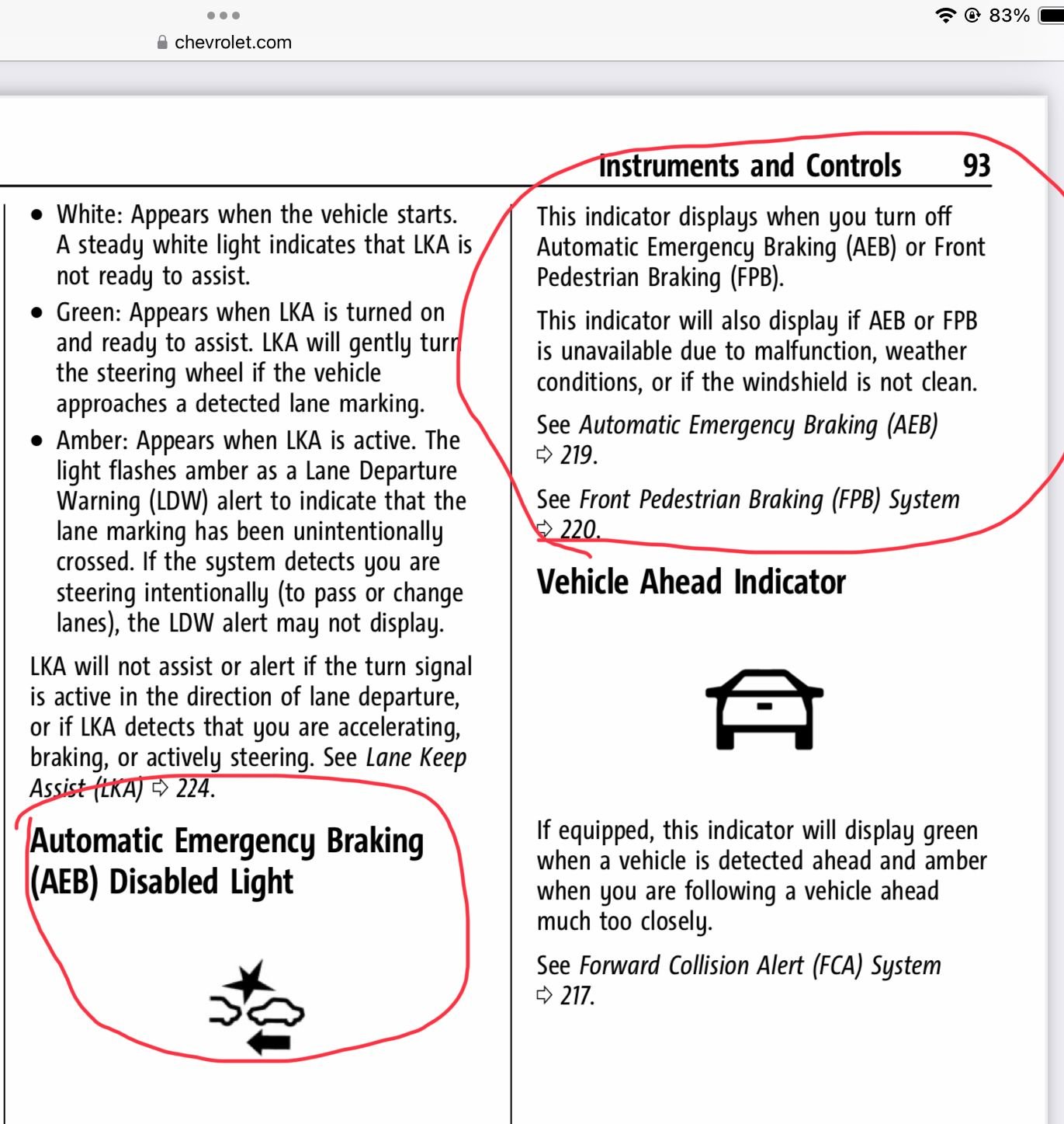

From the owners manual.
Either you turned it off by accident, malfunction, or clean your windshield.

The symbol is for Forward Collision Alert. It shouldn't be staying on. Check the manual, I believe that's an option that can be turned off.

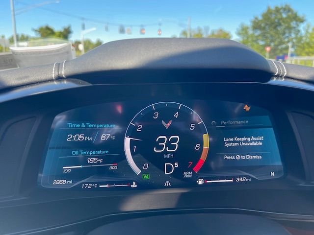

Saw this post and mine is lit as well and my Lane Keep Assist is not operable. Can I ask you how you got yours to go away? Went thru the whole 'Settings' menu and can't find where it's located (To turn off/on). Thanks!

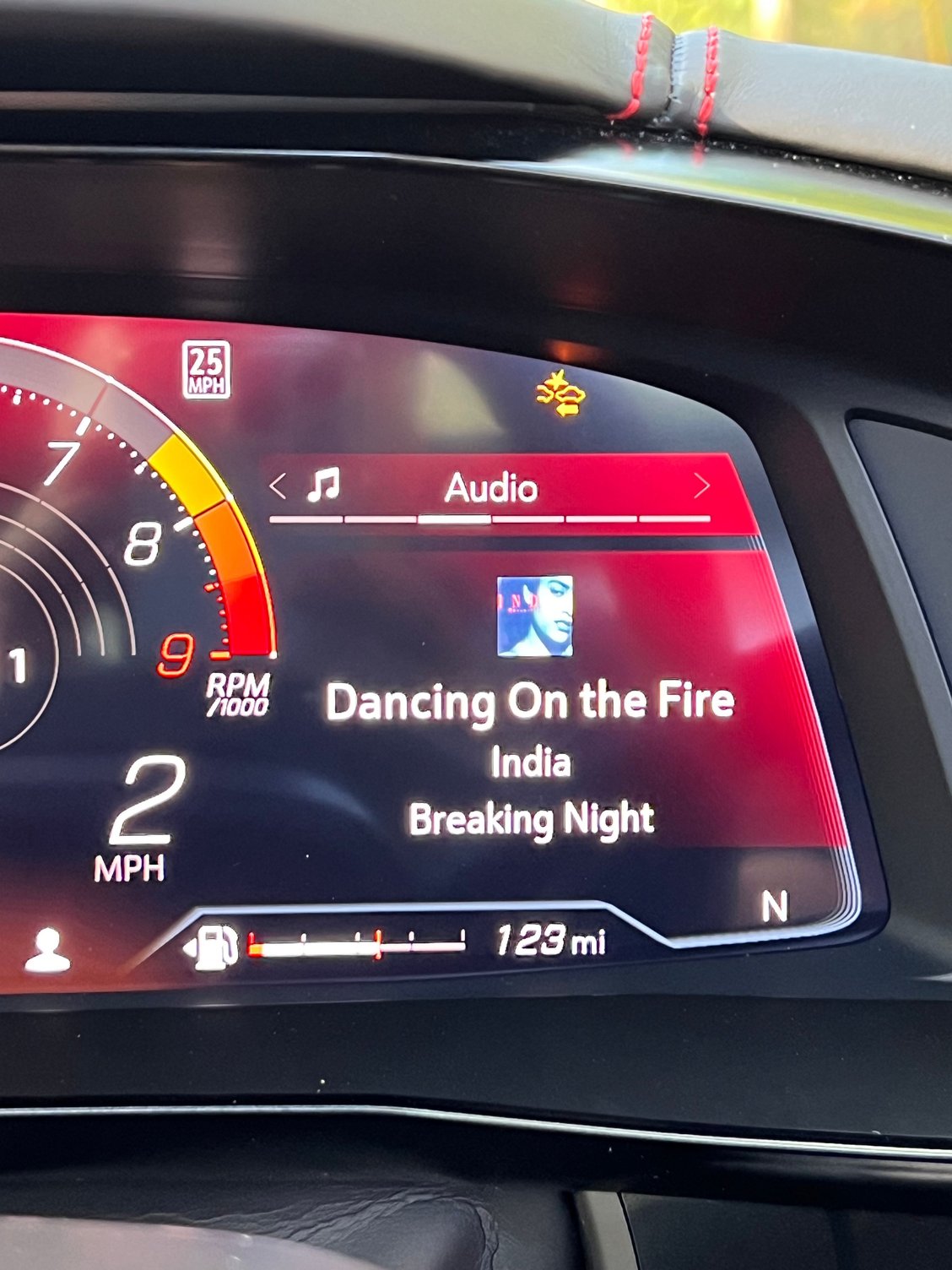

That icon stays on as I disabled that crap day 1 when I got my car
I have seen that stuff apply the breaks when it thinks you are about to wreck but are only driving hard on tristy roads with trees on the edges
F all that stuff
Both my vehicles have orange lights all over the dash, I think it is stupid that I drive brand new stuff with warning lights lit but that is how it is in this nanny world we live in.

The only way to get that icon to turn off is to set the Object and Pedestrian detection systems to include automatic braking. That light comes on if you turn them both functions off or set them to “Notify Only” which is how mine are set. Occasionally the dash screen flashes an alert because there is something ahead I haven’t corrected my course for yet. Notify only deactivates the automatic braking.
I set mine to “Notify only” because unintentional emergency braking with the seat belts auto retracting is not a pleasant experience. I have my AMG set the same way.
Lane correction has an on/off button in the overhead console.

That's the other issue I'm having. My "Lake Keep Assist" is also not functioning........
I'm thinking there is something wrong with my front camera?

I've gotten the icon a couple of times. It is normally caused by the windshield having something obscuring the camera at the top of the window. A dirty windshield, condensation or dew on the windshield can cause it.
