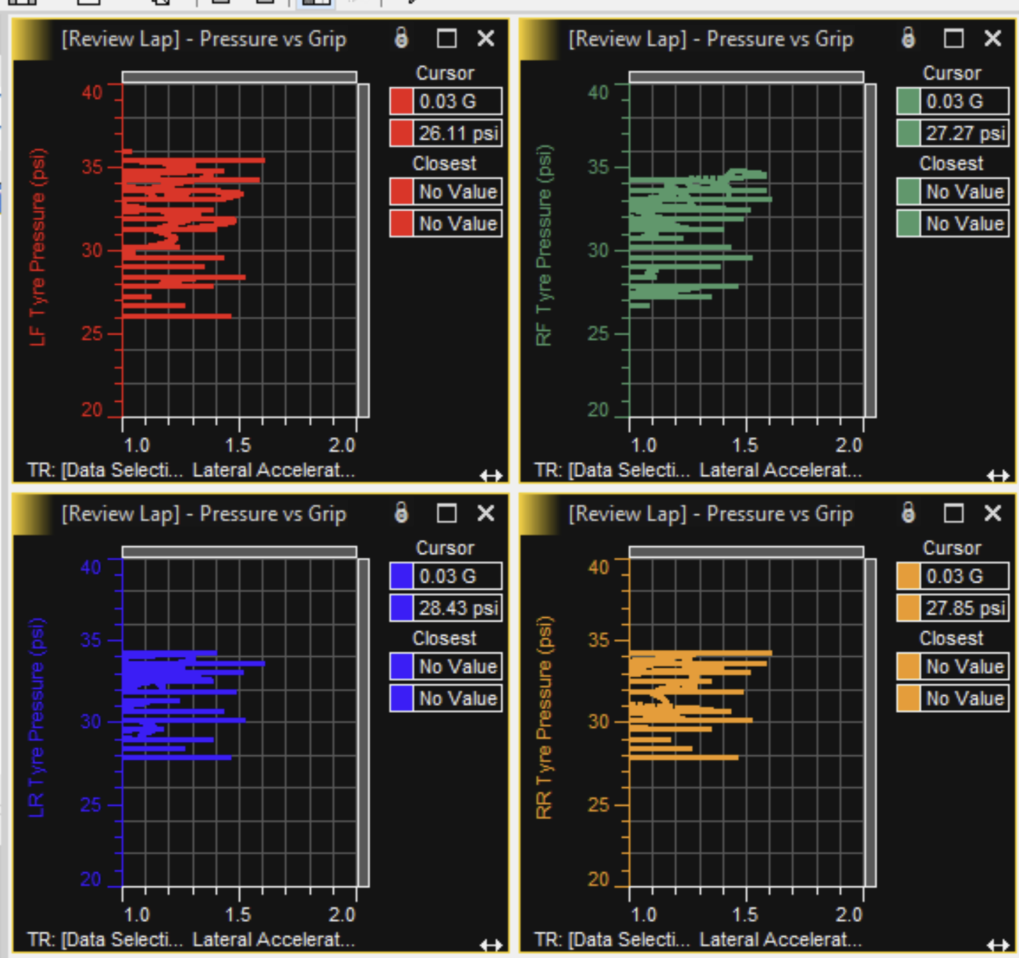

To -2.5 not enough?!?
Old Jun 11, 2024 | 01:15 PM
Egoncool's Avatar
Egoncool
Joined: Jul 2019
Posts: 532
Likes: 517
Originally Posted by C8gofast
what tire?
Interesting data, but another explanation might be that you are driving more aggressive as the session goes on. I know that my lap times almost always trend down as a session progresses, and my last lap is often my quickest. The other factor is that traffic usually thins out over time, so the opportunity of a free lap increases. Of course this is a function of where you start at the start. To confirm ideal pressure as the key variable, you would need to show a decrease in traction above a certain pressure.
