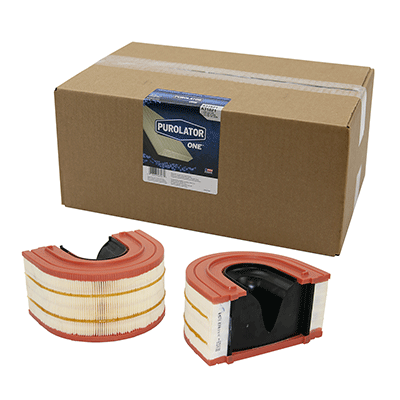

Anyone know of an aftermarket air filter for the ZO6?
Just looking to possibly change out filter only, but can’t find anything at all. Nothing on K&N or Big Blue🤷🏼‍♂️

Leave the filter alone.
GM has a whole floor of a building packed with eggheads who do nothing but figure out what the best air filter for your car is. They DID NOT leave power on the table due to picking a "restrictive" filter.
Remember, these are the same guys who set a target of 850hp for the ZR1. They then blew past that so far that they had to buy new dynamometers. There is no chance they left even 5hp behind on your car with a stupid air filter.
You will gain ZERO power and stand a better chance of a janky aftermarket part screwing something up than doing anything useful.
Over 20 years ago on LS1tech or LS1.com a whole series of same day dyno runs were done running all the various air filters on an F4 Camaro SS... K&N, stock, a bunch of others.
The winner from a power standpoint was a Fram paper filter from Autozone. The actual power difference was so small that it was more likely due to variability in the dyno.
When the time comes, replace it with the stock part or similar.

The eventuri seems to make upwards of 30 whp midrange, but it's $4K and you have to cut your trunk tub. I think it looks cool, but I'm not giving GM any reason to question my warranty.

If by "Big Blue" you mean Attack Blue, then the answer is more than likely. The Z06 filter was tested a while back and did well. It is going through one more test (a very reputable company/vendor here) will be doing the testing shortly. If all goes well... the filters (its a pair) should be available e.o. Dec or beginning of Jan.

OP, there likely aren't any drop in filter replacements yet because the stock filters don't leave much on the table. Not entirely sure though. The Z06 uses two divorced filters as opposed to the single filter in the stingray. K&N, AFE, Attack Blue, they all got on the LT2 drop in filter bandwagon pretty quickly, but nothing for Z06 yet. Maybe they are in the works, but if so, I've heard nothing about them coming soon.

Incase anyone is still interested, Attack Blue Z06 Prototype filters shipped out to be tested Yesterday. There should be word back in by the end of the month.
If all goes good and its a go, we will have these available in March.
That date will move up if there are design changes that need to be done. I'm feeling good about what I seen so far.

I can almost guarantee there is hp in the filter. Paper filters by nature are quite restrictive. Manufacturers use them because they are inexpensive and very good at filtering.
LT6 is NOT a 495 hp LT2. Filter requirements aren't going to be the same.
Porsche supplies an oiled cotton BMC filter as OEM on the GT3RS, while a paper filter on the similar engine of the standard GT3. The idea being that the GT3RS is more likely to be tracked where there is a definite difference in pressure drop at high rpm compared to the standard paper filter.
I just don't get people making blanket statements without doing research. The fact is manufacturers have to meet a price point while also meeting durability, filtering ability and noise targets. Not saying there is huge power to be had, but I'd be surprised if nothing was gained with a high flow drop in or intake system.

Circling back for those still interested (or future inquiries) with a link to the attack blue filter that should ha e released 3 days ago
