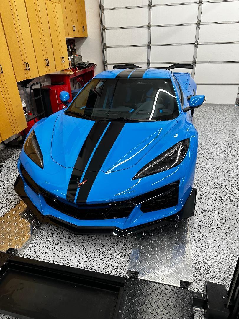

Its close with my lift the car is pretty wide.

When I bought my Direct Lift 10 years ago I had to widen the ramps to accommodate my C7 Z, later my C8Z51, and eventually Eray. I mentioned it in a past post and some folks thought it might be a bad idea since the manufacturer did not recommend product mods. At least in my case it has worked out fine. I recently added a bit of angle iron to edges of ramps to further support rear tires which bear majority of weight back there. Tires barely touch angle iron, On the Direct Lift it is easy to move one ramp wider since control cables all run on one side and other ramp is just bolted in place. Outside to outside edge measurement is now 78” and add 2” per side at rear where angle iron resides. Just sharing to show how car fits with ramps thus modified. Not saying you should necessarily do it!
