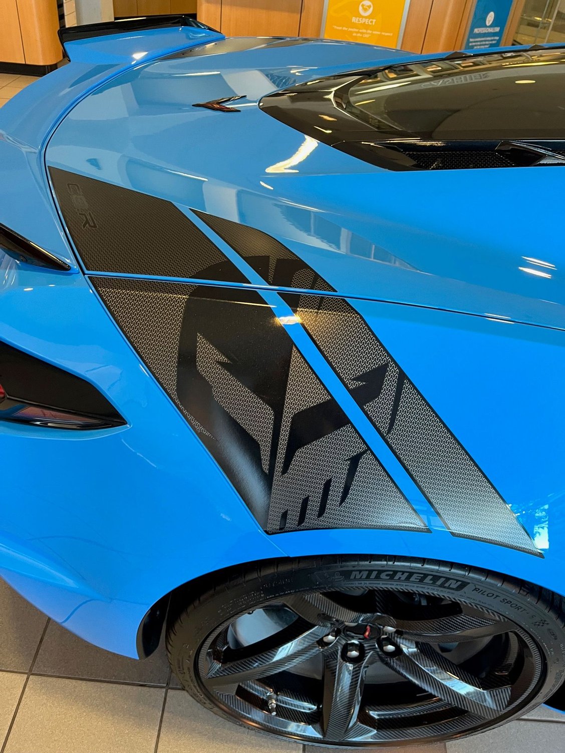

I stopped by one of the local Chevy Dealerships today and they had a new Z06 on the floor. The rear decal does not look correct. The outer edges line up but the Jake Skull seems off. The sales person didn't seem to think there was an issue. Wonder what happened to the decal....????

Not a decal issue, but an installer issue. Those decals are installed at the dealership.

Looks like it's printed wrong to me. Then again I see the problem, they were supposed to run the decal into the trunk gap, they didn't.
It is an install issue.

Thats exactly what they did. Really bad install. They are susuposed to run in the trunk gap and align. They did not follow directions and will need to redo if the new owner catches it. Here is proper installation from other forum members

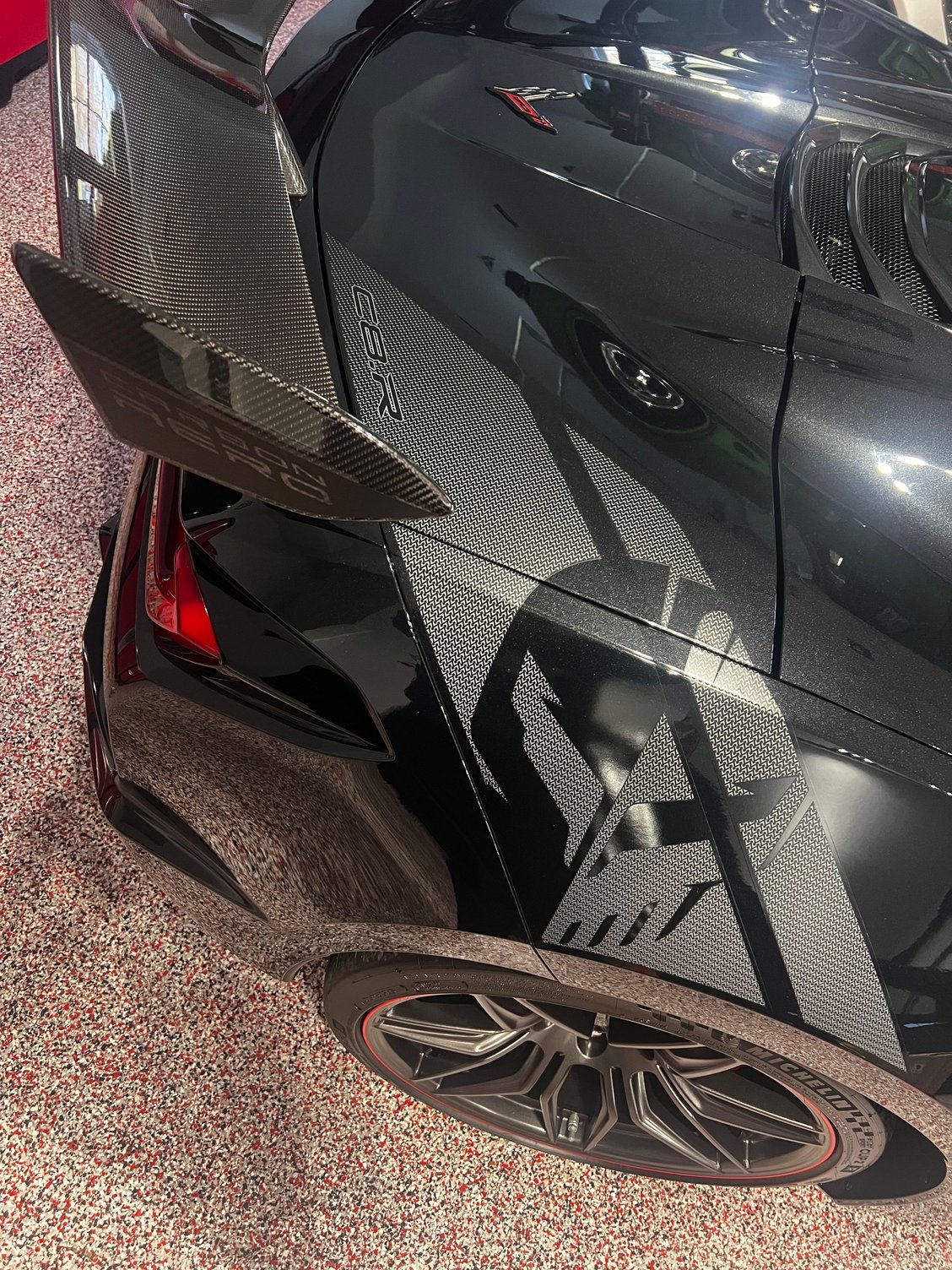

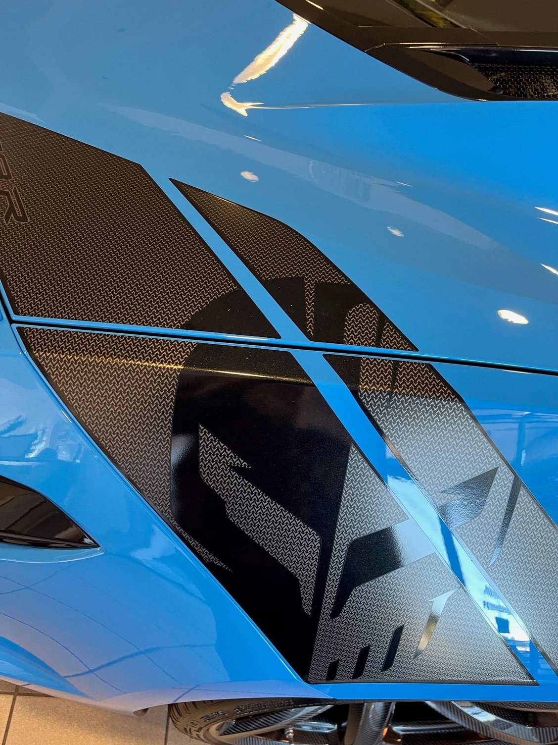

Both Decal installations is incorrect. The decals are supposed to wrap inside the trunk on both sides of the trunk lid and the rear quarter panel. Also the edge of decal is suppose to stop above the crease on the quarter panel. The one picture the decal is over the crease which is an incorrect install. There is spacing guide as well as you can see in both pictures the spacing is too wide.
Please have a dealership or someone that understands the instructions provided by GM cause this Jake kit is not cheap.

Here’s a picture of my Jake Decal
