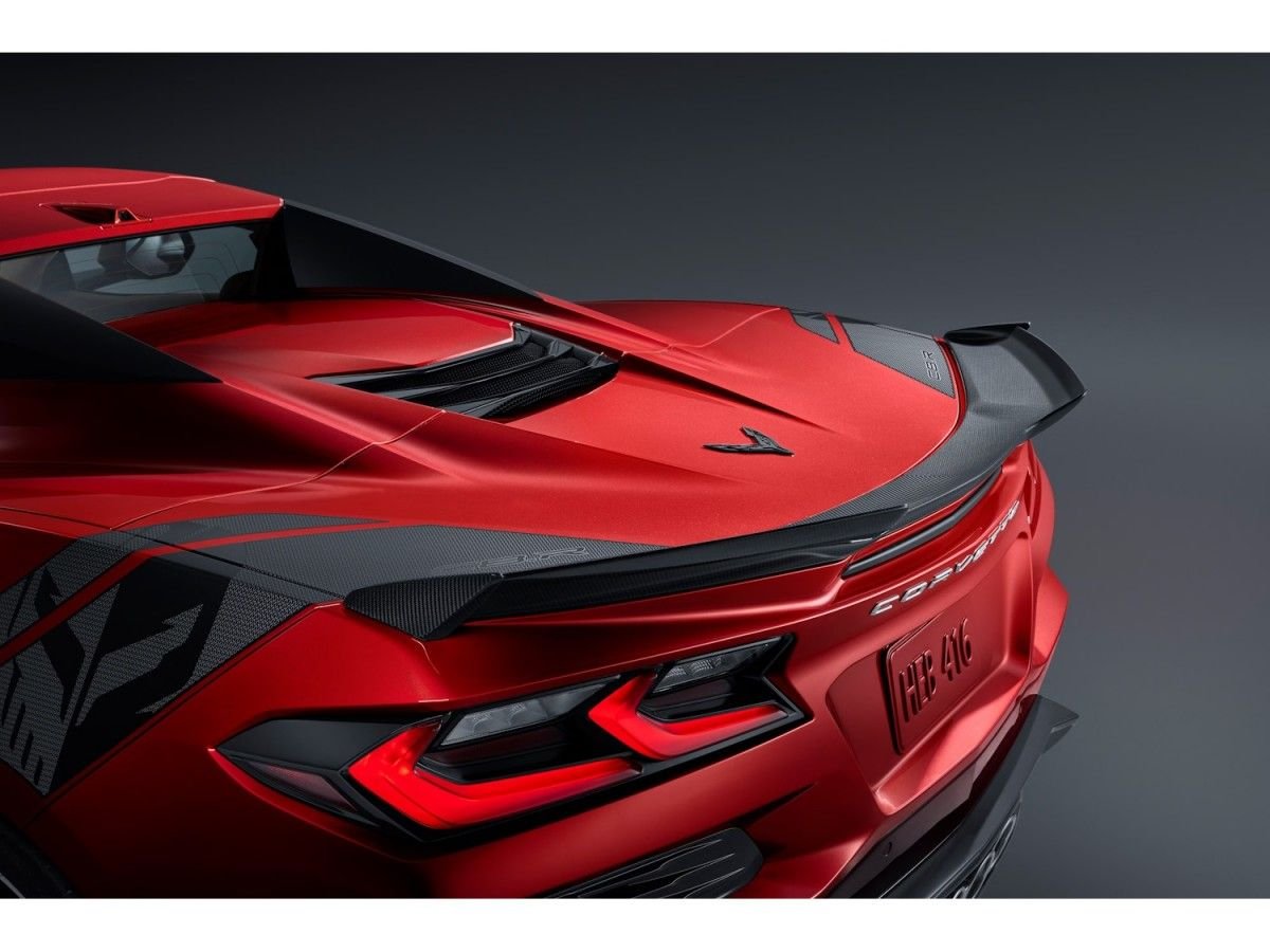

I believe this is the one we are talking about:

Originally Posted by AVETTE
GM offers a low spoiler visible carbon fiber option that uses the same mounting points as the standard spoiler. That’s what I am referring to
Yes that one should be a straight swap using all the existing holes, just may need to clean up adhesive on the bumper. I was just highlighting the video linked is for a high wing and not the same procedure as that doesnt use the existing mounting holes and also requires additional tub support brackets.

I have the OEM CF (low) spoiler and the dealer had to take the bumper off. They use same holes and can use same hardware (even though new hardware came with it). I purchased thru chevy online and paid $200 to include installation. After the dealer was done (hour or two), they handed me a bill for $1,100. I showed them my order receipt which included installation and they were left confused shaking their heads.
