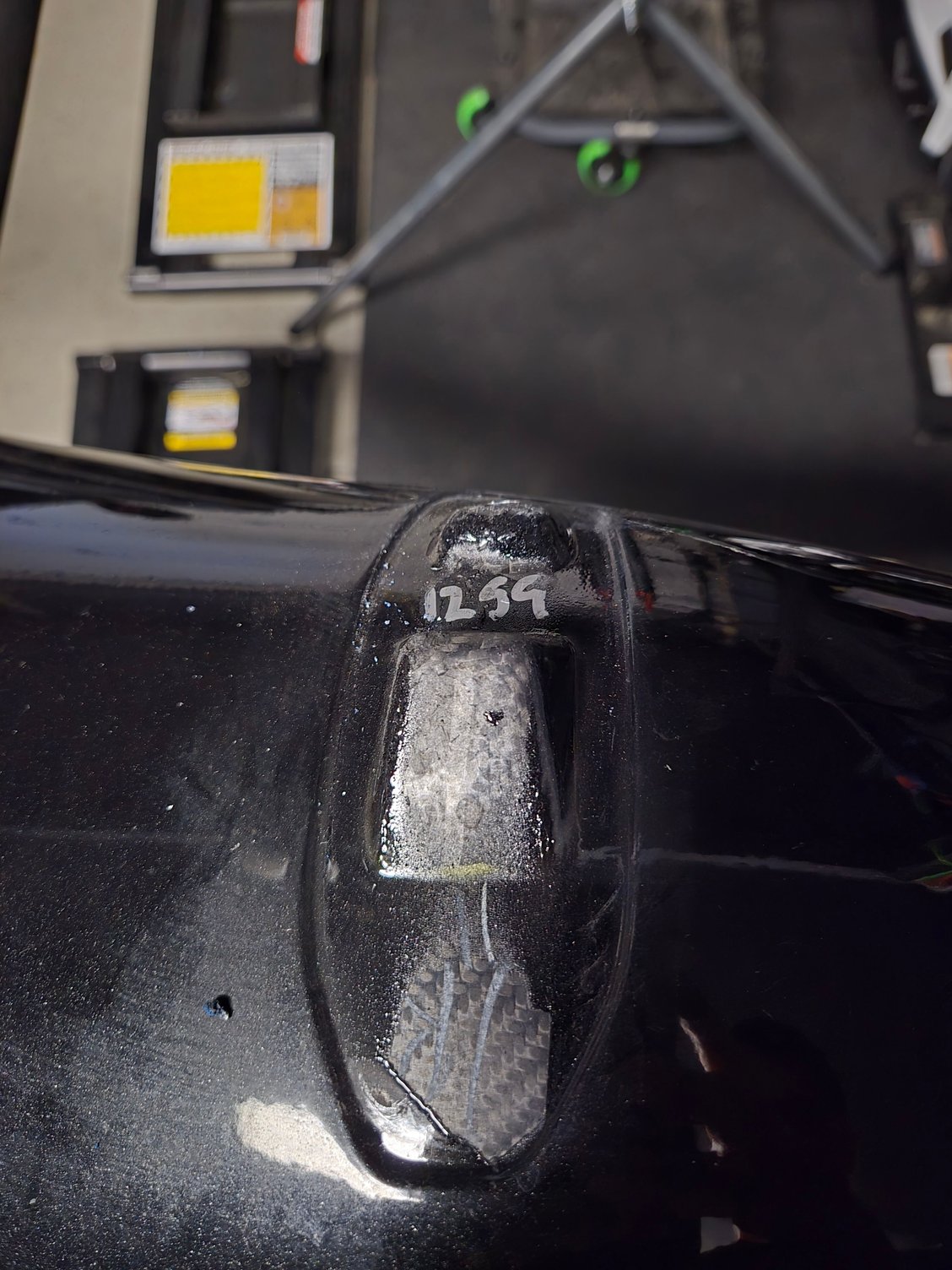

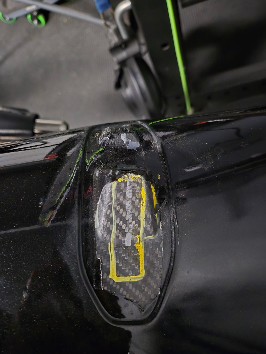

I just got done with this install and it wasn't difficult at all. I had more difficulties putting together my cheapo Harbor Freight bumper stand than this.
Once the wing is off and the bolts are out, apply some heat to the working area with a heat gun. With some strong fishing line, try and work it in between the OEM riser and the wing. The fishing line won't go past where the riser to wing bolts were. Apply more heat to the area, cover with a towel, tap it a few times with a mallet. One side took way more force than the other. The other side I barely tapped it and it came off. If your CF is painted, the paint may stick from one part to the other as it did for me (pictured). Either way, it was a pretty simple procedure.
Not sure why RSC didn't include instructions. They went through a lot of trouble with package presentation, certs and stamps that a simple write up wouldn't take much.
