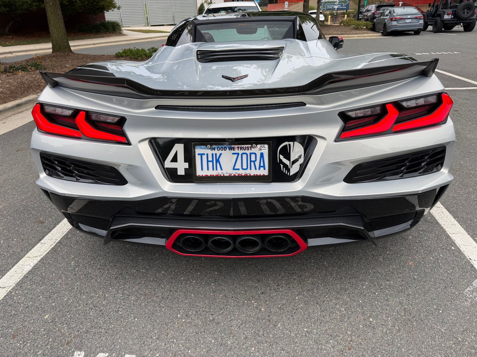

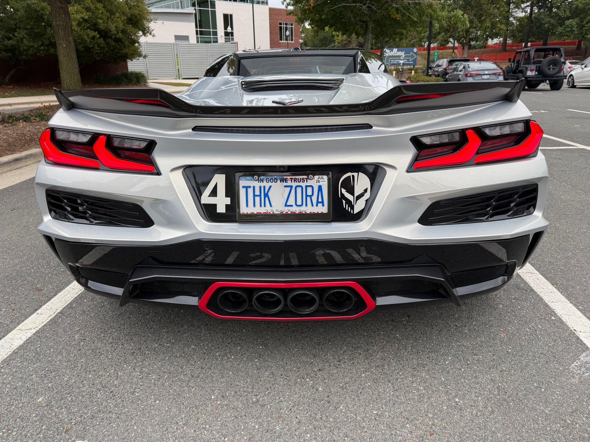

I had mine removed when my car was being detailed/PPF'd but ive done heat & fishing line before on other cars. Doesn't need to be super hot as you don't want to damage the paint but just enough to soften the adhesive on the badging. Then i've used goo gone and then a thorough wash to clean any remaining solvent off. It looks great. Heres my Z06 when it was being worked on after the badges were removed.
That looks nice!
