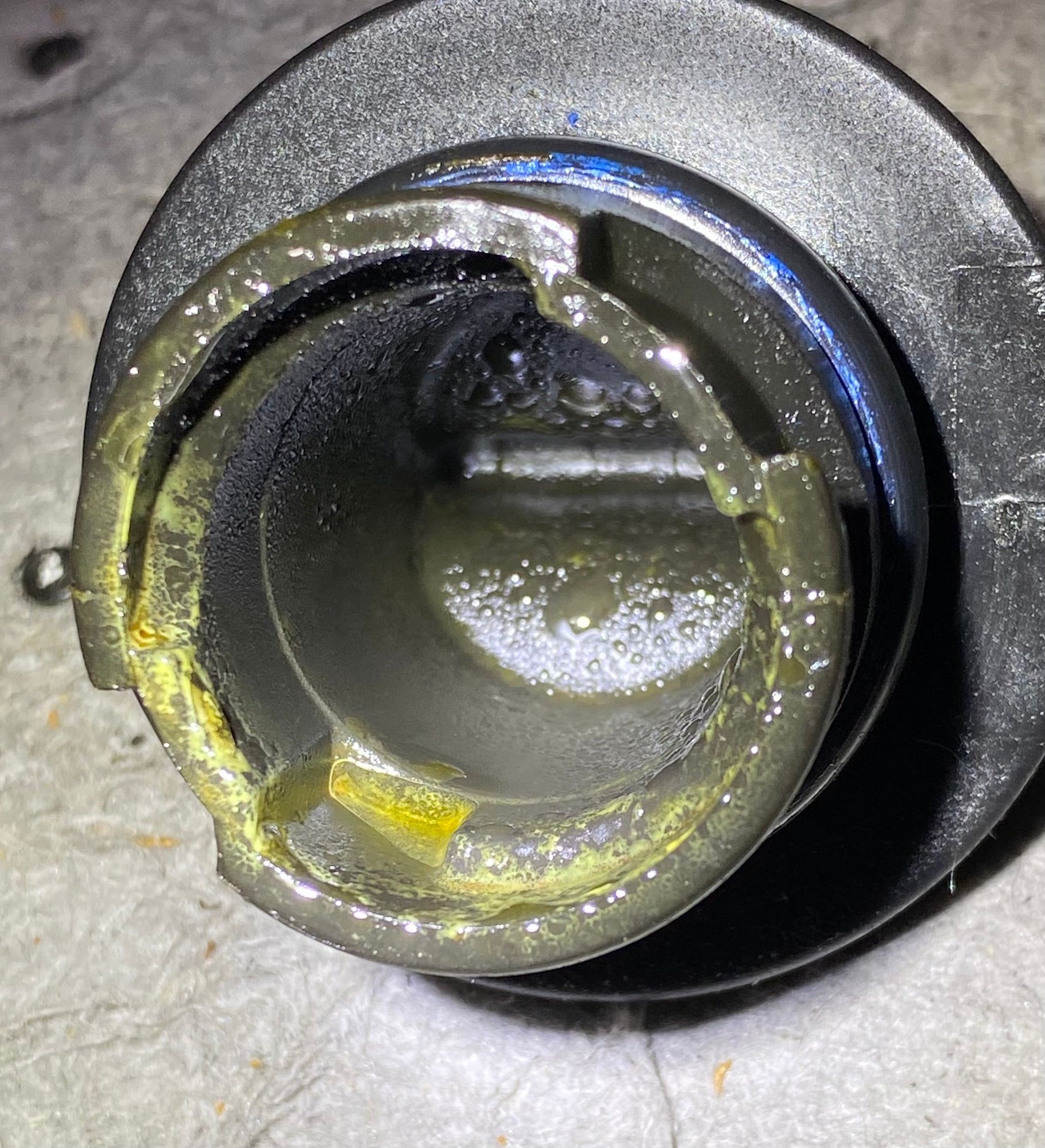

The Z06 cooling system is built more for competition use than regular street driving. In colder weather with ambient temps below 60 degrees, I block the auxiliary engine oil coolant heat exchanger with a large shop mat. This heat exchanger - located inside the driver's side air duct flows coolant that is split off from the return coolant exiting the front main radiators. This coolant is further cooled with this heat exchanger and then sent to the engine oil cooler. Also, the engine uses a 160 degree thermostat, so the engine coolant runs cooler than most other engines. Even with the aux radiator blocked, my oil temp will not go much above 150 degrees even while sustaining 100 mph.
What you should be concerned with is fuel dilution. Direct injection engines generally dilute the oil at a higher rate than port injected engines and lower oil temps aggravate this problem further. I have oil analysis results on every oil change done on my car and, in my case, I see fuel dilution at the rate of 1% for every 1000 miles - which is high. So, I do frequent oil changes as a result. You might want to send an oil sample off to a lab so you can see whats going on.
This is a copy of my latest lab report plus the trends over about 12K miles of oil changes. The last analysis was after using the latest Dexos R.
As you can see, my engine was not fully broken in until around 8K miles.
Tin in the analysis is likely from a fuel additive I use.
With regard to oil temp, below are photos of the dry sump oil fill cap I took after driving 100 miles at 80+ mph with the auxiliary cooler blocked and oil temp never exceeding 155 degrees.
