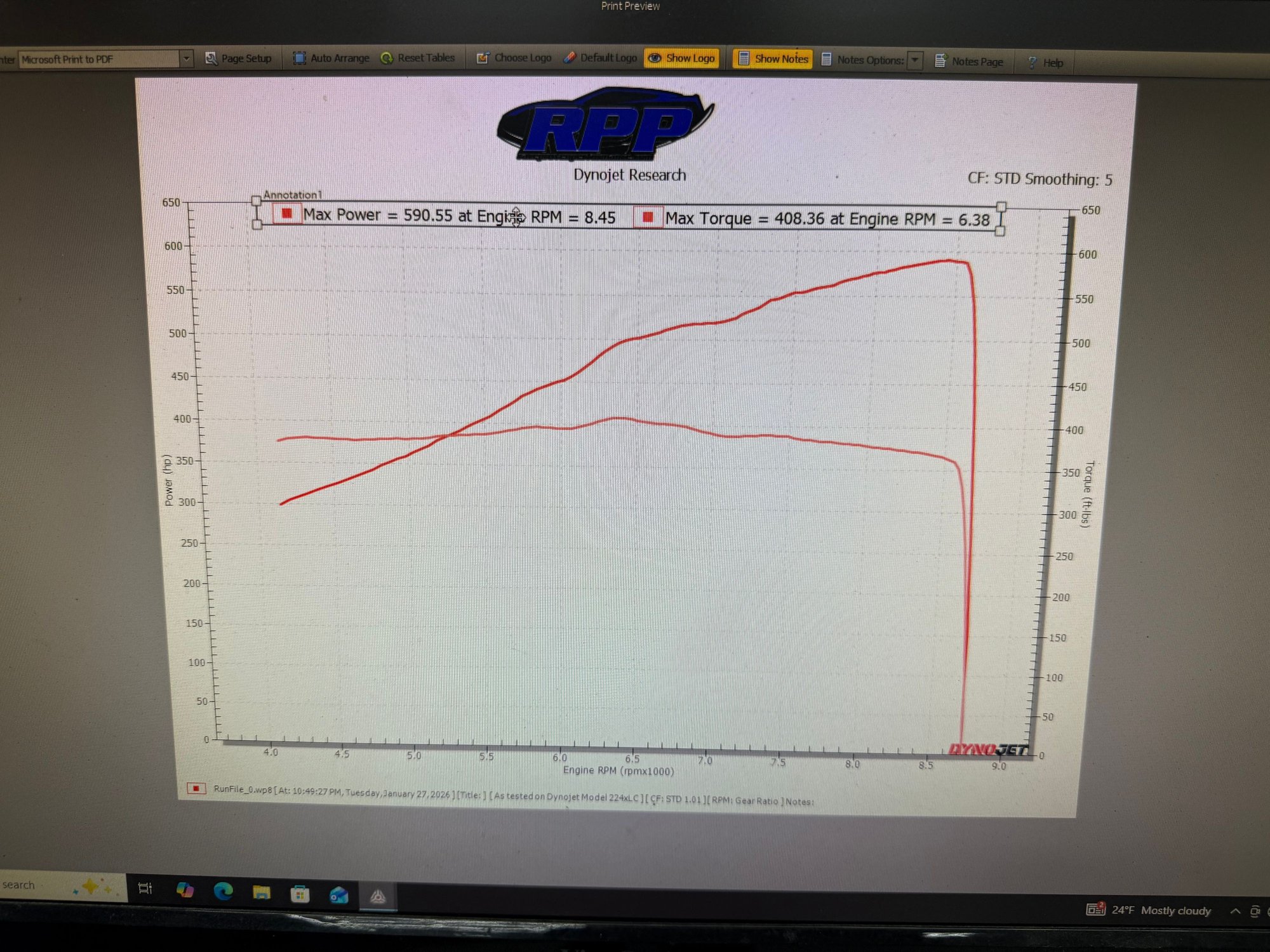

Over the next few days I’ll be installing several mods.
Here is baseline: 590/408tq

Best way to account for power from mods is to test on the same day with same dyno...
Your plot shows STD, which is typically more generous than SAE. Smoothing at 5 tends to hide things as well.
GL and I hope your investment provides the returns you had hoped for.

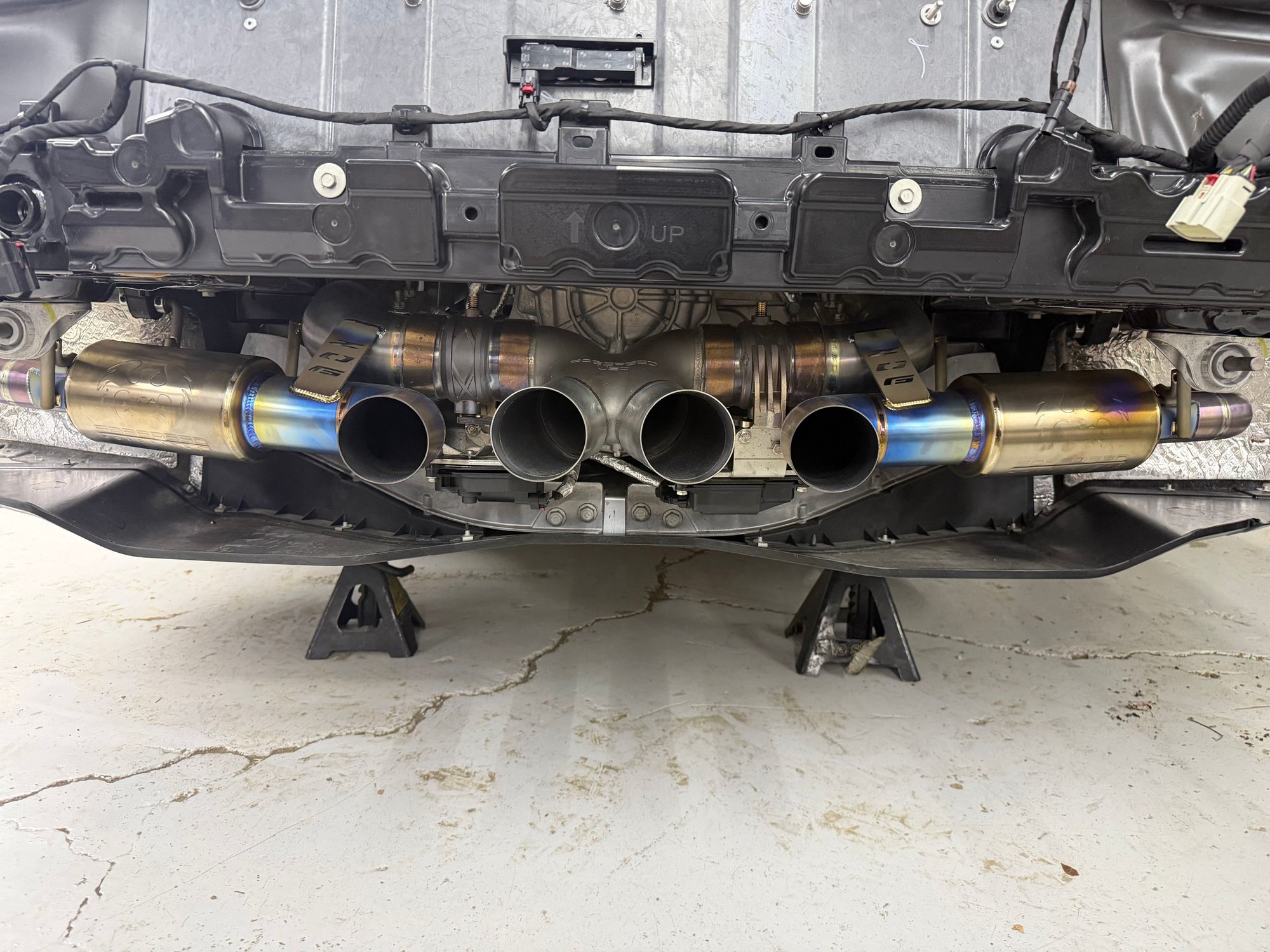

Fabspeed Ti Valved Exhaust
Soul Hi Flow Cats
Soler TB’s
Corsa Intake

Nice!
Right where it should be.

I say you end up at 615-617rwhp & 434-438rwtq
Good luck!
Yes; it will be same dyno: but don’t think the shop is going to get it all completed today.
Good luck!
I’m hoping for about 30-40 hp as well; but do think the largest gain will be midrange tq pickup

Nice mod list. Anxious to see the results. The fabspeed sounds killer but it is pricey.

Ah ok. Well awaiting to see. Everything is looking good. I see they changed the position of the transmission filter to the front. Just FYI, if you go behind that bracket on right side you can get it to its original position. I called the manufacturer and told them to update their directions on the CAI. I actually think the whole for it should be down about 1/2" as well.
Anyway. Looking goodl.
