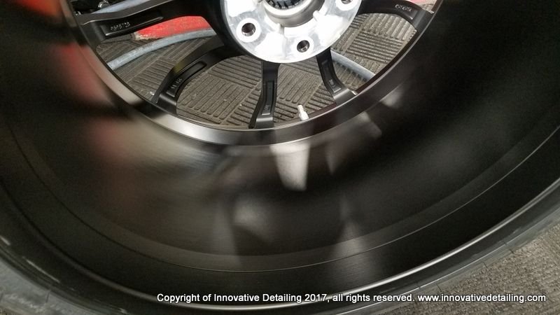

Yes if client request is for wheels off, barrels cleaned along with calipers with the option to polish both and glass coat.
Yes, investment was made for nylon sleeved sockets
Yes wheels are torqued by hand to 100lbs and my customer is advised to re torque after 100 miles.
* Always use foam ceramic rotor protector when required to avoid damage to some expensive parts.
