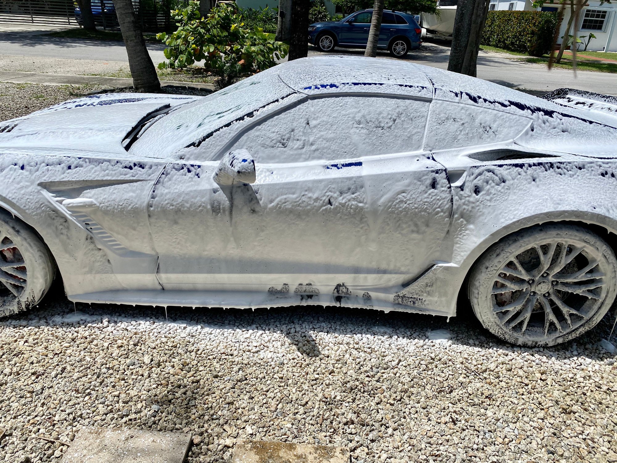

I have not used a foam cannon before. I modded mine immediately and it produces delicious amounts of slippery foam. At a minimum, it is amusing.

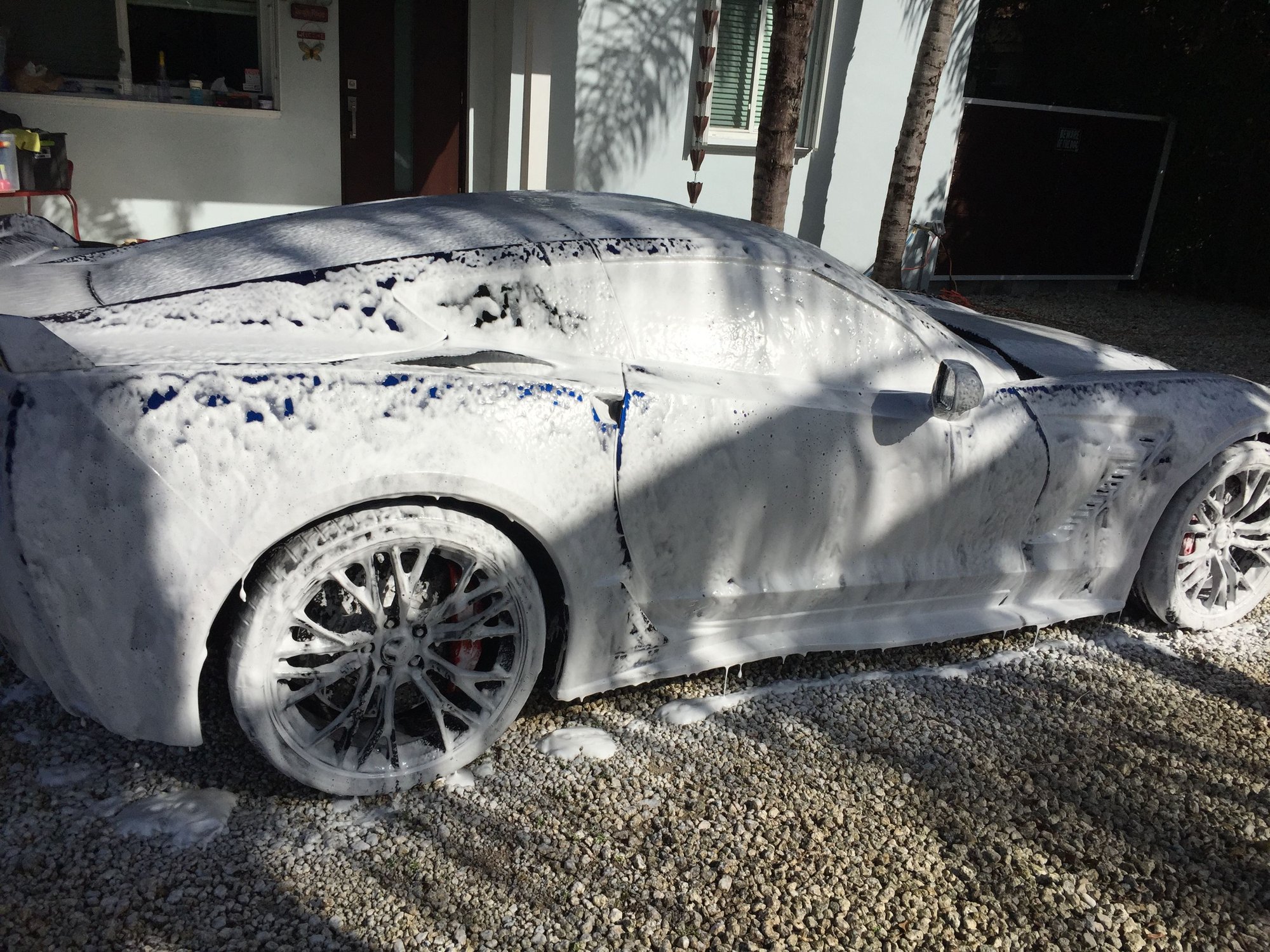

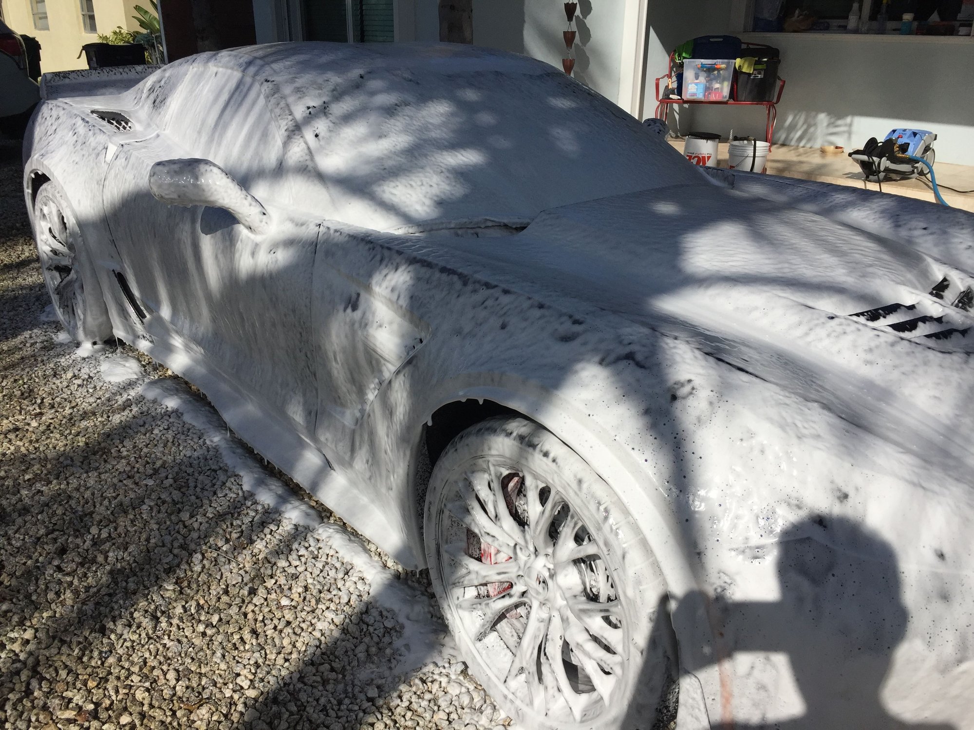

There is an Admiral Blue Z06 under there somewhere, I promise
