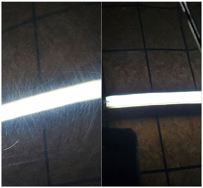

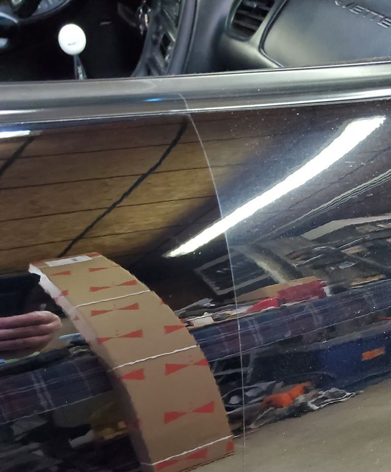

You guys already know how much I love my G9. I have been working the hell out of it since January. It may not have the 15mm or 21mm throws of the bigger machines, but that's okay. It is still a 1000W powerhouse! With a swapped 5" vented backing plate and 5.5" pads, my little G9 has managed to fix some pretty jacked-up paint. Meg's microfiber cutting disks and Meg's M100 compound work well with the G9...

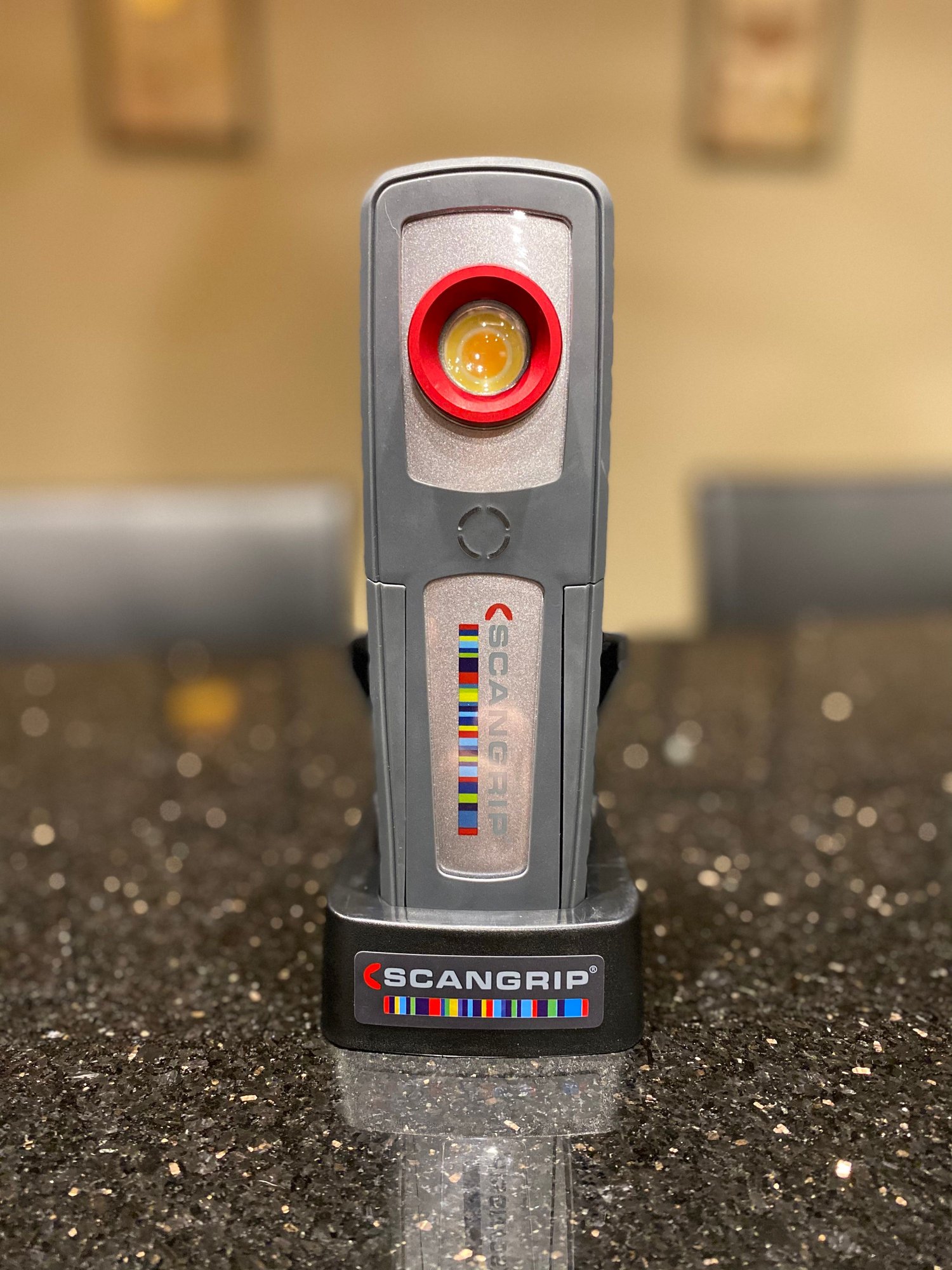

Making recommendations for buffers is a good idea, but please don't forget the other tool that goes hand it hand with a buffer...a tool you will use before, during and after you've used your buffer.
Regardless of what size or brand you acquire - you will 100% need one of these...it is like another pair of eyes that you use during every step in the process.
Scangrip Sunmatch 3. It can be a best friend or a dream smasher. Only your clear coat decides. And both your clearcoat and the inspection light never lie!
