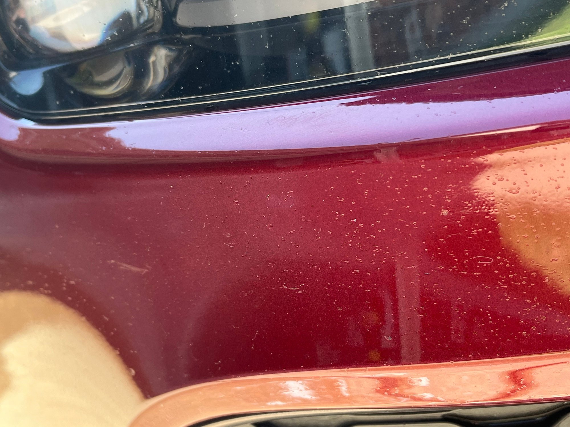

This isn’t on my Corvette but on my wife’s Grand Cherokee, but I figured there are more people here with experience with Xpel than the Jeep forum.
I washed her vehicle today and it looks like the entire front end of the vehicle has been sandblasted. Last wash was 2 weeks ago & there were maybe a handful of tiny pits from debris strikes. So unless she drove through a tornado or a sand storm that I don’t know about, this seems a bit abnormal?
Yes, I realize it did it’s job of protecting the paint, but replacing the Xpel costs just as much as re-spraying the front bumper.
Is this normal?

This is very interesting. I wonder if it was sprayed with a chemical. Hopefully someone here will have a better clue.

Just so I'm not assuming incorrectly, you feel the pitting on the surface? Can you locate any forward facing painted surfaces without PPF that are also pitted? Are the headlight lenses covered with PPF? Looks like the parking sensors are pitted. Are they covered with PPF?
I can't imagine the same exposure would not have caused lots of pitting to the windshield. How's that looking?

1. Yes you can feel the pitting in the film.

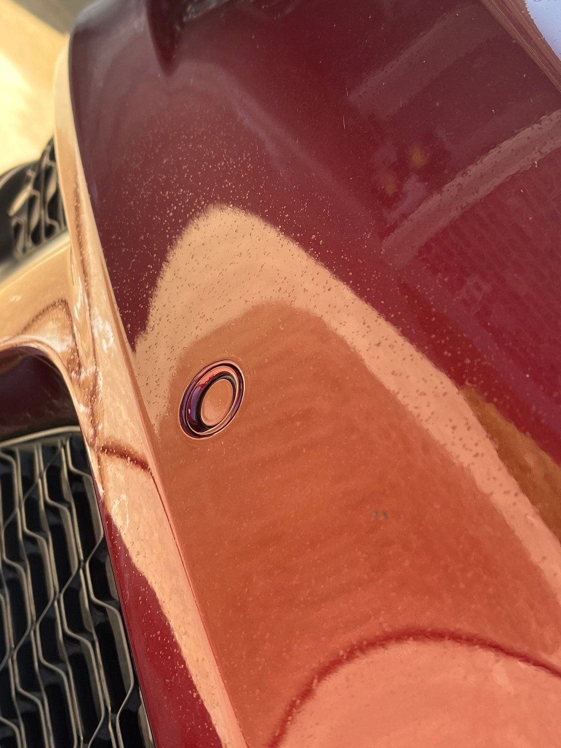

2. If you look closely the parking sensors don’t have any marks on them. There is a section of the front bumper below the lower grille that they forgot? to cover with ppf. Somehow this painted section has no pits or chips in it.
The head lights & fog lights are covered with ppf & also pitted.

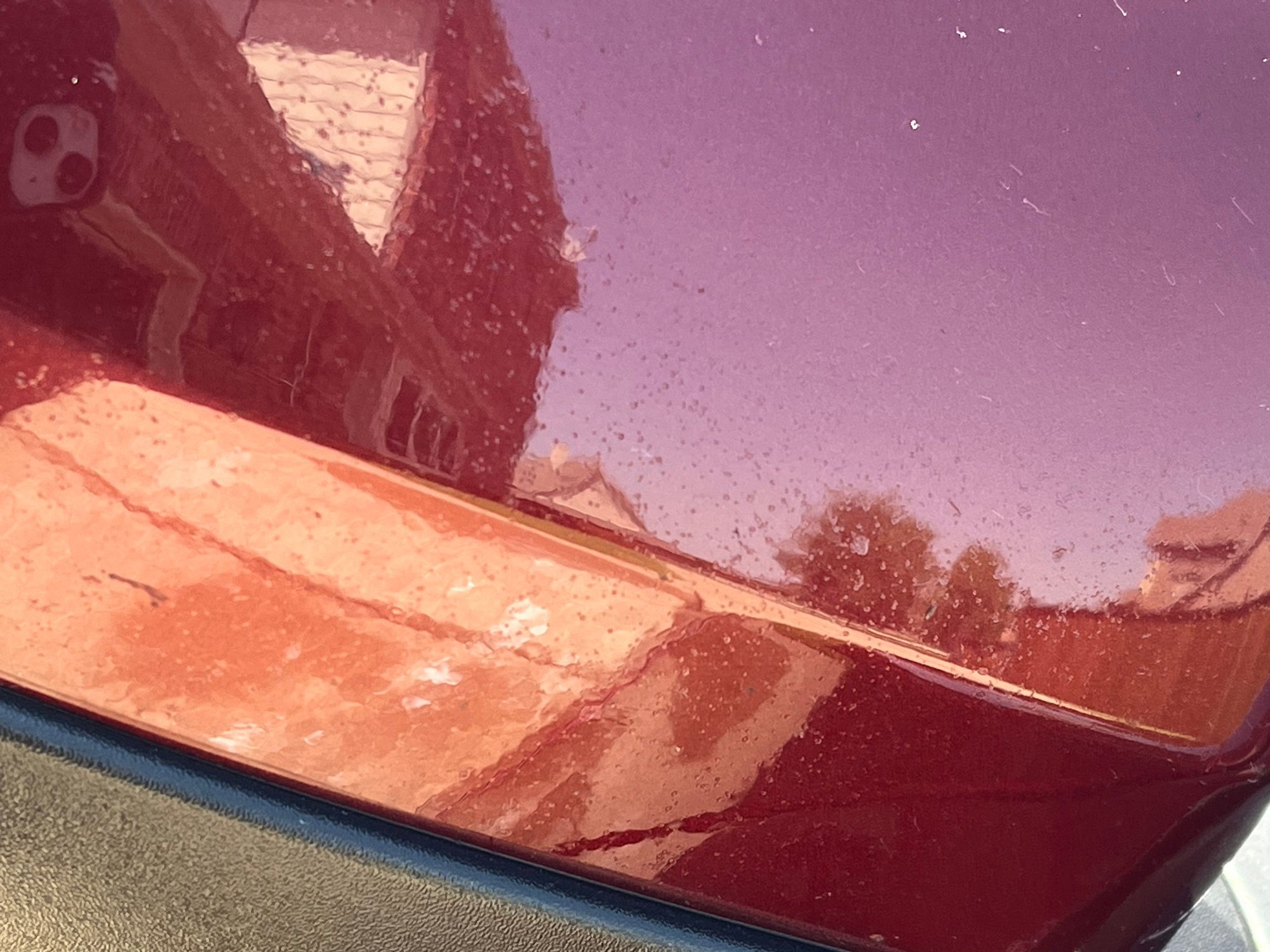

3. the leading edge of the hood also has the pits in the film, but the horizontal surface of the hood is ok. The passenger side mirrors is pitted like the front, but the driver’s side mirror appears ok (both covered in ppf).
4. Not a single mark on the windshield.
5. A-pillar and roof in front of sunroof are covered in ppf, no marks.
Like I said I can’t imagine what would’ve been driven through to cause this, and like you asked, nothing like this appears on other areas.

@JABCAT Your first photo above includes a portion of the headlight lens. Is that also PPF covered? Appears to also be pitted.
Yes, headlights, fog lights are covered with Xpel & have the pitting/blistering as well.

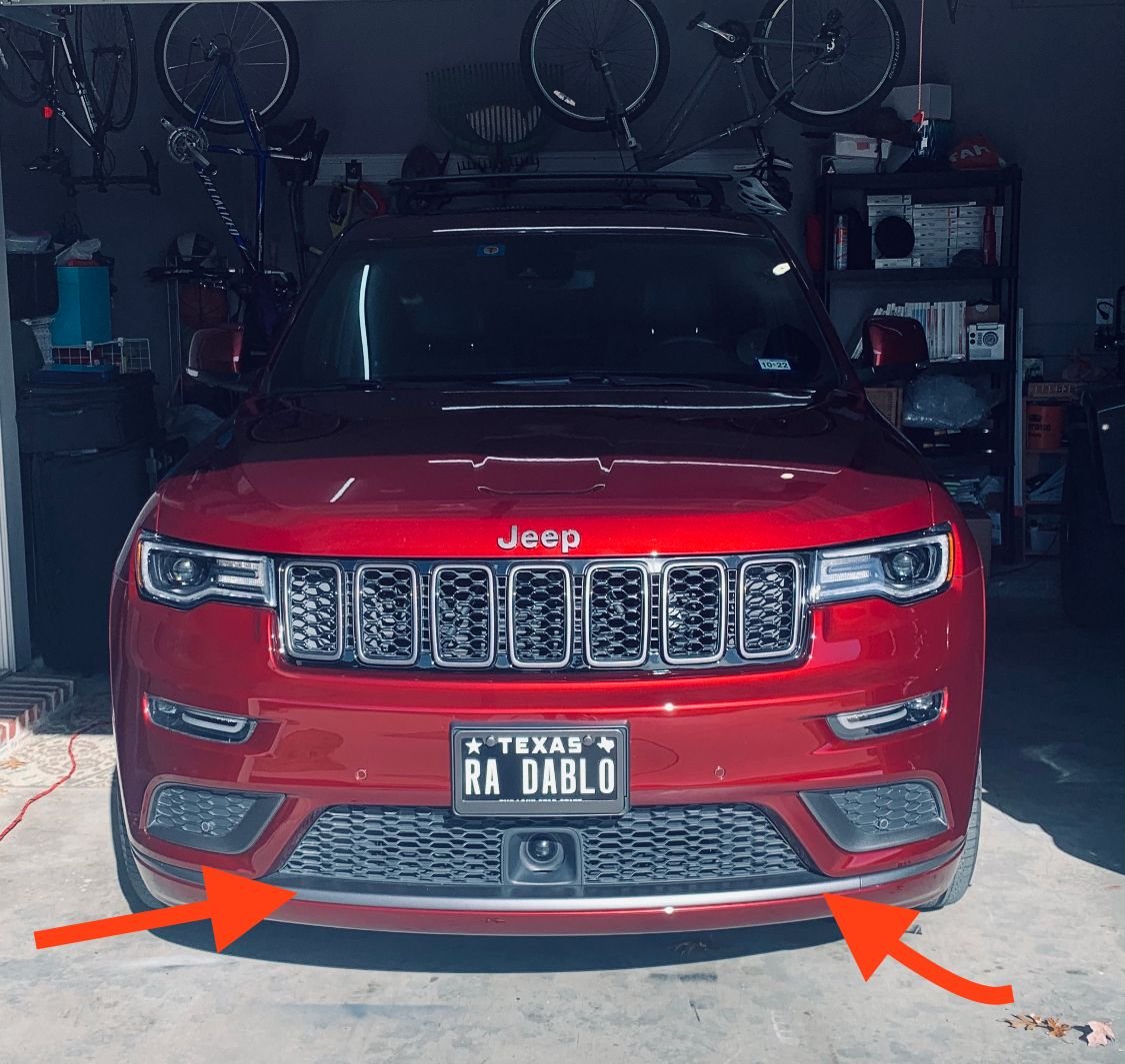

I also noticed while inspecting the front end that there is no Xpel on the gray part of the lower fascia between these arrows. The paint is in great condition on that section with no excessive chipping, but the Xpel around it has all the marks in the pics. Which again leads be to believe the marks aren’t caused to impacts.
