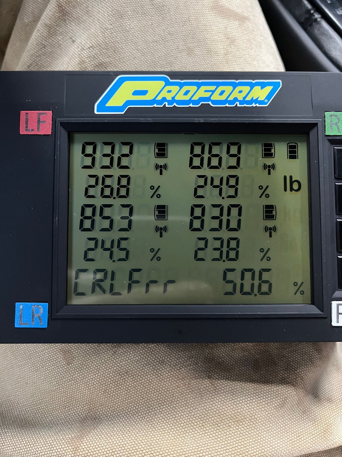

Any corner weight experts in here? Take a look at where I am with it and tell me what you would do. I know it needs weight off of LF but it’s taking weight off RR at the same time, which I don’t need. Has coilovers and weights are full of fuel with driver and sways unhooked.
