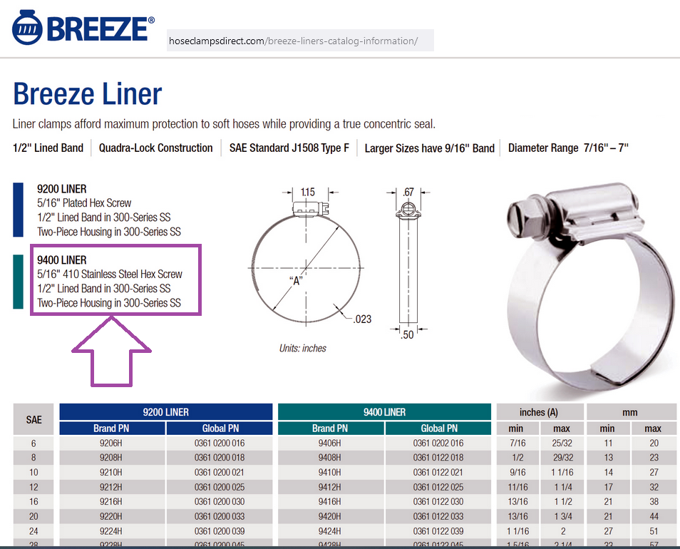

Here is an example of some selection from Breeze, I usually use breeze
There are all kinds of special clamps that might be good for this. I use the highest quality stainless clamps possible. I've wanted to try these liner style I think it would work well on the frayed ends so they dont stick through and draw blood.
