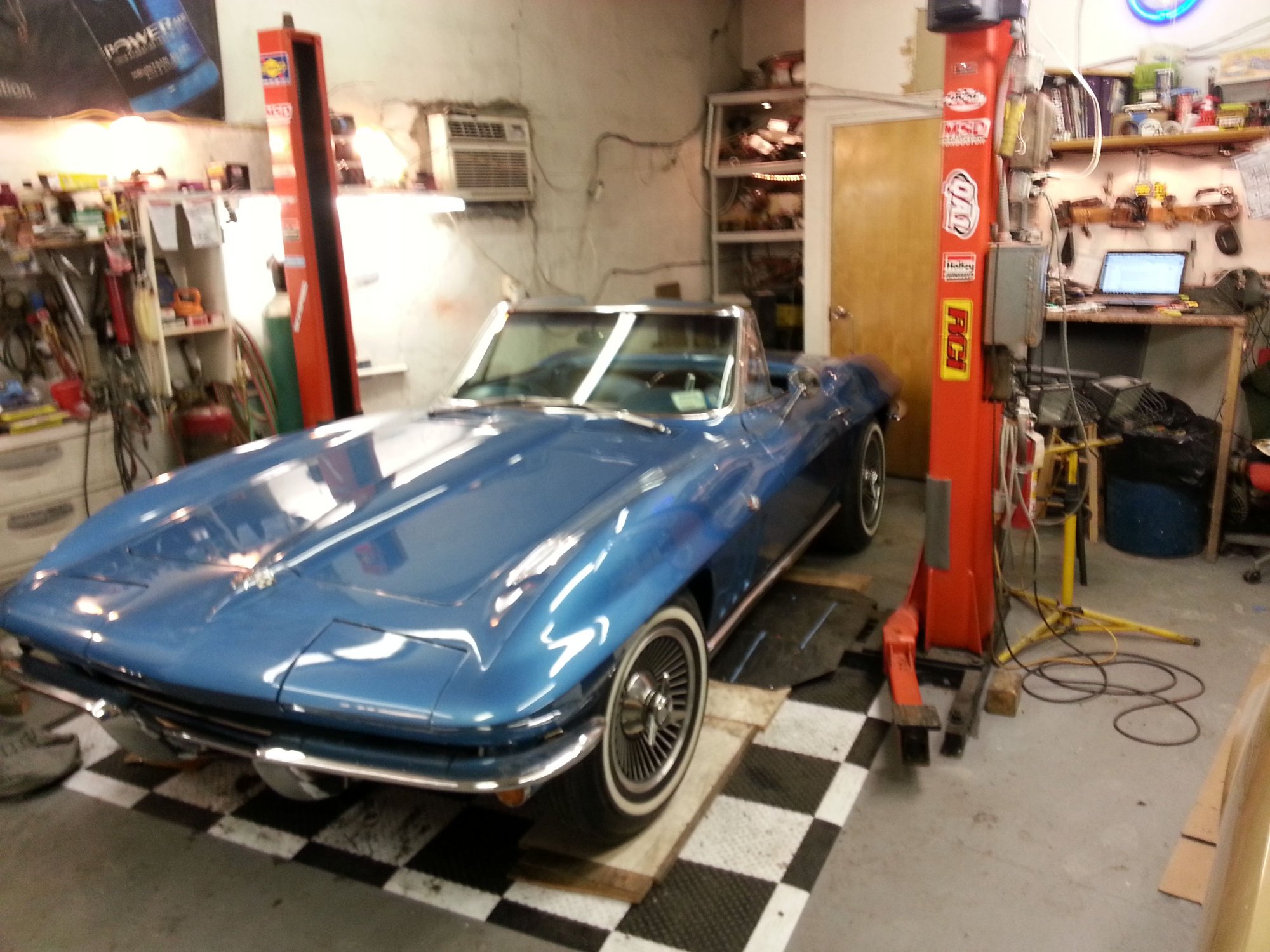

1965 Corvette, 327/300, 4 speed

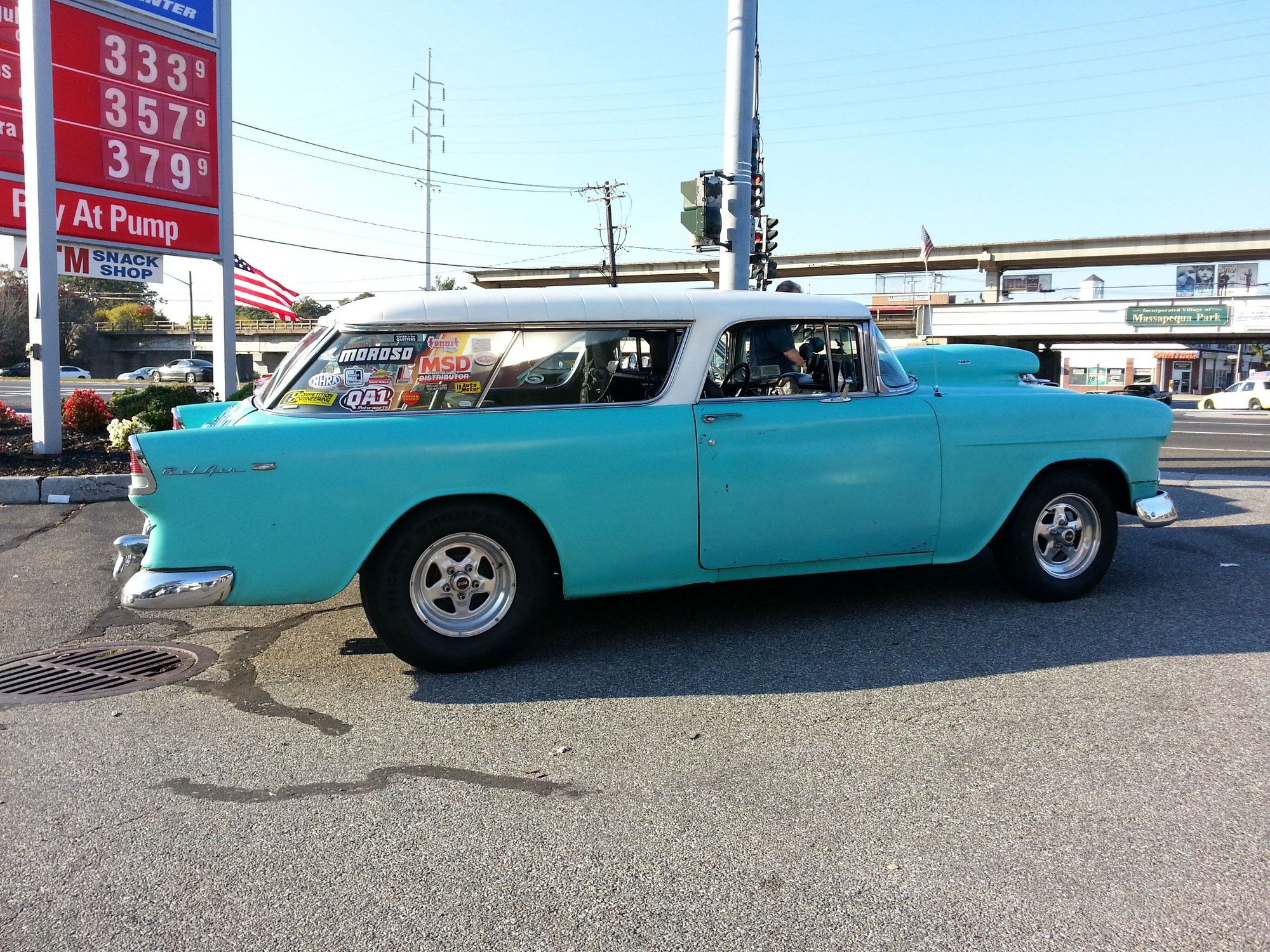

1955 Nomad, 427, 4 speed. Highly modified. 12.8:1, .580/.600, Jerico 4 speed, front&rear coil over susp. Moser 12 bolt, 33 spl. spool w/4.88. Ladder Bar rear susp. Front susp has upper and lower tubular arms w/QA1 coil overs. 1050 Dominator, gasket ported intake and heads, flowing +/- 350cc.
