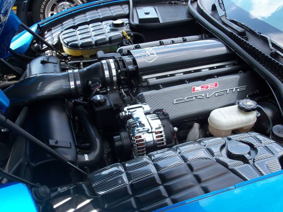

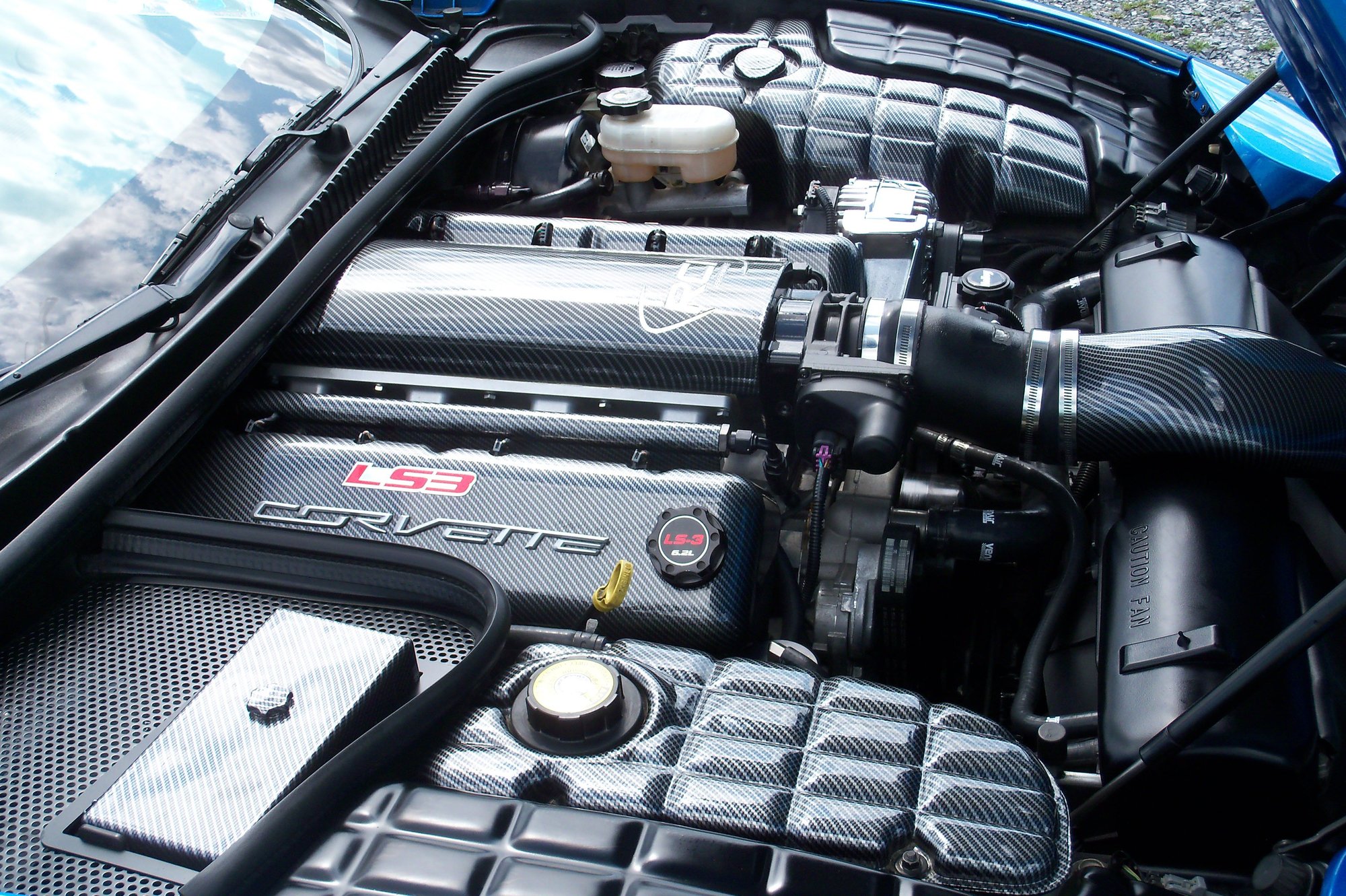

I've been down the "Engine SWAP" trail a couple time myself. My first Engine WAP was yank out my LS1 and stuff a LS6 Crate Engine in its place. Did a "Head and mild CAM" upgrade with Long Tube Headers , but still only got about 398 RWHP out of it. Then I decided I wanted a little more cubs, so out with the LS6 and in with a LS3, 6.2 Liter. Well, I went a little too far overboard with a few upgrades to this LS3, e.g., "Heads and CAM" upgrade. I was always looking for a drivable street car (not a track car) but I ended up with something more suitable for a "Circle Track"; not what I was looking for.
Yeah, you guested, I yanked that LS3 out and bought another 2010, LS3 Create Engine. You know the old saying, 3rd time a charm, LOL ! Here are the engine modifications that went into my 2nd and current LS3 Create Engine that installed in my Vette now.
1. GM, 2010, LS3, 6.2 Liter Create Engine. a. Dyno Power: @ RWHP: 512 RWHP (After Engine Upgrades ~ see below).
b. Max Torque: @ 419 Foot Pounds (After Engine Upgrades ~ see below).
02. Upgrade Camshaft (CAM): Motion Hydraulic Roller Performance CAM
a. CAM Duration @ .050:,229 x 244
b. CAM Valve Lift:.615 x .595
c. CAM Lobe Separation Angle (LSA):113
03. Heads: Stock GM, LS3 Heads, Ported, Polished & CC (PPC)
04. Lifters: LS7 Lifters
05. Rockers: BTR Rockers and Trunnion Upgrade Kit.
06. Intake Manifold: Custom RCI, Aluminum, Performance Intake
07. Throttle Body ~ Stock 2010 GM, LS2, 90mm Throttle
NOTE: LS3 6.2 Liter Engines come with a :58X Crankshaft Reluctor Wheel. Not compatible with the C5 ECUs'GM Reluctor Specs:
GM #12586768
58X Reluctor wheels were primary used on 2006+ GM Vehicles.
Most 58x use a grey crankshaft sensor
This sensor is located at the back of the block, near the oil pan, on the passenger side of the engine, just above the starter.
There is a "Control Box" that you can install between the Reluctor Wheel/Gear and your ECU that will let you run the LS3 with the 58 tooth Reluctor Wheel.
Or, you can install the old 24 Tooth Reluctor Gear that comes on the LS1, but you won't get the full tuning capabilities that the 58 Tooth gear give you. Just
be aware. . . .
My Tuner Guy went a different route. . . . e.g., installed a 2010 ECU that controls the engine only. and kept the 1999 LS1 ECU that controls all of the other
car body functions, e.g. gages, lights, radio, etc., etc. Sounds crazy, but it works. Oh, you will lose the use of your DIC (located just on top of the steering
Colum). Well, that's not 100% correct. It still works, but you will be getting "error codes" forever. Your LS1 ECU is looking for the engine, but it's not connected
to the engine. I had my tuner install a "Toggle Switch" that turns of the DIC LIGHT. It's still working . . . . you just don't see all the error codes flashing on the DIC Screen.
You know the "Old Rule Of MODs" right? You change/MOD something here and it will effect something somewhere else. It's like a "Snow Ball" rolling down hill, LOL !! MODs are never simple, LOL !!
Good Luck
