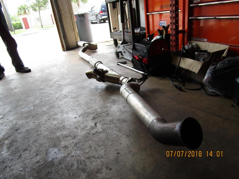

Its my favorite thing about daily driver
The point of cutout is having silent stock exhaust to drive around with all the time for comfort and smell. Then, the opposite available whenever you want it, uncomfortable and smelly and noisy.
Things to be aware of:
1. It won't make the car much if any faster unless you are forced inducted and even then there is a caveat because of low flow rate fluid momentum
2. If its too close to your ears it can damage your hearing
3. Cutouts gradually carbon-stiffen up and the gear drives get worn and they need to be routinely maintained or replaced. I always keep a spare. The cheap cutouts $35~ seem to last about 12-15,000 miles.
4. It makes using a dynometer wideband more difficult - it will read false lean no matter where you put the wideband at the tail or cutout.
The main advantage is for turbocharging where a massive drop in exhaust gas backpressure can yield substantial torque onset and top end power output.
Heres a video of me driving around a bit with open cutout you can see how easy to rip the tires loose, the turbo becomes more like a switch.
E.g. you can control the rising rate of torque from the turbocharger via exhaust gas pressure controls.
