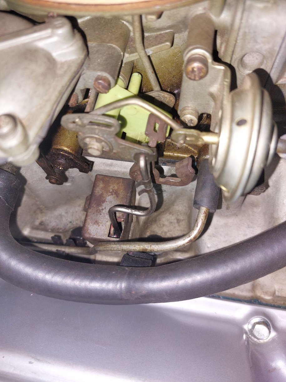

I am not familiar with the Holley 3418, however, it appears to have a high idle cam and vacuum dash pot pull off like the 3367 Holley on R66.
I would unhook the choke rod and wire the choke open along with wiring or weighting the cam down to prevent it from moving around due to vibration. Then warm the engine to NOT, tune it to your desired idle rpm, and test drive it to see if you still experience the change in idle. If you do, it is in the carburetor circuits, not the choke.
The choke on the 3367 on R66 is extremely difficult to get properly set since I installed the L79 intake. I also experience occasional high idle after the engine is at NOT and have to kick the throttle to get it to return to hot idle. The plastic cam is forced up to get choke high idle, but there doesn't seem to be a mechanism to pull it down to prevent vibration or friction from allowing it to sticking or bounce back up. I thought of adding a weight or spring on the cam to assist it in returning to the hot idle position - I have yet to do it as I guess I am too lazy.
Ron
Holley 3367 high idle cam configuration.
