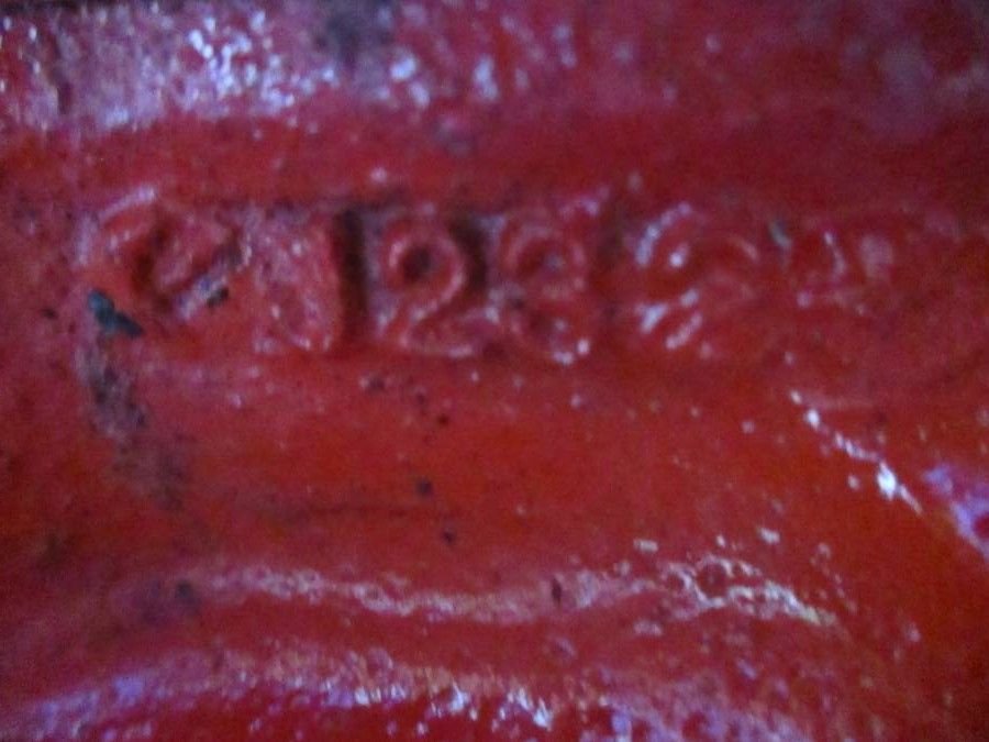

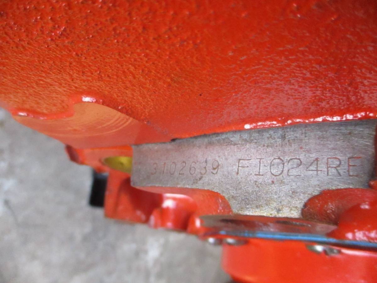

Would it be highly unusual to have a casting date of J 23 2, an engine assembly date of 10 24 and a VIN of 10 30?
I found this engine block and I am wondering if the partial VIN and assembly date are restamps

Oct 23, 1962 casted and machined the next day. put in a car built on the 30th of Oct. that is very possible. but with the circular machine marks on the pad puts a lot of question on the car
