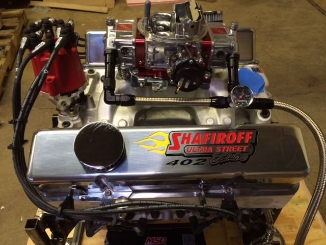

The engine arrived this morning!

Looks awesome Len, Happy New Year buddy let the fun begin!
I'd would recognize that as a Quickfuel Carb in a New York heartbeat. I have a brand new 950 cfm Quickfuel on my 565 ci 1967 Camaro.

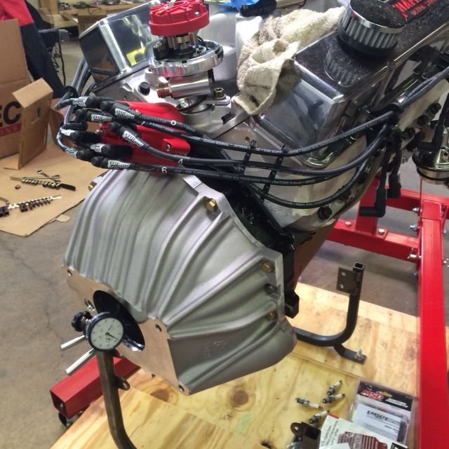

Trying to get the bellhousing clocked. 0.016 TIR
Ordered offset pins. Should be here on Thursday, and we go again.
Pics of the process:

Offset Bell Housing locating pins cam in around 12:30 this afternoon. Screwed around for about 3 hours trying to get everything aligned. Wound up within 0.0035" TIR so that is finally done!
Installed the clutch and pressure plate.
Installed adjustable pivot ball for the clutch arm. Waiting for the paint to dry on the arm to install that and button up the bell housing.
I may try to get the transmission sorted and mounted to the engine tomorrow (depending on workload) Now I do believe that it might be time for an old, single malt or two
