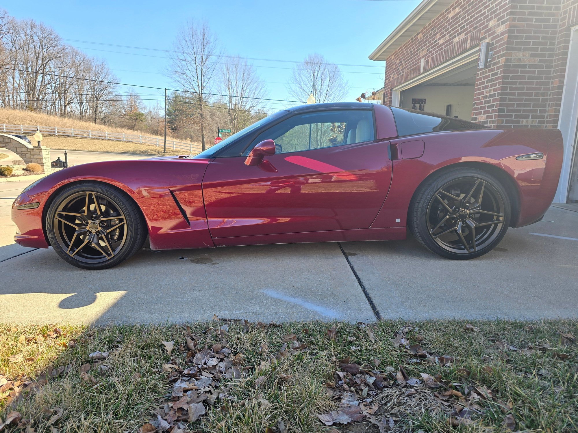

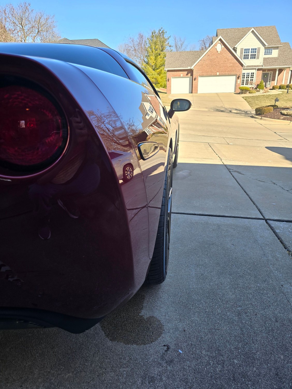

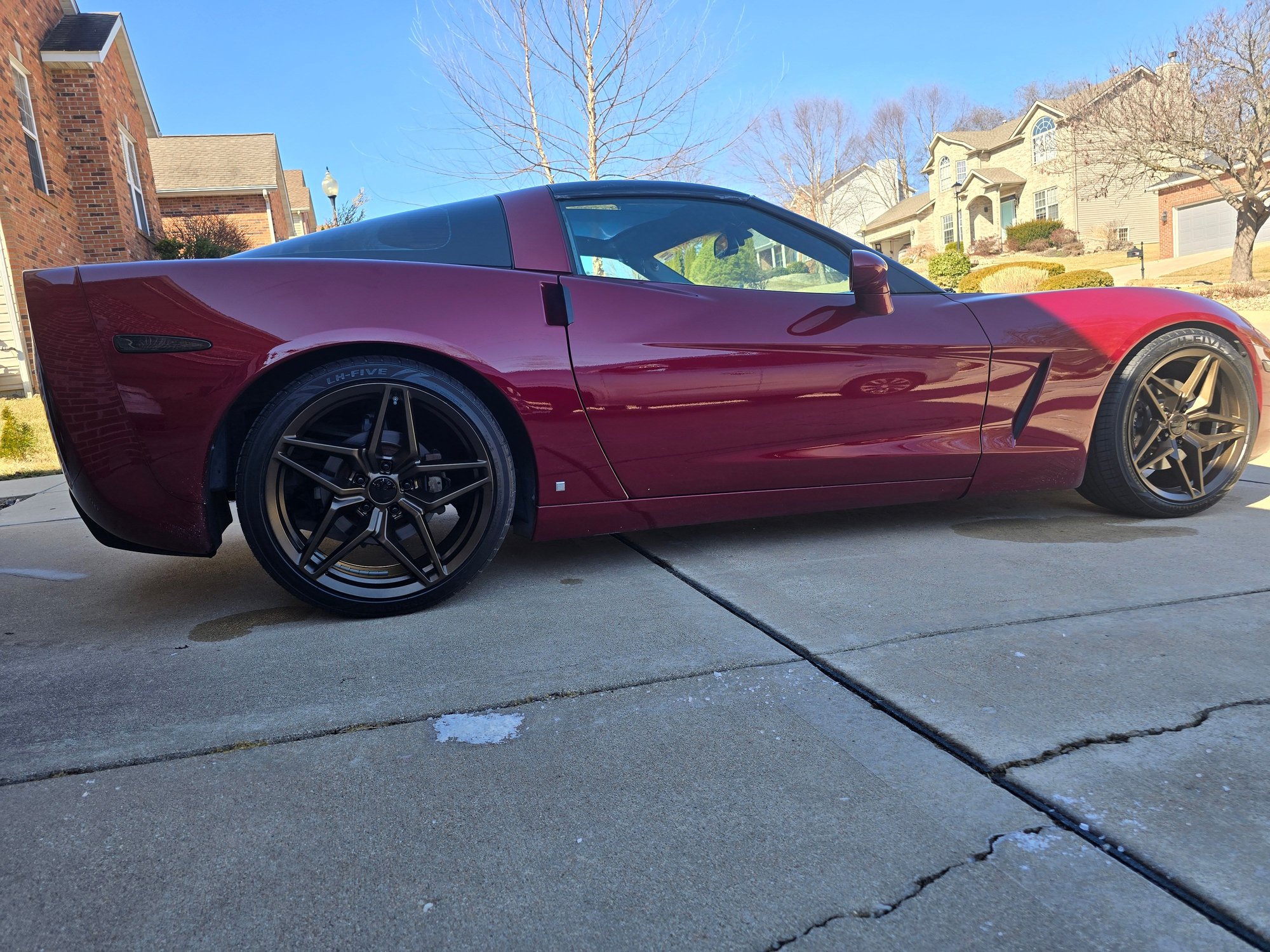

Looong time lurker. After years of drooling, I finally bought an 06 base model in Monterey red. It has a lot of miles on it, but already started working on a refresh. Ported LS3 heads, Preciision Performance ls3 intake, 103mm tb, and looking for what cam I'll do for street/ summer daily. When it's apart, I want to start replacing some of the normal things...like gaskets..
It's weird cause I have owned a plethora of Mustangs (and never wrecked them ), so this is new to me.
