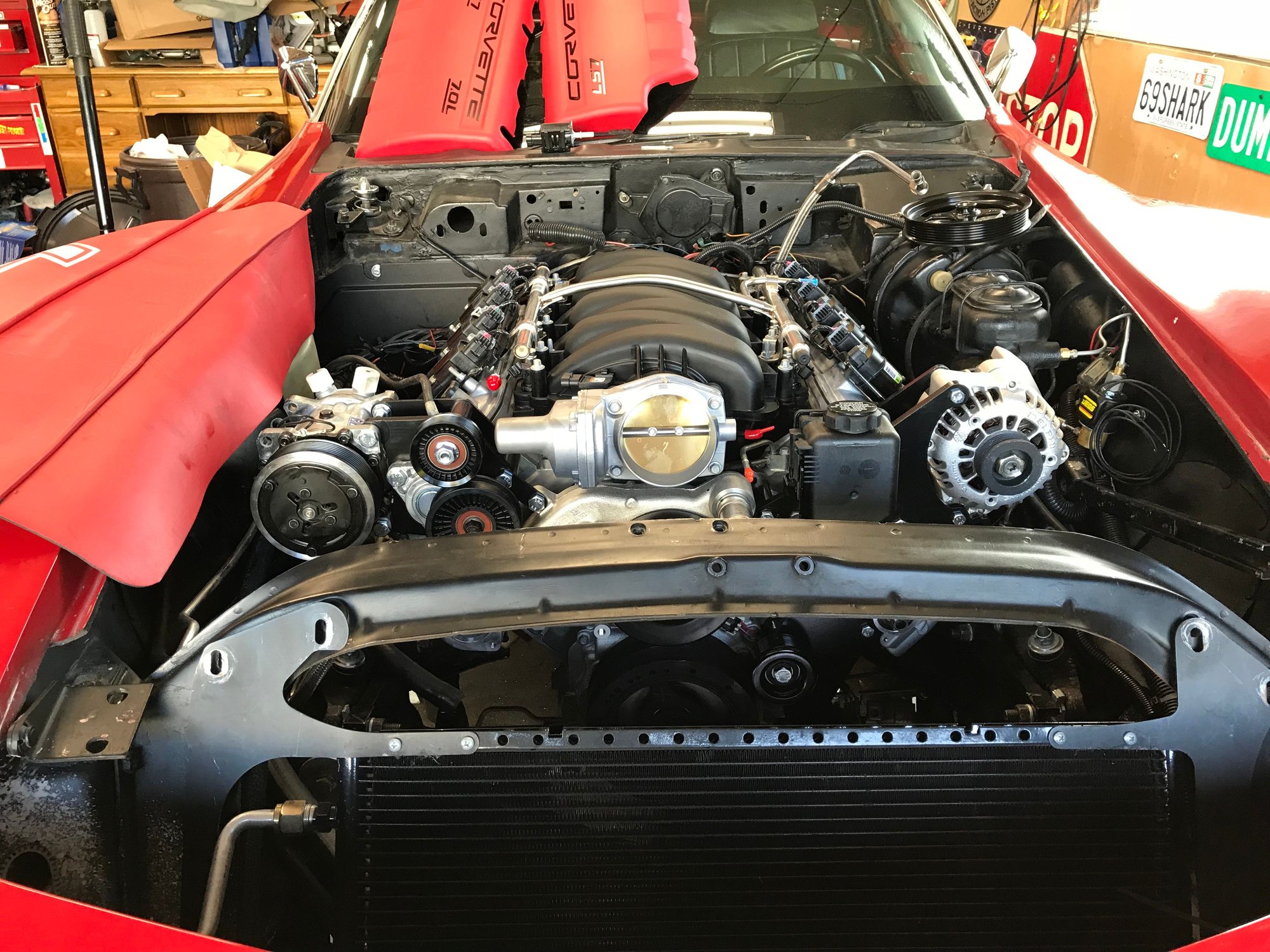

Slow movement but the LS7 is now on the motor mounts in the car!
1 Step at a time I will get there!
Scott

Getting closer!
