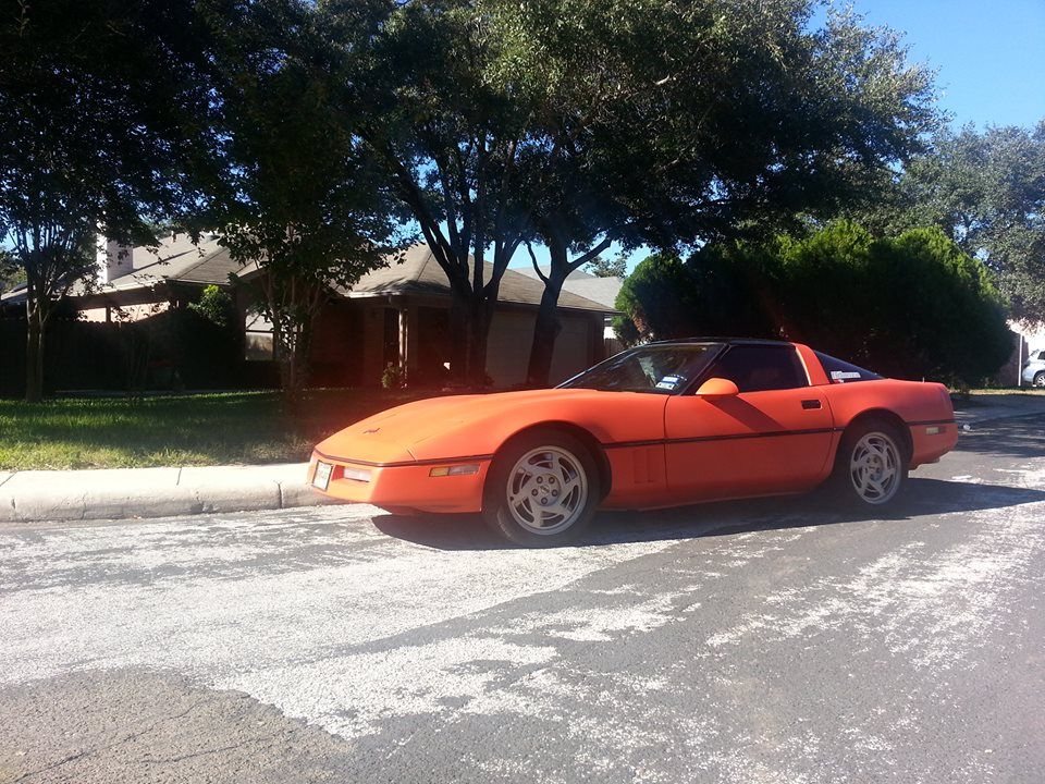

Yup, very important to put on several coats of the dip to make sure it's strong. Great thing is, DipYourCar has come a long way. The products they have now that can protect the dip are pretty amazing. Using the spray gun kit is also a must. It makes it way faster and way easier to get a nice even coat each time every time.
The first dip I did was a flat orange, the second was the Deep Sea Blue metallic w/ glossifier.
