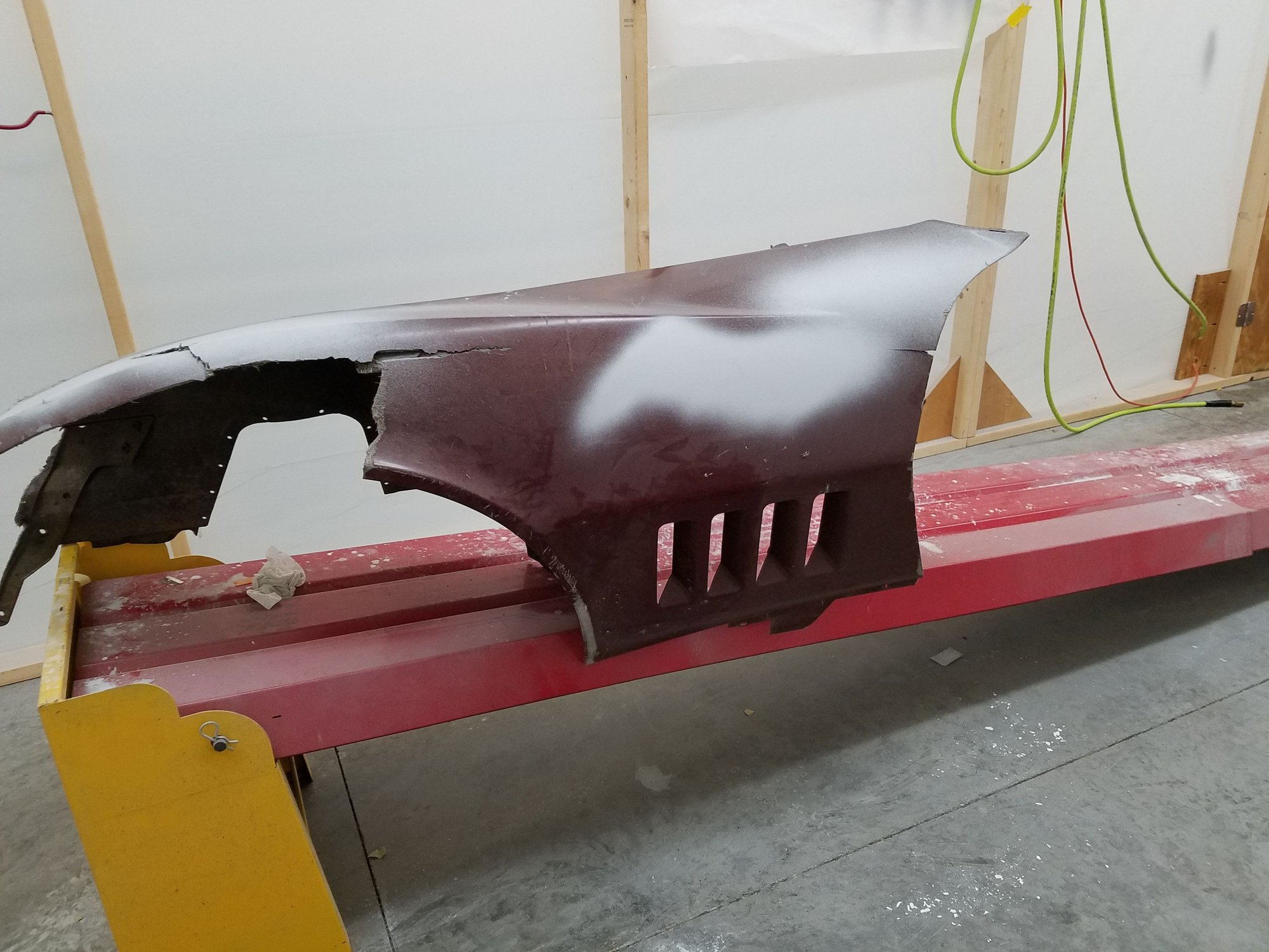

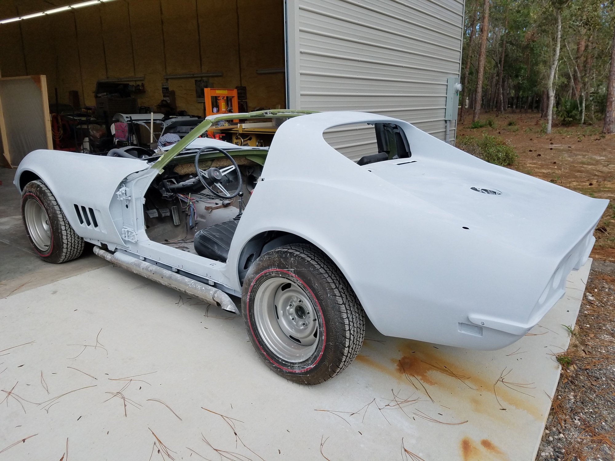

Primer on a 69 for the very first time

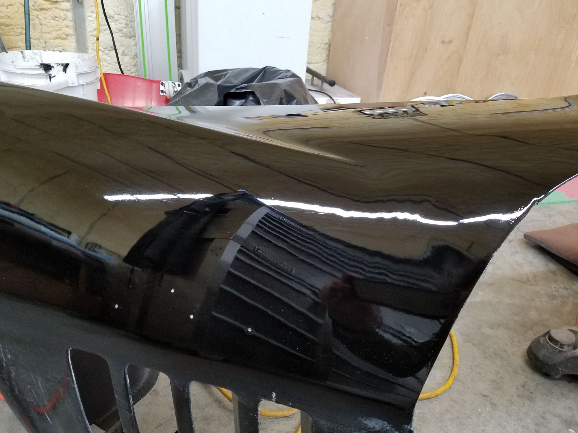

My first attempt at base coat, clear coat on a test panel.
Test panel
Test panel sanded and ready for a second attempt
Second attempt was much better as far as getting the gun air pressure set.

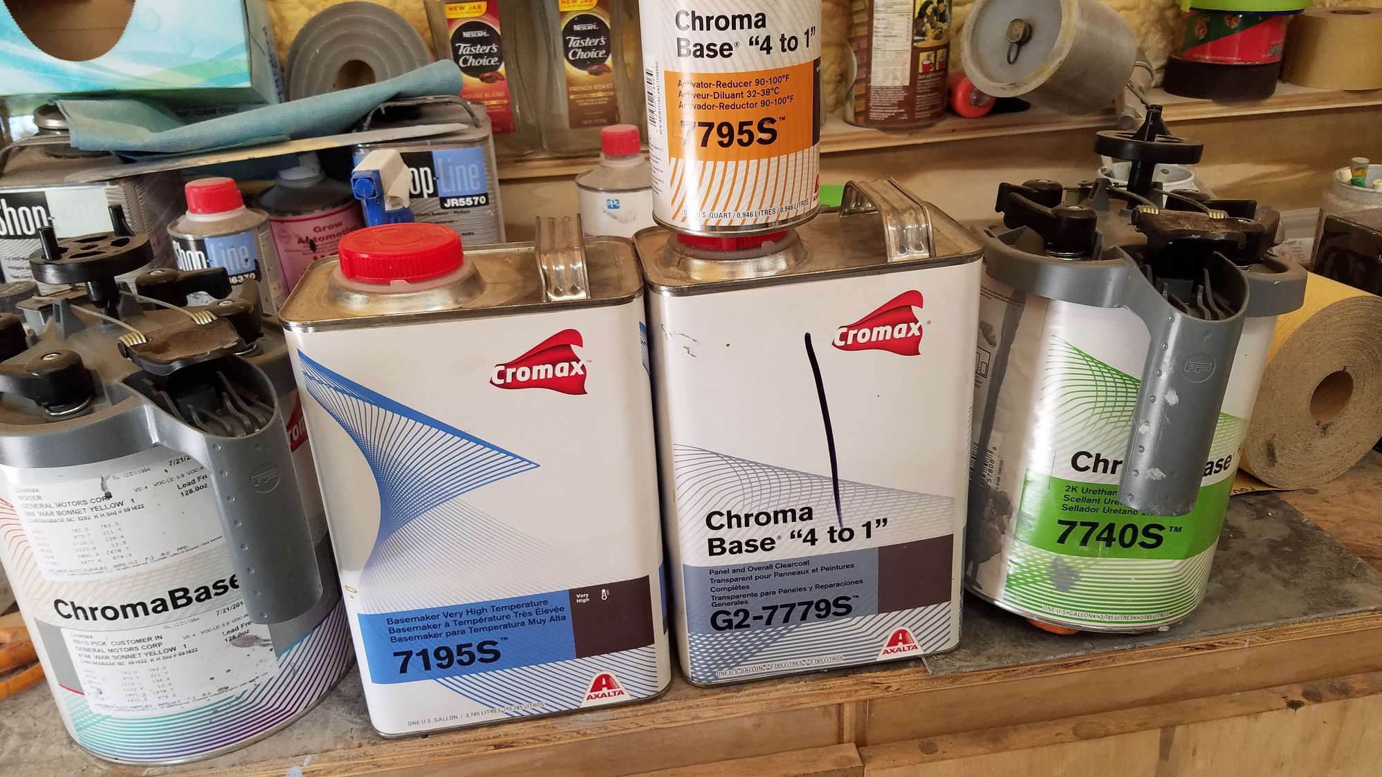

The Axalta system I use that works for me. Many products out there.

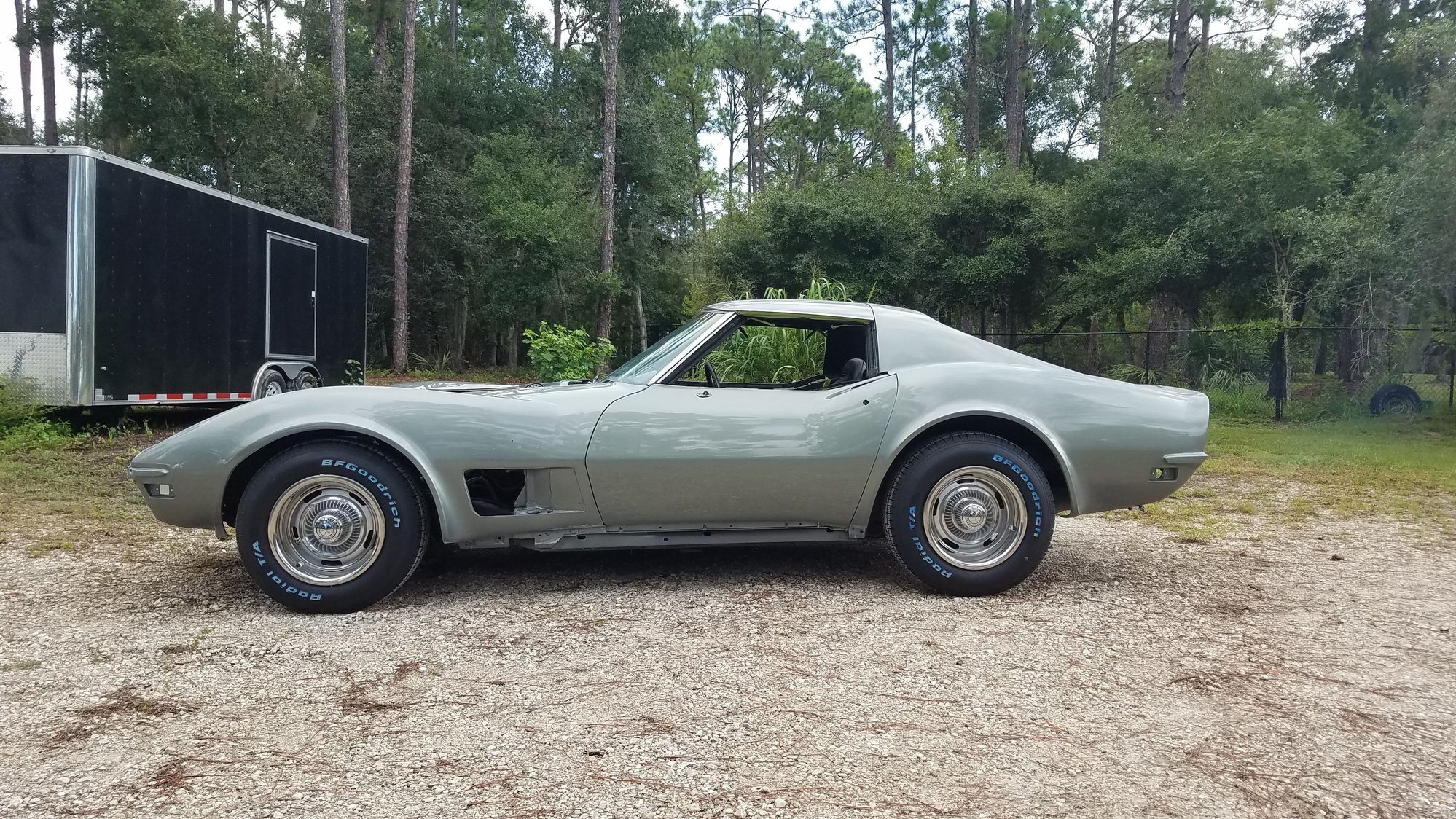

My second car ever painted . A 71 War Bonnet Yellow metallic.

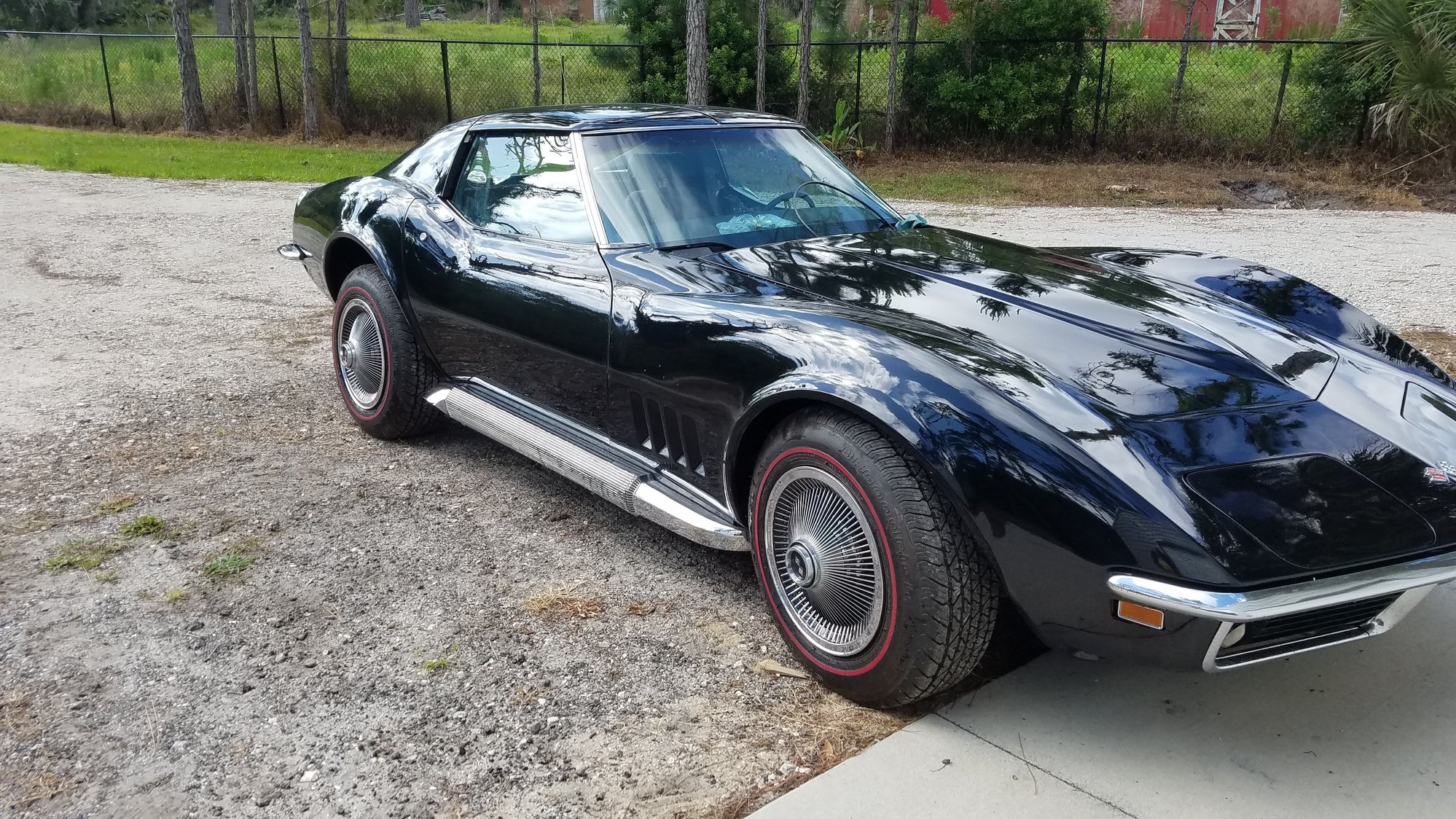

Oh, the first is my 69 in Black. All the cars perfect and ready for Barret Jackson? No, but nice enough for me to feel like "hey I did that".
