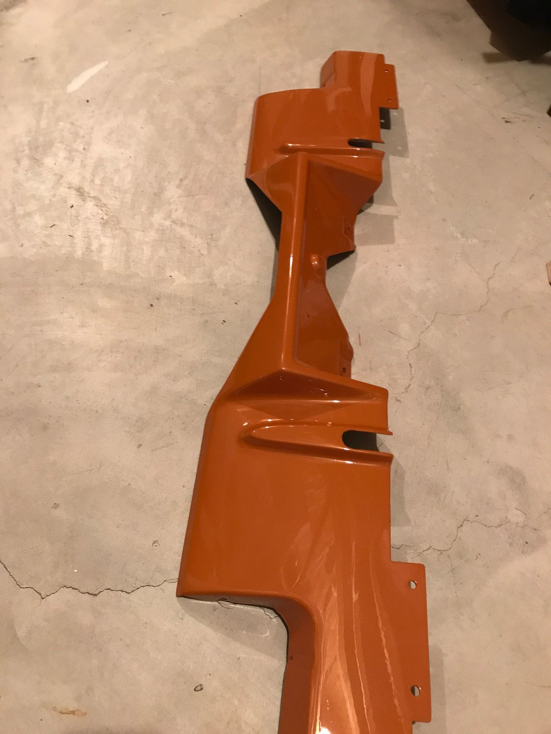

My first spray of colour and clear, on the lower rear valance resulted in what I believe (after a bit of research) was solvent pop. I knew I laid the colour on fairly heavy in a couple spots, then cleared it not waiting long enough for the colour to flash off (30 Min). I did other parts, door jambs, convertible top covers etc at different times, waiting much longer (3 hours) after the colour coat eliminated the issue.

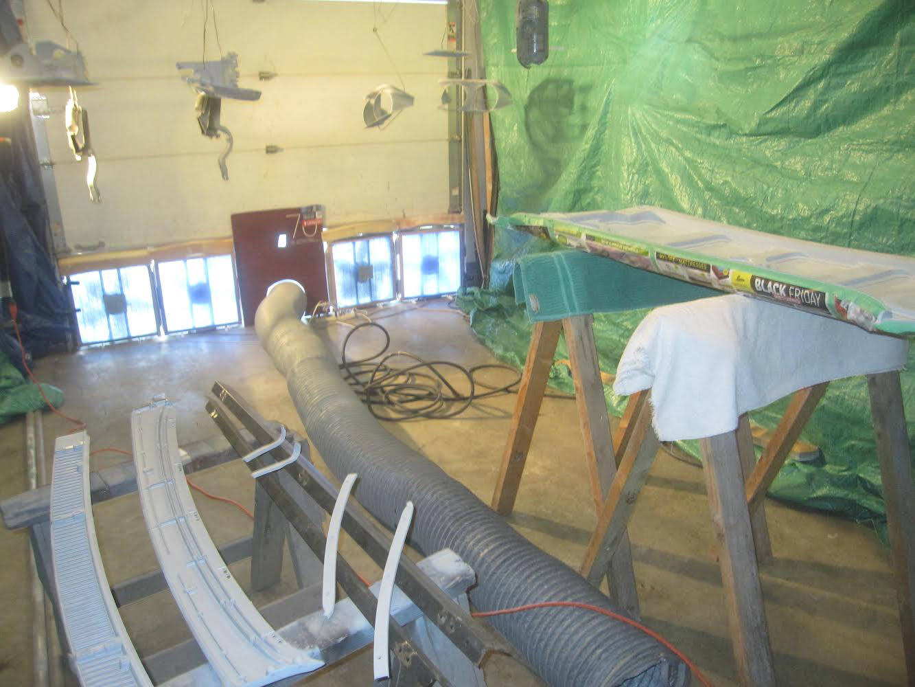

As far as my set up for drying the paint......I am working out of a regular 2 car garage, 14ft ceilings. I hang a tarp to cut my spray area in half and improve the air flow. I have 4 box fans as well as a set up I built using two furnace blowers to remove the air , everything is filtered using furnace filters. I have a door to my basement that I leave open and this pulls the air (air conditioned or heated) from the house creating a negative pressure in the garage. I don’t paint if the outside humidity is above 65 to 70%.
I am getting the odd bit of crap in the clear but I think the air flow is good enough as the “fog” is not too bad and I’m not seeing any overspray on the finish. I know I will eventually be colour sanding and buffing. I am figuring on 3 coats of clear.
