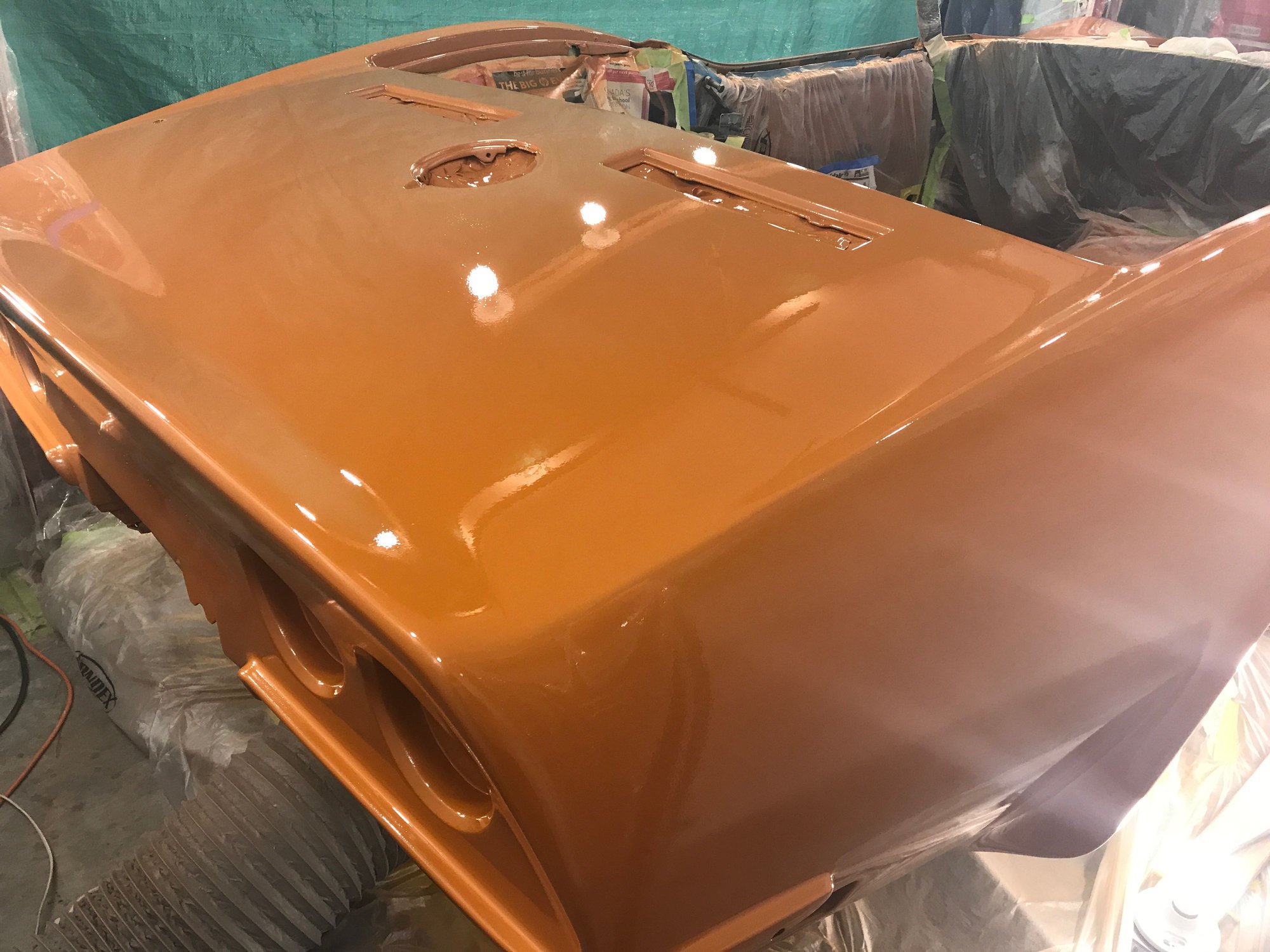

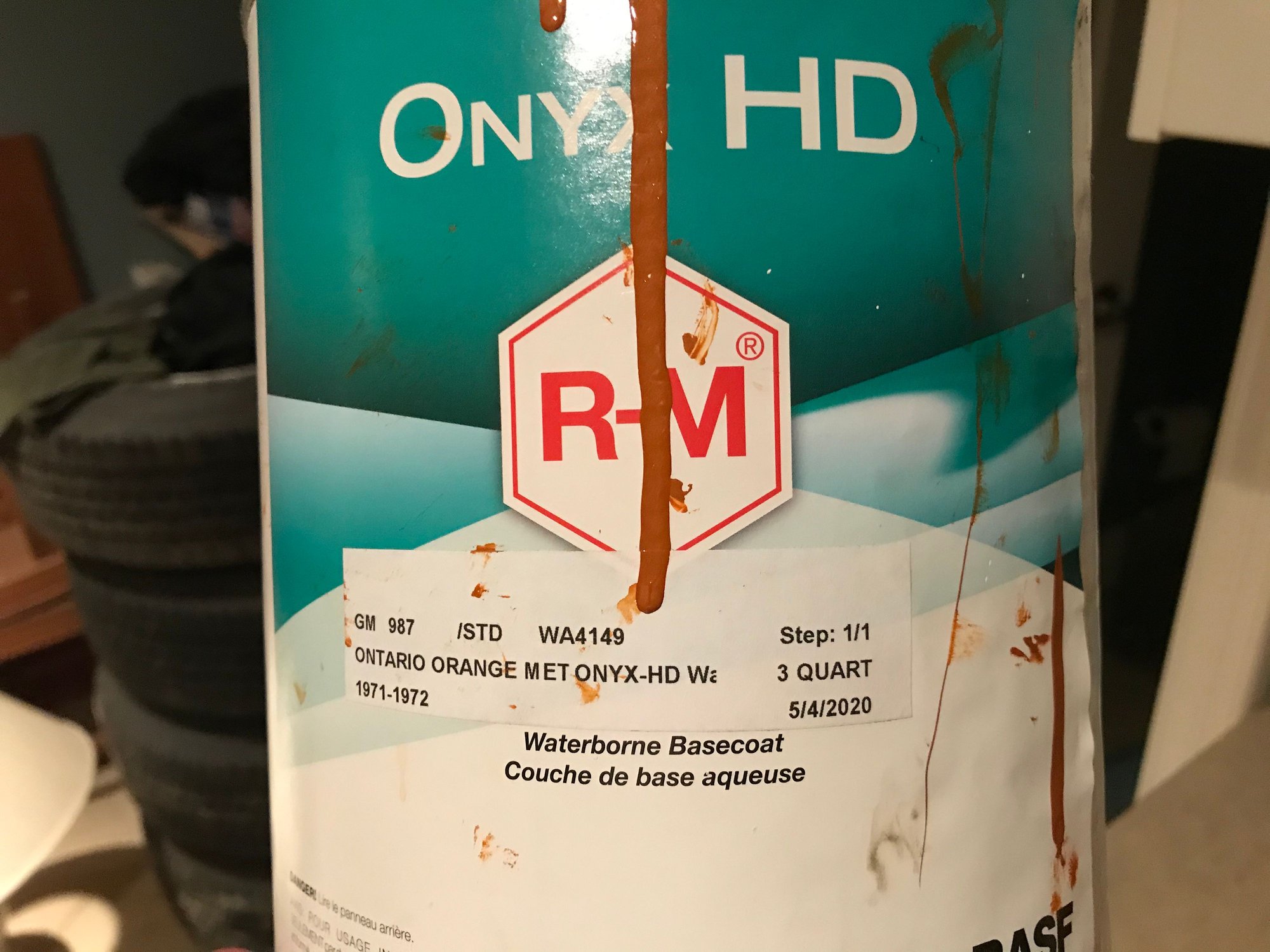

FIREMIST SUMMARY -
In the early 1960s, the Engelhard Corporation of Iselin, New Jersey, developed and trademarked Firemist paint pigments. The flakes allowed light to reflect and refract through them, producing not only a bright glittery look to the paint, but also varied hues of the primary paint color. Because these flakes can reflect and refract light, Firemist is not a metallic paint, in the truest sense of the word. A true metallic paint contains tiny aluminum flakes that only reflect light.
The above paragraph was taken from a previous post by firstgenaddict
I took a considerable amount of time trying to get the colour close....cheaper paint brands were not even close. I ended up with RM (BASF) Onyk, water based. Now keep in mind my paint for a 1971 and 1972 was called Ontario Orange, door tag # 987 and Code WA4149. I would think the same paint brand is available to you down under. One thing I found was I painted the hood, convertible top cover, headlight doors and other small parts separate from the body and doors and there doesn’t seem to be any colour variation. As said in the above paragraph Ontario Orange is not a true metallic. You have to be in the direct sunlight to see any indication of a metallic type finish. Out of the sun it just looks orange. Now having said all that, my experience is very limited so don’t take my info as gospel. Don’t hesitate to reach out if you have any questions...
