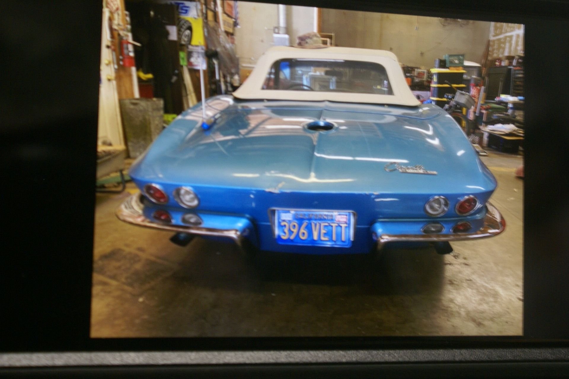

Friend had an accident as they were unloading it from a trailer the car rolled down the trailer car went into the garage and hit a file cabinet dead on the center. From what i have been reading a Polyester resin and regular mating will be ok to repair the *** end, if you look closely the rear body panel and the top rear body panel got damged. I wanted to ask if the fiberglass work, body work is done will applying gel coat to seal the surface so it is stable and the surface wont move in future.

post up some photos
1 - look at the back side - see was it cracked
2 - your going to have to strip the paint back as see how back the damage is - wont know until you strip it
once stripped you can get a game plan
Mat and resin will work fine
Then polyester primer
then a 2k primer
Then sealer and paint
