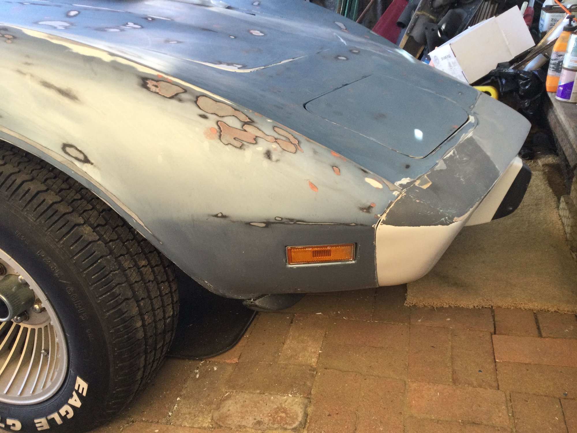

Have been using razor blades to remove the white paint on body, now working on bumpers and question is: can I safely use heat gun to soften paint or will it distort bumpers Also How do I address the nicks and scratches I’ve put on body panel?

Unfortunately I can't help you regarding the urethane bumpers but I recall reading NOT to use any solvents on them. regarding the body nicks, you can use Vette Panel Adhesive (VPA) from Evercoat and it should work well.

Many years ago I too, razor stripped the body of my 76’. It took a couple of days to get the entire body done. The bumpers were too flexible and the razor too sharp to remove paint by the razor method. I used a DA sander and the ole hand sanding method to remove the paint from them. The DA sander made the work go quickly. Chemical stripping the bumpers should be avoided.

Nicks and damage can be repaired with regular body filler or VPA
Strip the bumpers by sanding only
