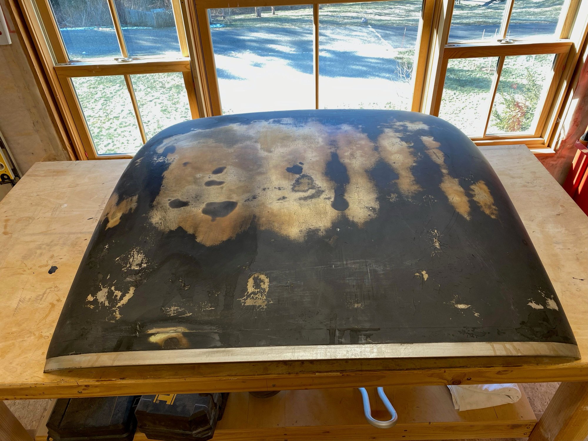

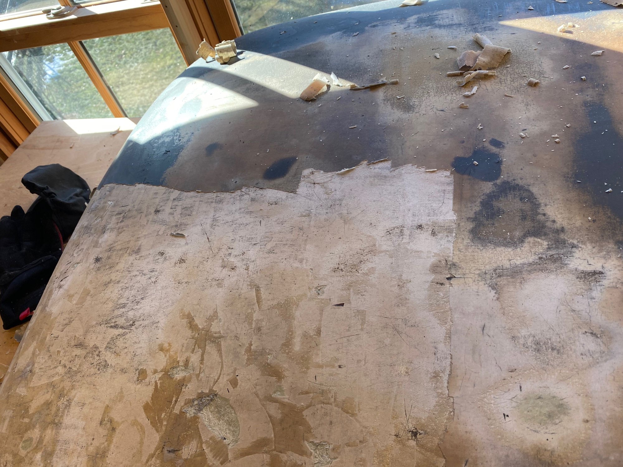

I just started to restore a 1956 hardtop (will put it on my "57). I have everything removed down to the fiberglass shell except for the aluminum header. The frame and stainless are in great shape, and I have ordered parts from Glassworks.

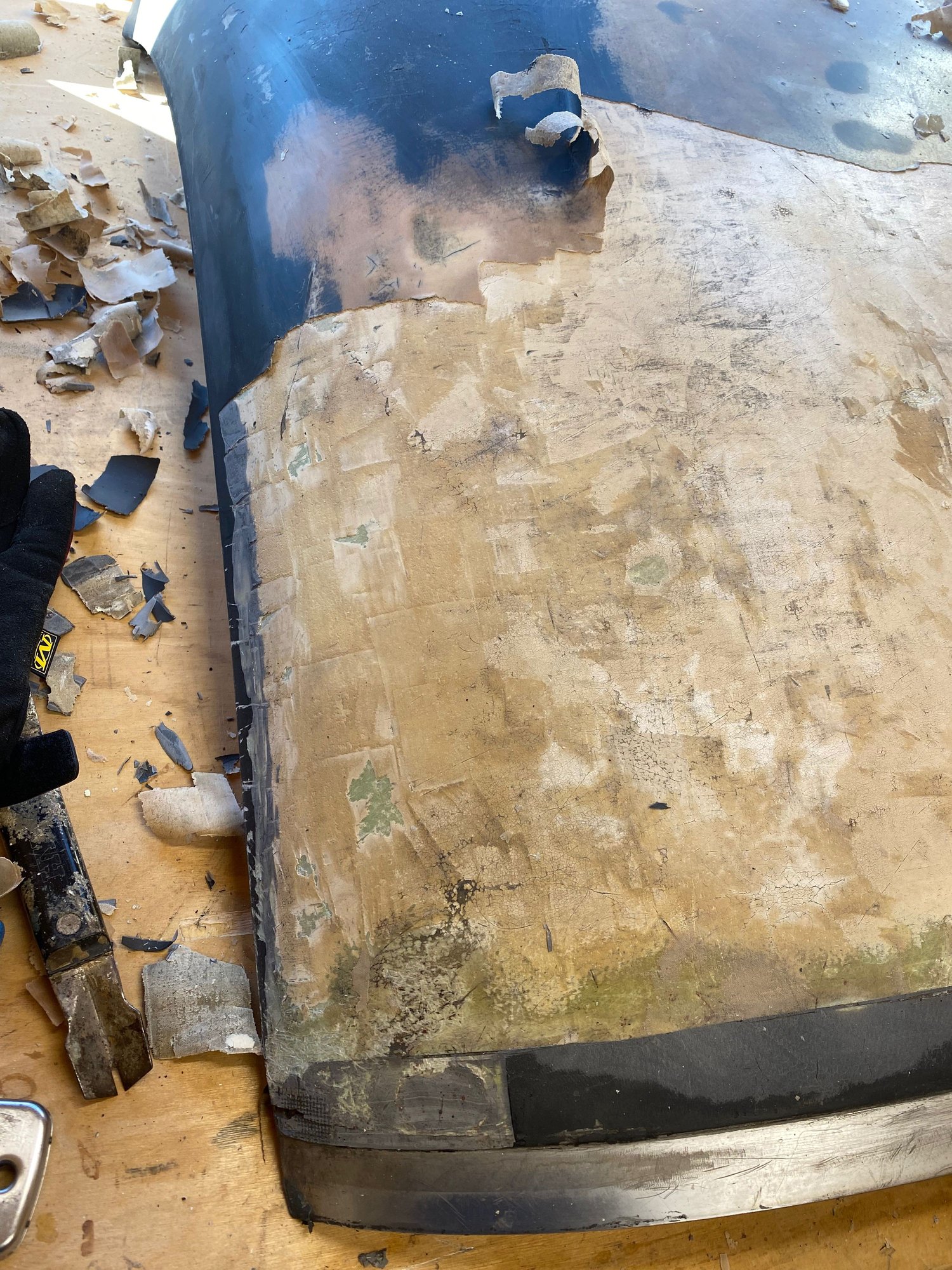

I sanded some of the top and I am trying to figure out what I am dealing with around the cracks. It kinda looks like there is a layer added to the original fiberglass, but not sure what I am looking at with the coats of paint. It may have a very very fine mesh under the top coats of paint. Some pictures are attached. Any opinion about the different layers on the top, and how to remove all this stuff would be appreciated.

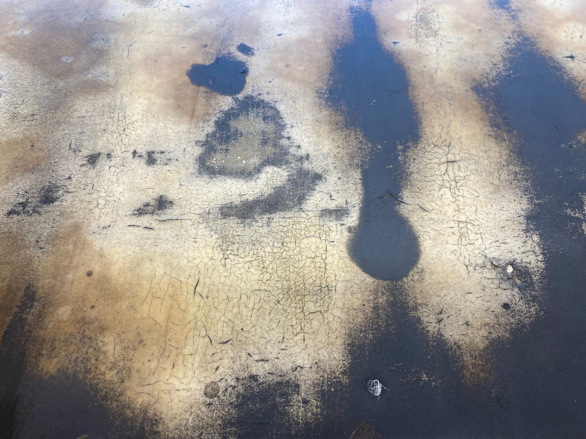

I am still looking for some advice on restoring this '56 hardtop. I am removing a layer of matting and paint with a heat gun set on low and a razor blade. It is a little time consuming, but it is working. There is a lot of crazing in what I think is the original finish, but there are no fiberglass crack. See pictures.
Once I have removed all of the old material, can I do the following to finish the shell:
- Skim coat VPA to fill all the crazing - sand.
- Spray poly primer - sand
- Couple coats of urethane primer - block between coats.
- Sealer
I could really use some advice - please.

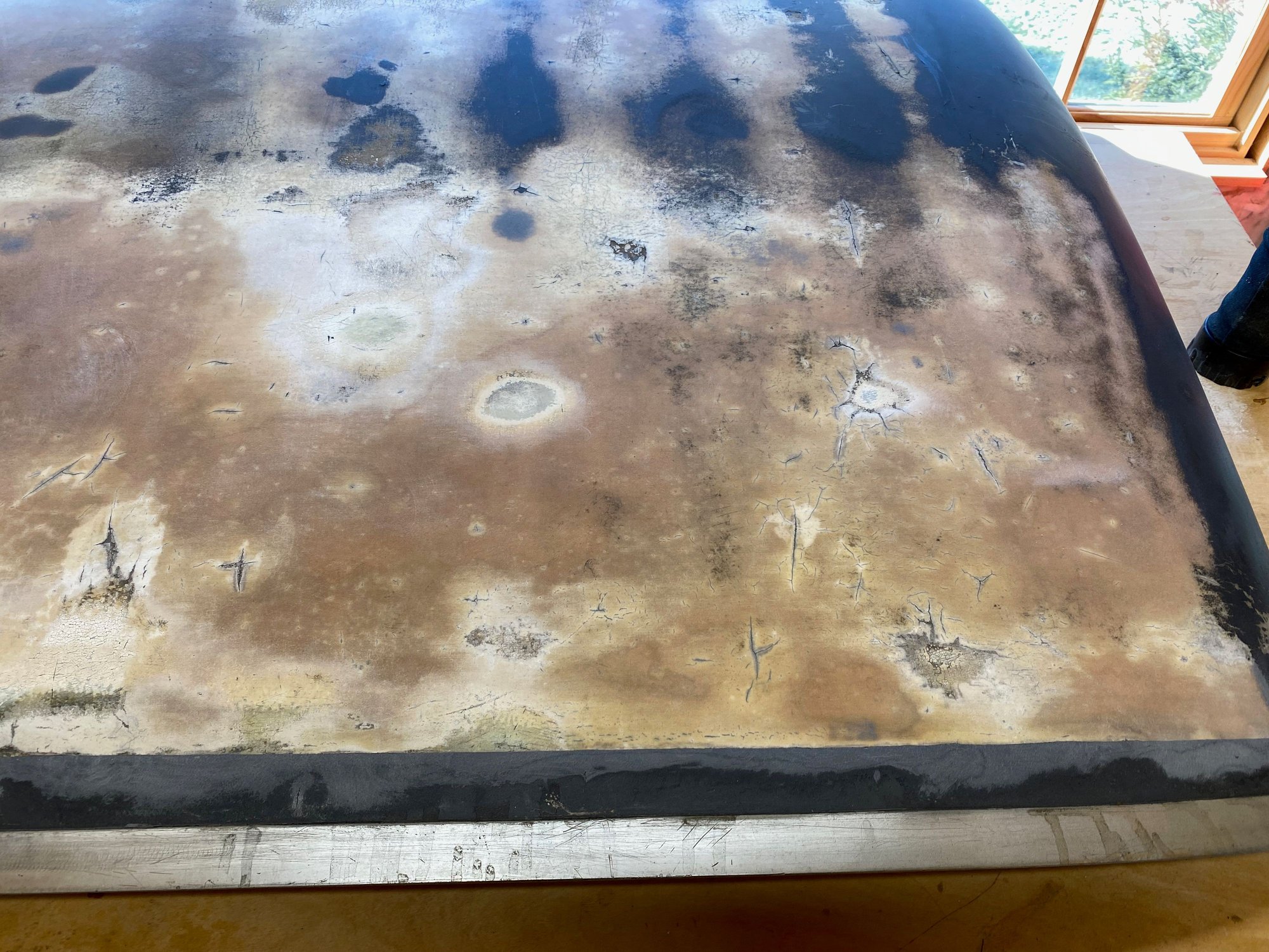

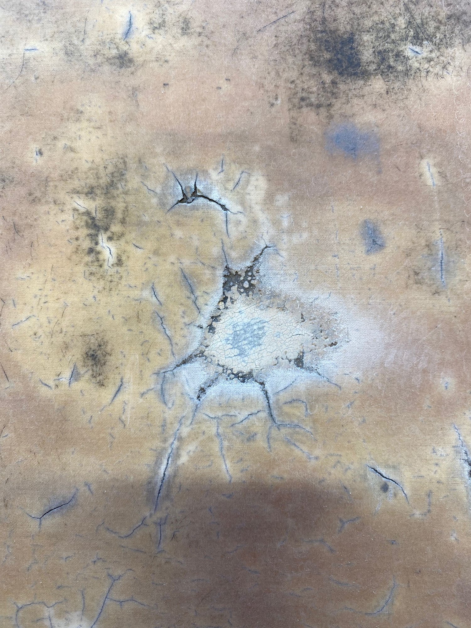

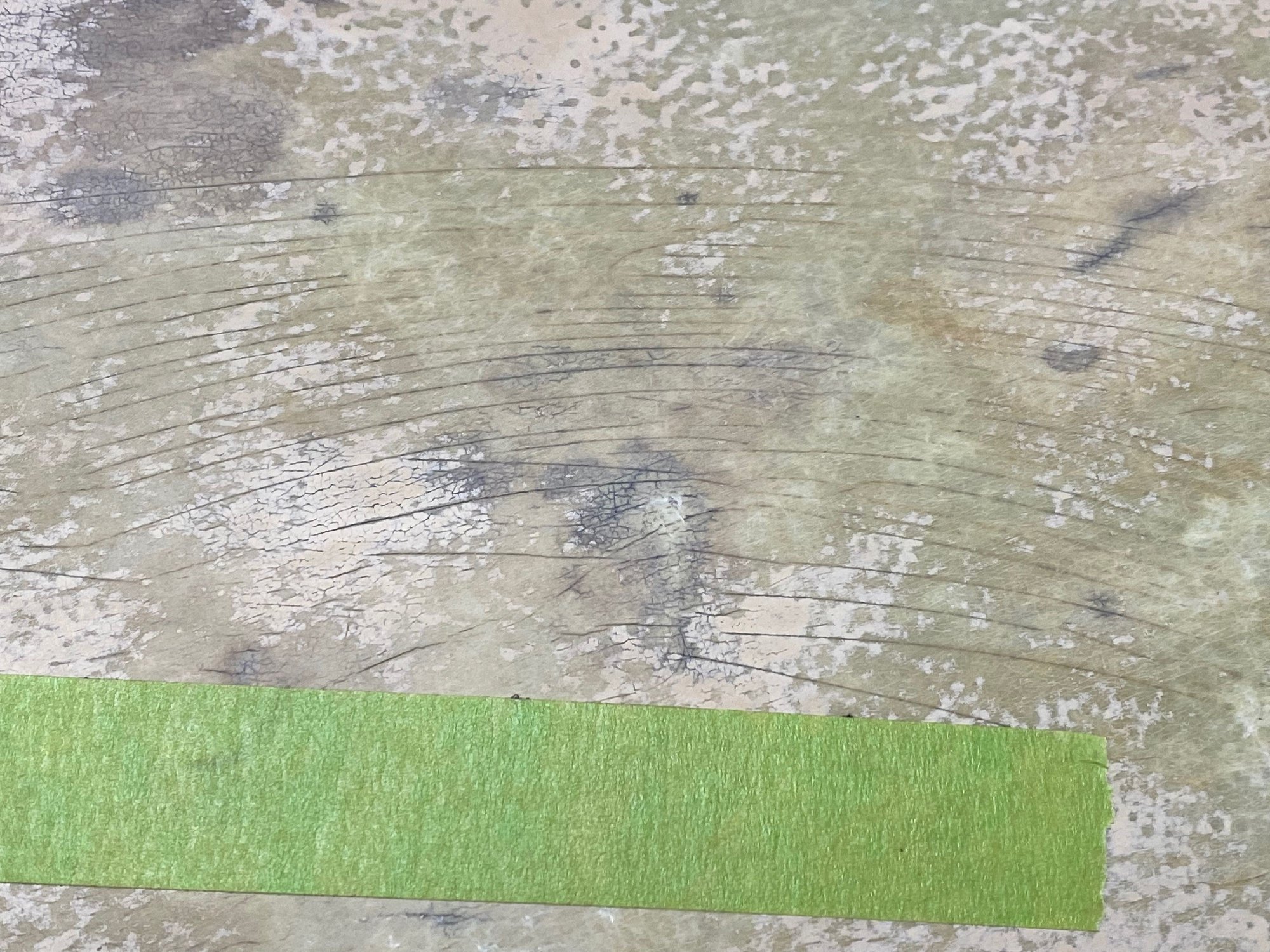

I decided to sand the original paint off the hardtop - about half done. There are quite a few spider cracks in a few spots. See picture detail of one area. What is the best way to fix the cracks? Would VPA fill and prevent them from showing thru the paint?

There is alot of cracks there
I am afraid the cracks would come back with a layer of VPA
I would consider laying a fresh layer of mat over the entire area
I know thats alot of work but it would keep the cracks down
If the top wasnt so thin I would so V groove them - but the tops are sooo floppy

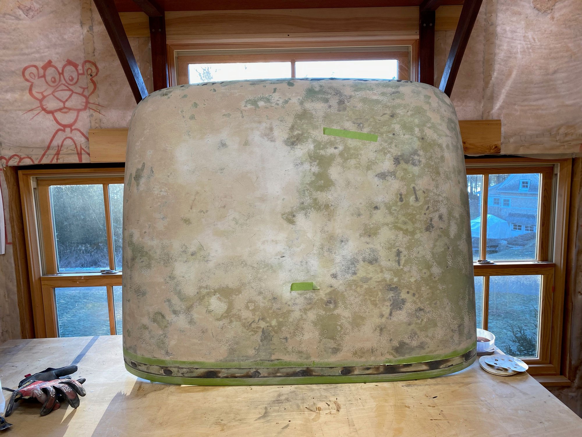

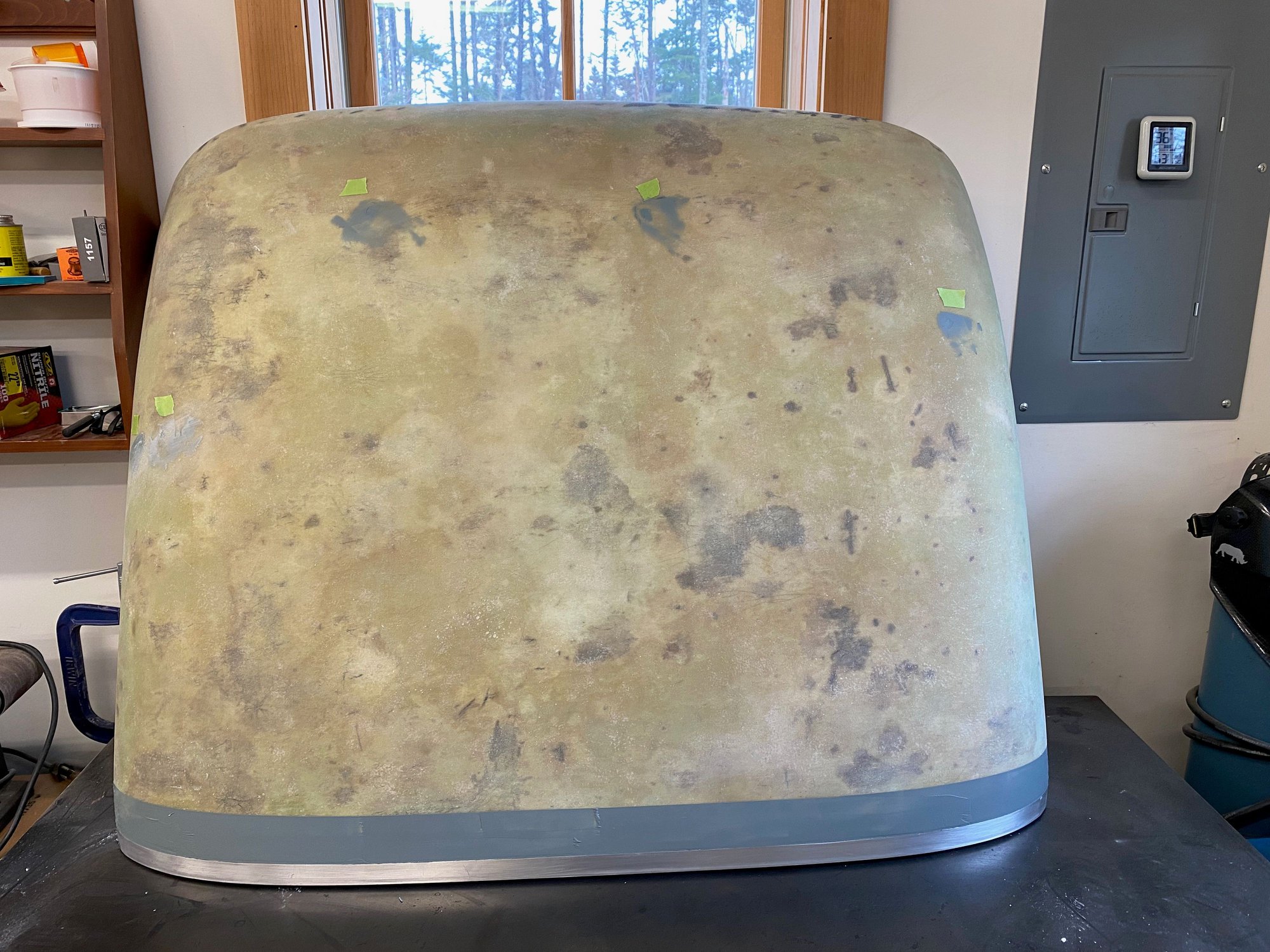

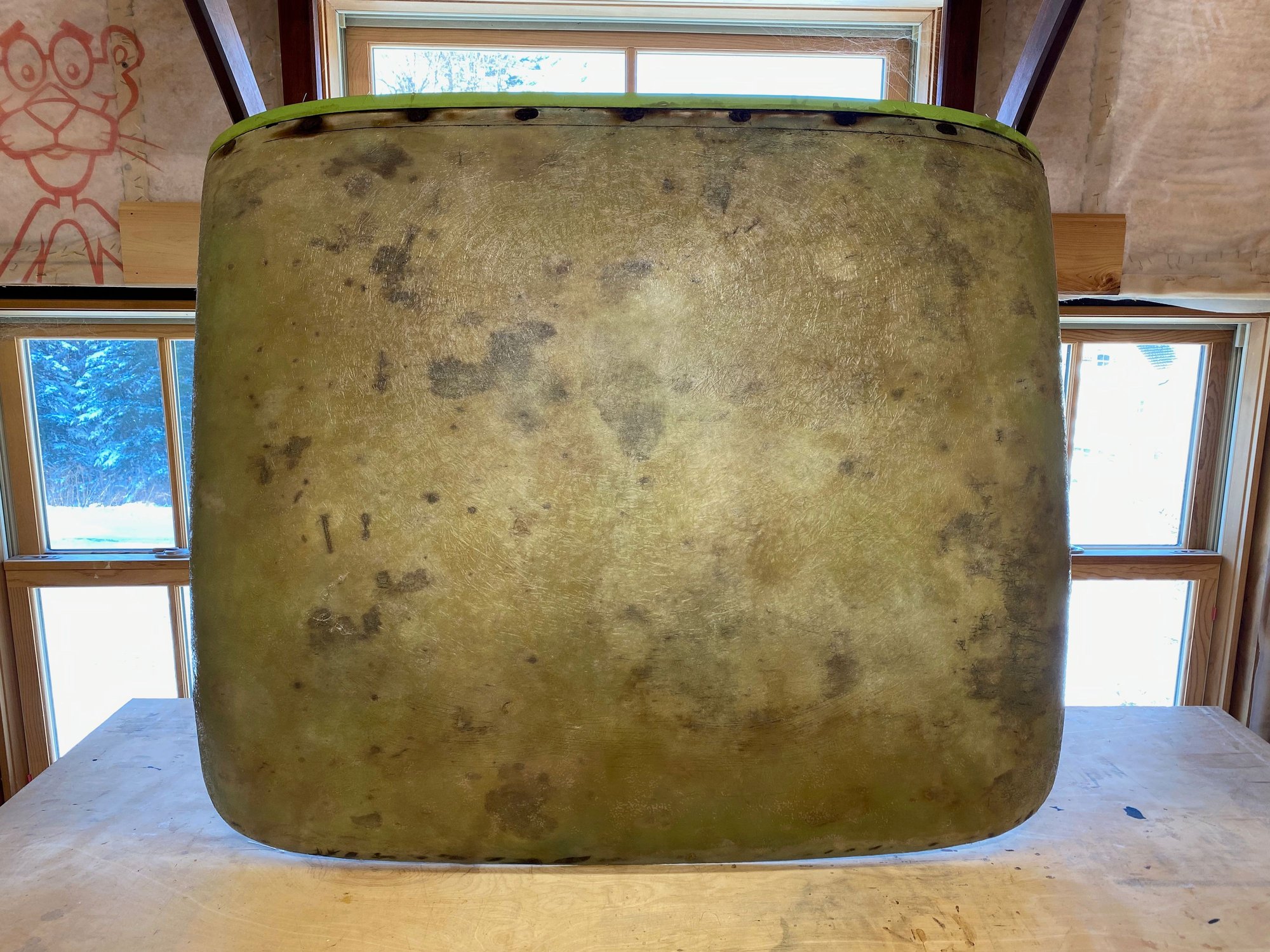

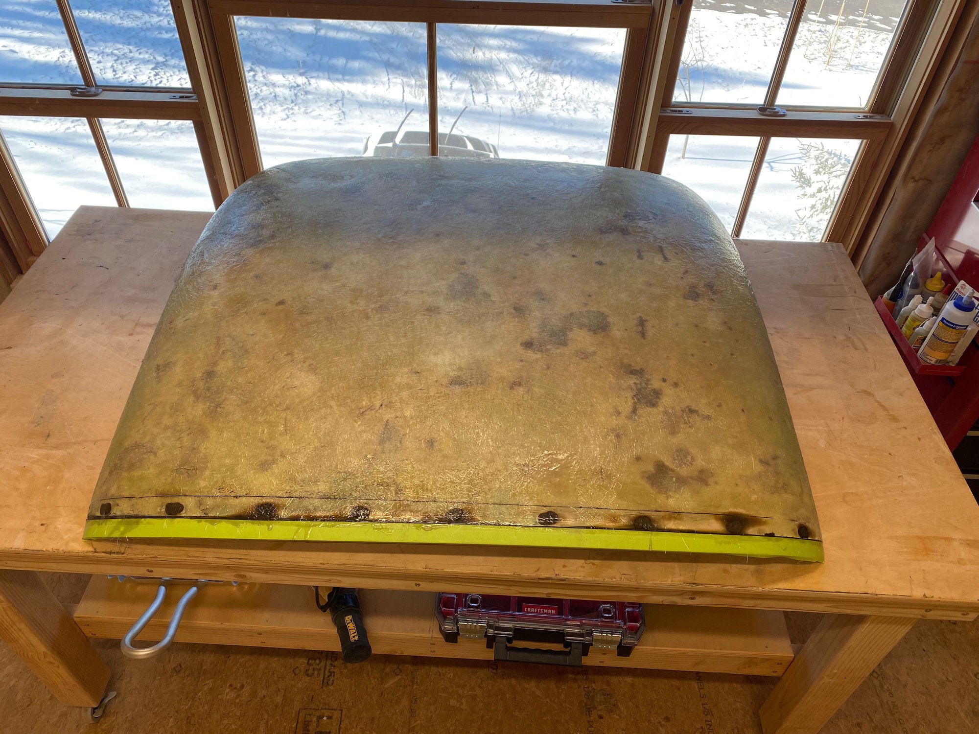

Most of the original paint has been removed from the hardtop shell.

Garrett
Question
Is the whole top like that or just the 2 areas marked with green masking?
If it is just the 2 areas - I would dremel the cracks from one end to the other and just "deep" enough
Fill the area with VPA and block
Then I would body fill and block as needed the entire top (I use Rage Ultra)
Then poly ester primer - block that
If the whole top looks like your photo - I would consider I layer of mat
Regular fiberglass mat and resin - I would lay it on and roll your resin with a foam roller - works great
If your going to do a large area - I would make 4 or 5 small batches and try to do it in sections - other wise the resin is going to want to harden faster than you can roll
You may need a helper or 2 or 3

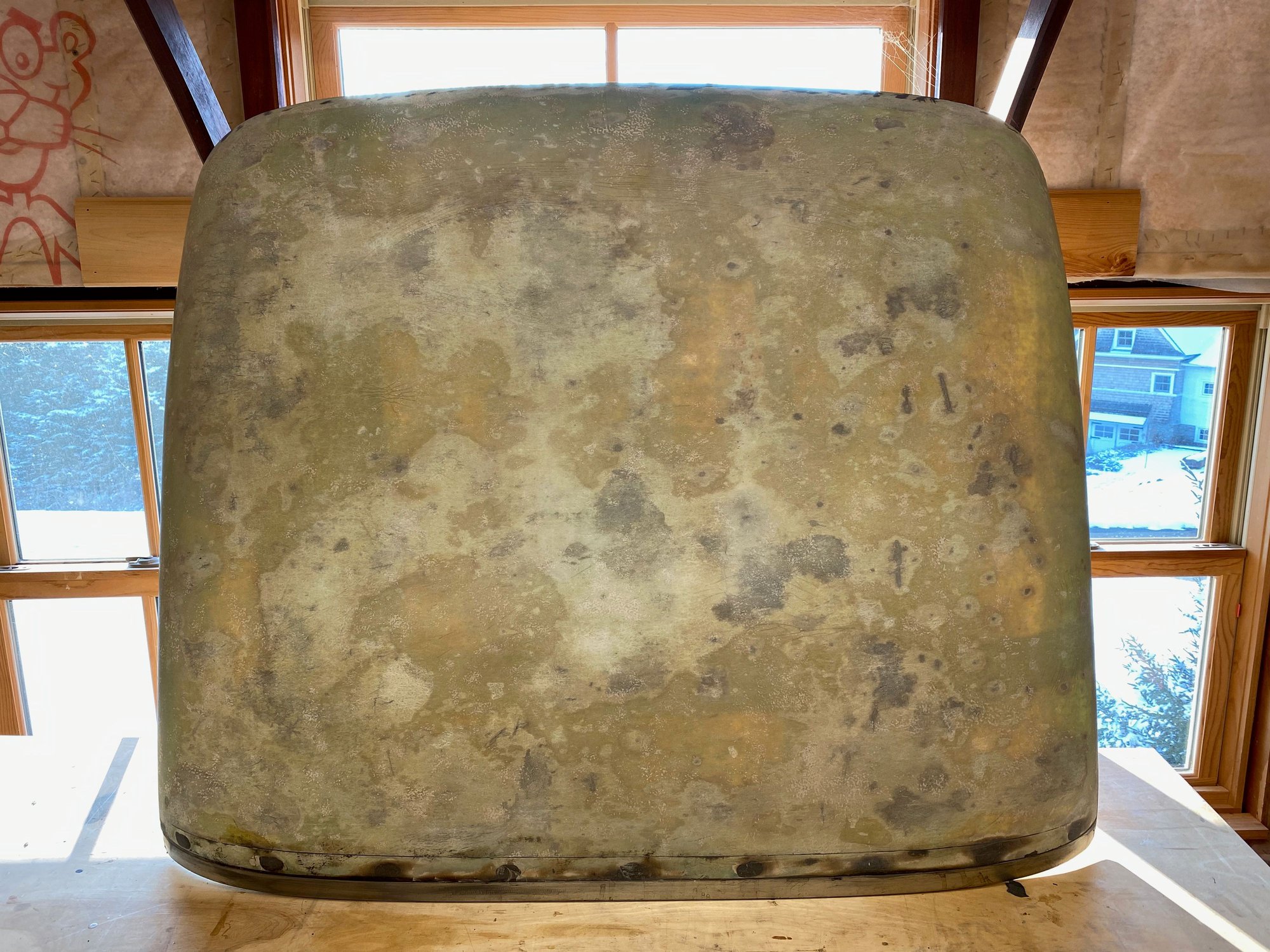

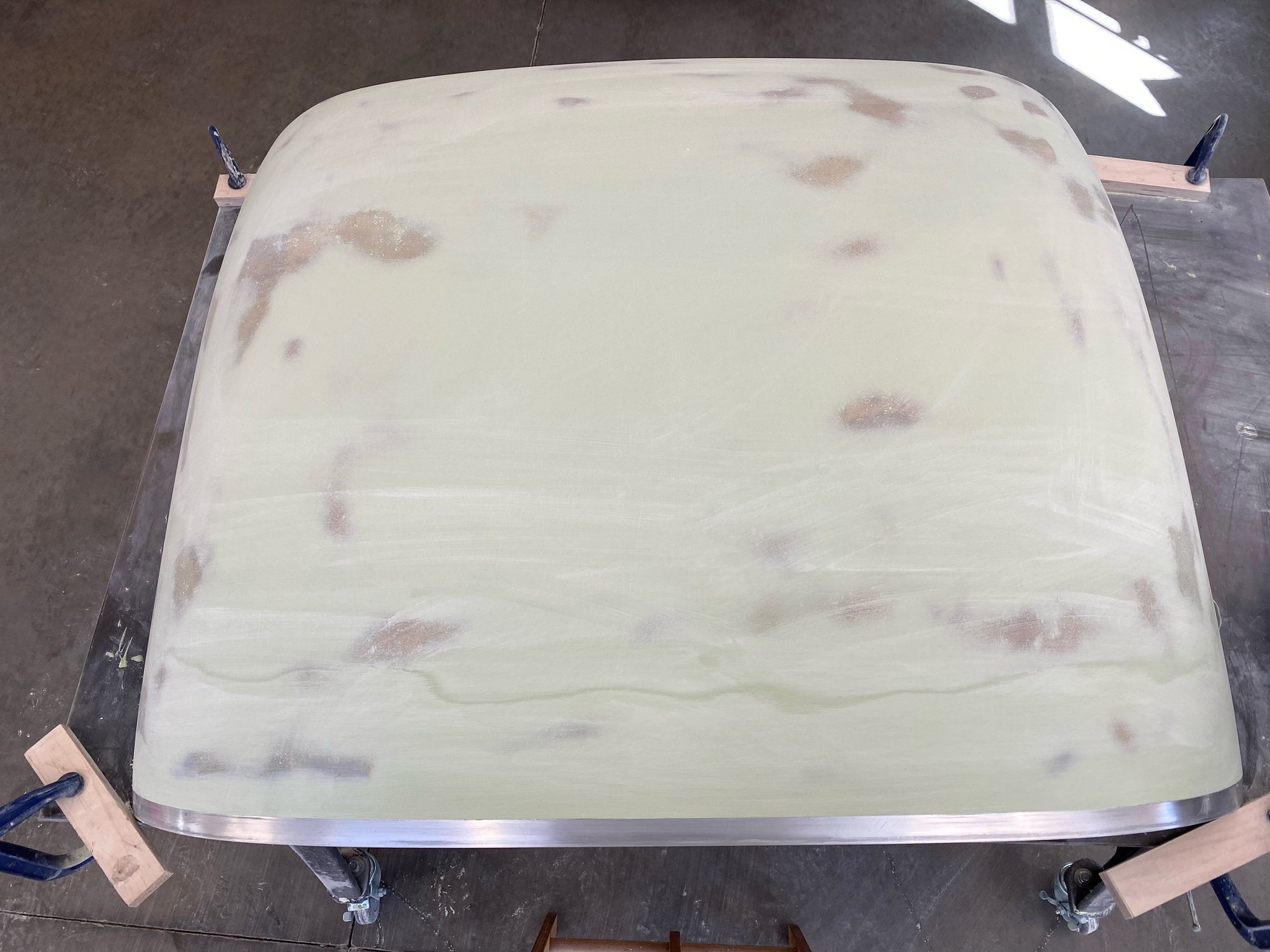

I installed the mat yesterday. Set the barn temperature to 60, and had all the materials set and ready to go - fiberglass cut to rough size, 5 pints of resin ready for hardener, 4 brushes, rollers, and gloves. I found it helpful to tape the fiberglass in a couple places at the front header until some of the resin was applied across the front header area. I had to cut the fiberglass in the rear curved corners, but overlapped the mat, and used a brush to poke the glass together. I also found the brush to be helpful to seat the fiberglass at the edges. Set the barn to 70 when the job was done.
Anyway, your recommendation to install mat over the entire top was right. It has added a significant amount of stiffness to the top - particularly in the center of the top. Using a roller and setting-up the resin ahead of time was critical to getting this covered - wet out had to move quickly.
I wasn't sure how to get this done. I have restores several cars, but never worked with fiberglass - so thanks for the advice - from installing mat to materials and step to finish!!
Looks like I have hours of sanding and finish work - but happy to do it.
Garrett

You did great !!!!
(this is what I would have done)
Old Jan 31, 2022 | 08:08 PM
bazza77's Avatar
bazza77
Joined: Jul 2010
Posts: 3,176
Likes: 633
From: perth western australia
wow , that looks great . I know you must have really been rolling smartly to get that much all down so nice .

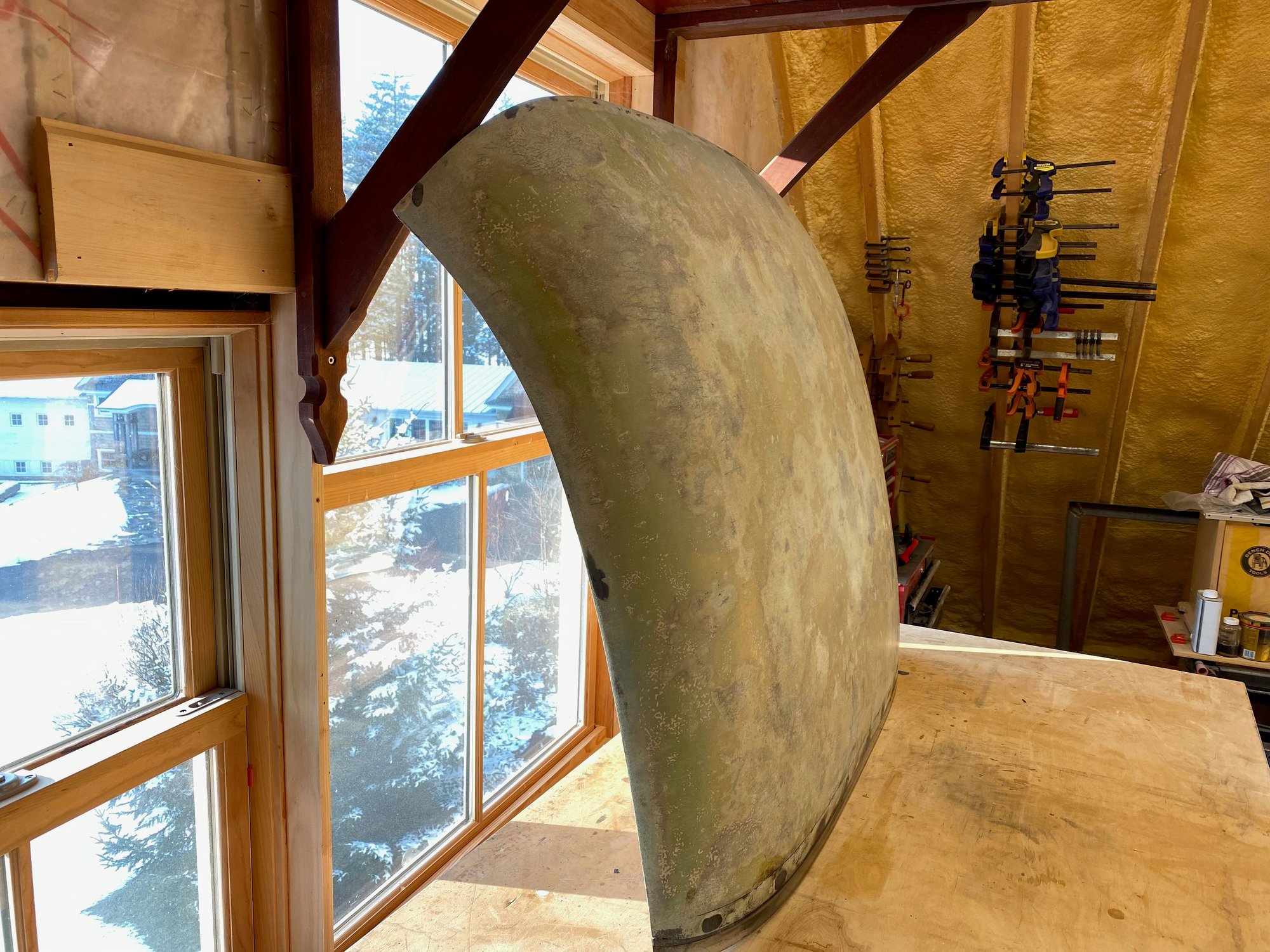

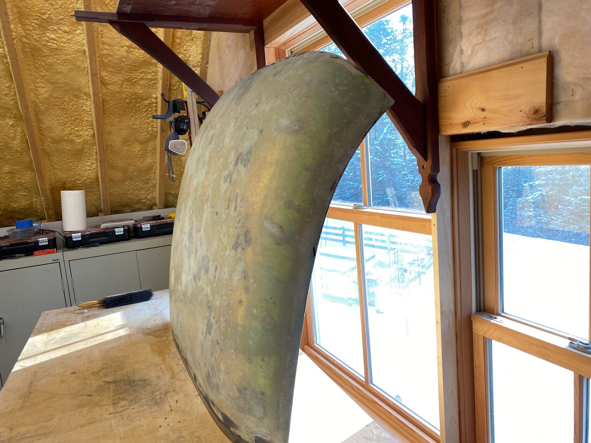

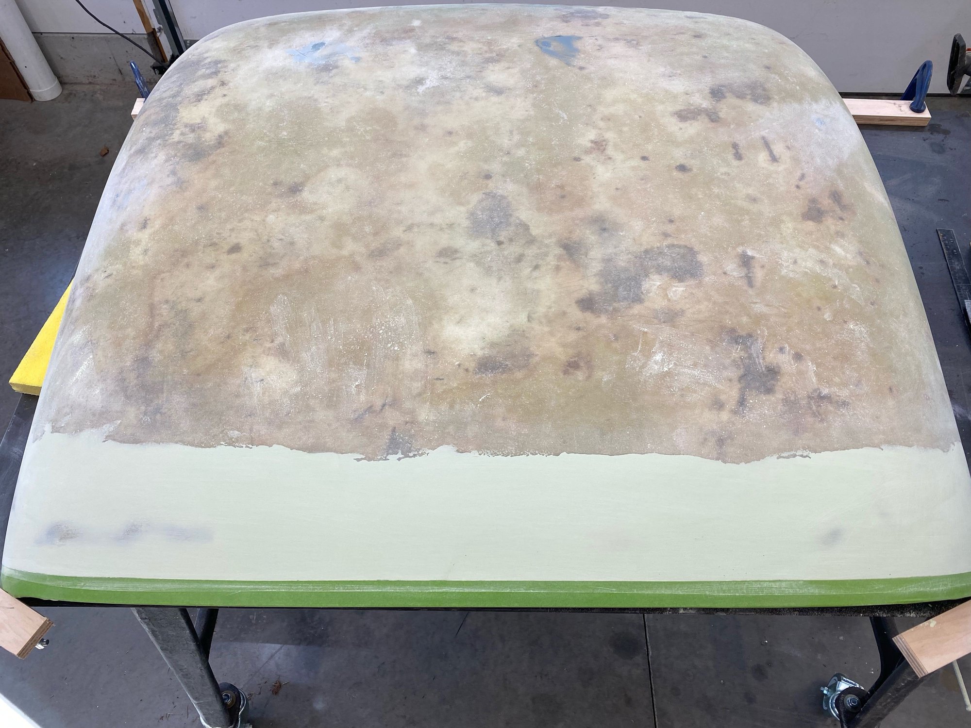

Moving along with hardtop shell. A little VPA along the header, and then a couple stages of filler. I think I am finished with 80 grit sandpaper - need to move to 120. I really like working with the Evercoat Rage Ultra Extra - thanks for the recommendation Chris. I am a little wavy in a few spots, but think I can fix with next stage of blocking.

Your doing great
If you need a good flexible sander -
Amazon Amazon
Try these - I use them every day !!!
Old Feb 7, 2022 | 08:17 PM

Do not be afraid to spray some guide coat on there - really helps !!!
SEM spray guide coat

Thanks Chris. I am using a short yellow soft sander with 80 grit sand paper - just ordered a longer yellow block. I was wondering when I should use a guide coat on this thing. I have some SEM Powder guide coat. Will give that a shot tomorrow.
