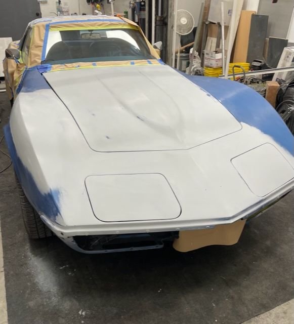

I'm looking for some Metallic Paint Blending advice. The guys at Speedo-Kote recommend the following process:
Lay down your base coats allowing for proper flash time then for Blending pour the base coat from your cup and Reduce by 35% with Basecoat additive shoot another coat cut blending into the area to be blended. Allow for proper flash time then repeat the process now Reduced 50% with the Basecoat additive and shoot another coat to blend area.
The other recommended process is contained in this link from Paint Society
It seems several painters have their methods so my question is who has done this and which process have you used?
I am shooting PPG using PPG Medium Reducer.
I prepped the blend surface with 800 grit (Everyone agrees with this), My Primed surface is wet sanded with 400 grit.
Driver side. PVC is the framing for the Temp Spray booth I am building. Booth will be 6 mil plastic, Fine filters in the rear and front with exhausting fans on the outside with a Zipper door like used when doing Mold remediation. Painter's paper will go in the floor with the booth sealed off. The car will be thoroughly cleaned including tires, then rolled into the booth and wiped down again prior to paint.
Passenger side

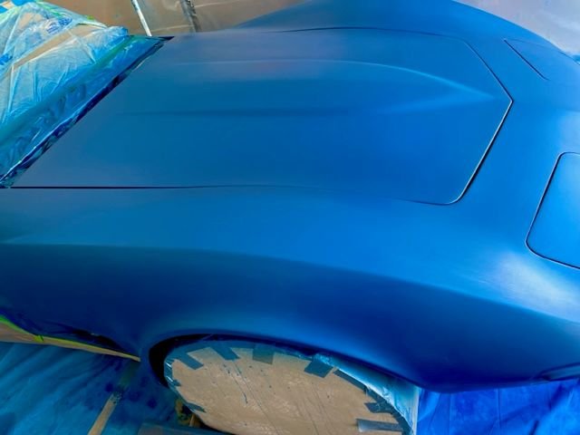

From: Santa Clarita, CA
Hey Mike,
Thanks for checking in. I painted the basecoat Sunday and while applying the first coat my exhaust fan died causing a lot of paint dust to settle on the surface causing an Orange Peel effect. Having experience with how to cure "Orange Peel" I decided to finish shooting all the coats of the base coat. After completion I discovered three imperfections. I spent the afternoon doing the old school Wet sanding with 320 followed by 400. This morning I shot over the imperfections with base coat cut with 50% Blend additive which is essentially clear base and I am extremely pleased with the results. BTW, looking at the color to the original color it is excellent from looking at it in the booth even prior to the clear coat. Unfortunately today is windy and too cool to shoot the clear coat so I will patiently wait for better weather conditions.

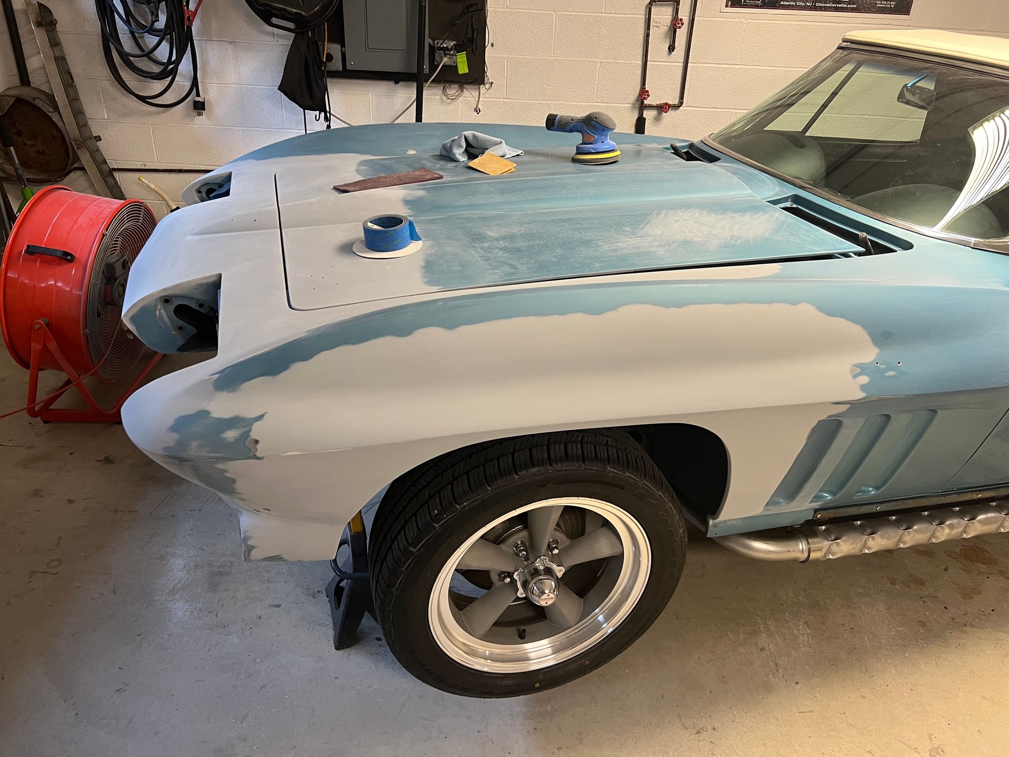

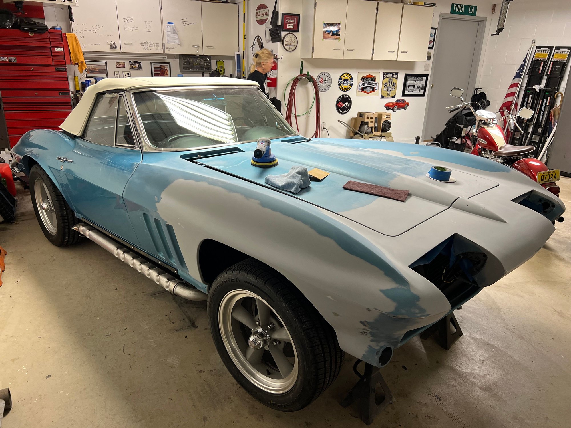

I have a similar project going....I took flares off the front. This is the last sanded coats of polyester primer before urethane primer.

Man Brian, That looks really good! BTW I built a spray booth out of 1" PVC and 6 mil plastic sheeting. I installed filters and have a 2200 CFM fan. I also laid painter's paper on the floor. I am so glad I did. I found the instructions on YouTube from someone who did it. Nice Harley in the back ground. I have an all original '49 Panhead in one of my garages which belongs to a friend.

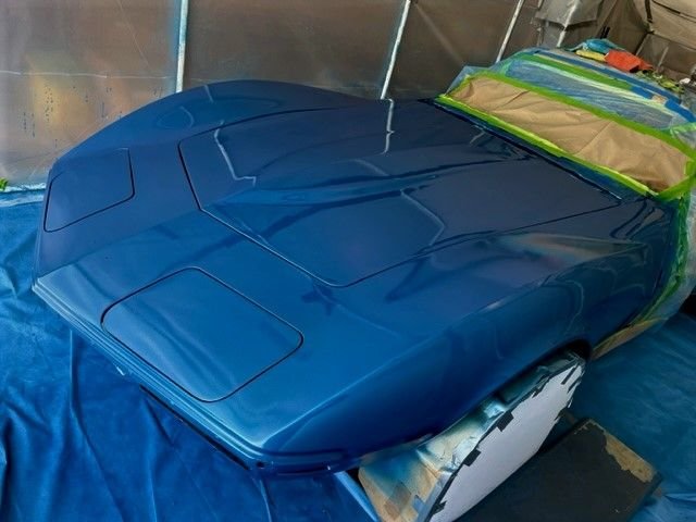

Clear coat!
Shot the Clear Coat today and I am really happy with it. Just needs to completely cure so that I can begin the cut and buff. One small issue was when I went to shoot the 3rd coat somehow the air on the gun was off so I go a small dribble. No problem, I will cut it down. Been there done that.

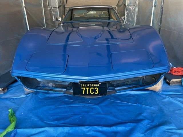

Color Blend Match!
Originally Posted by CorvetteMike2004
Your corvette looks fantastic Nice work!
Thanks Mike,
I am extremely pleased with the Blend match. Please keep in mind that this is BEFORE the cut and buff so the orange peel doesn't match. BTW, after I cut the front with Wet 400, 600 then 800 I will do a finishing film 1000, 1200, 1500, 2000 then an Abalon 3000 wet. I will then do the entire car with 1500, 2000 then the Abalon 3000 all prior to a light buff and wax.
Blend Match prior to cut and buff

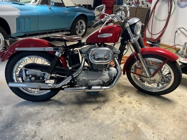

Thanks, it's a 67 XL. It was pretty original when I found it in 2015. Did a full restoration to original except for color.

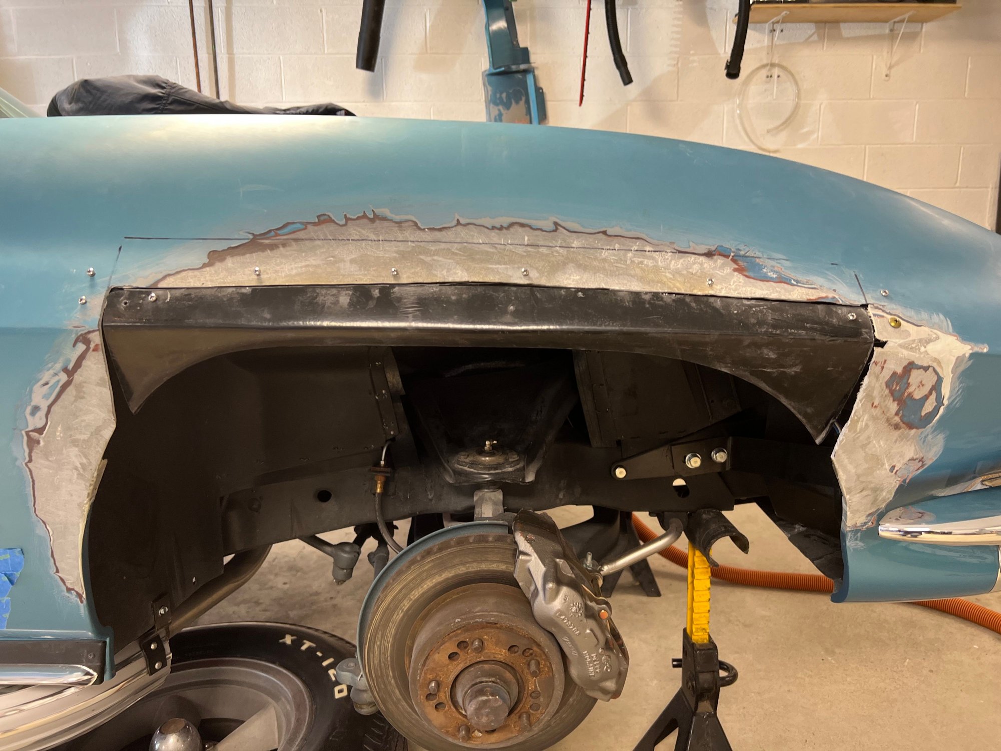

This is what the flare started as.
Yours is looking awesome too....I am a little afraid of spraying base/clear myself.

Beautiful bike. Wow you’ve done some amazing work restoring the fenders.
