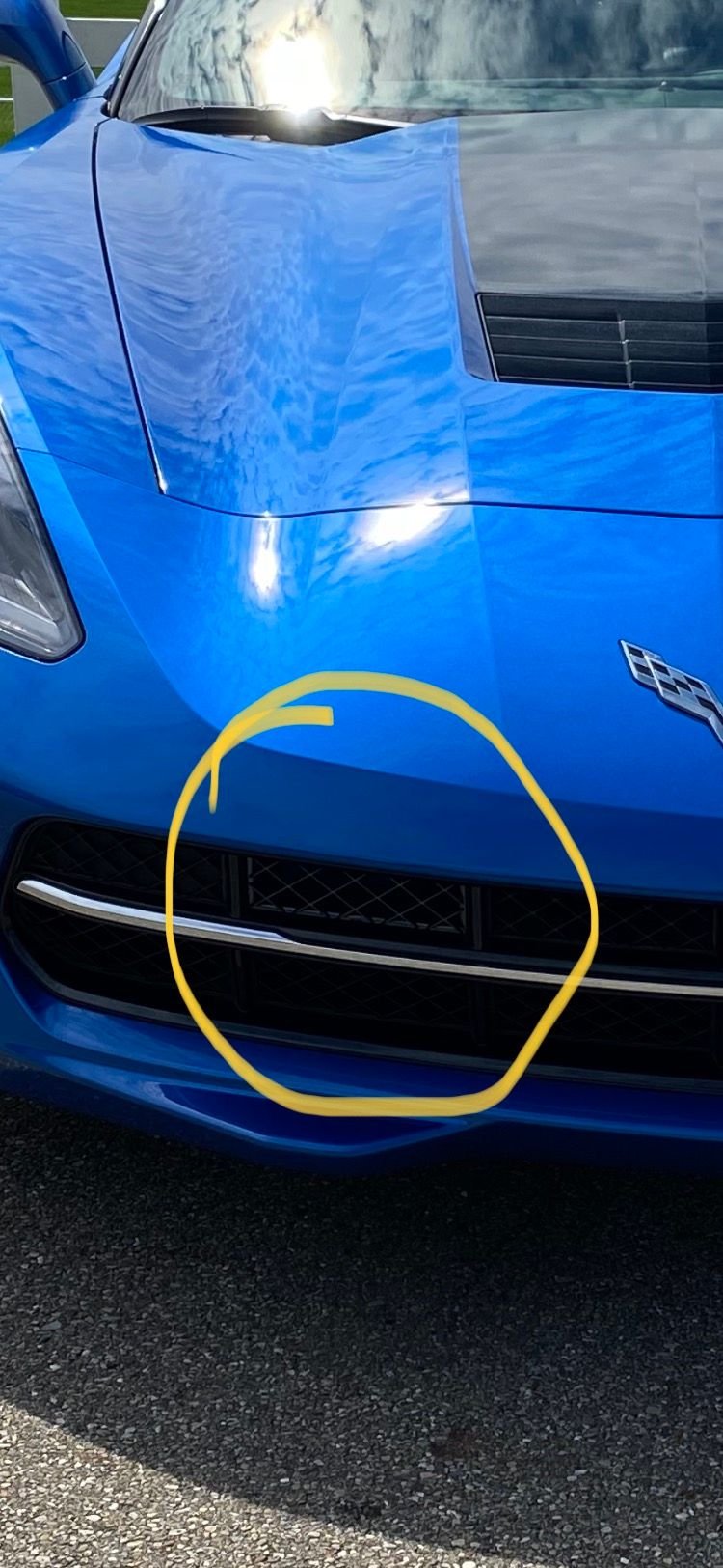

I need to repaint one grill section on my C7. It looks like a standard gloss black, will any automotive paint do?

Each piece in the grill is separate, the dealership where I bought it painted that one section the wrong color when they replaced it. I was looking for a suggestion for a quality rattle can paint to just fix the one piece. I don’t have any painting equipment.
