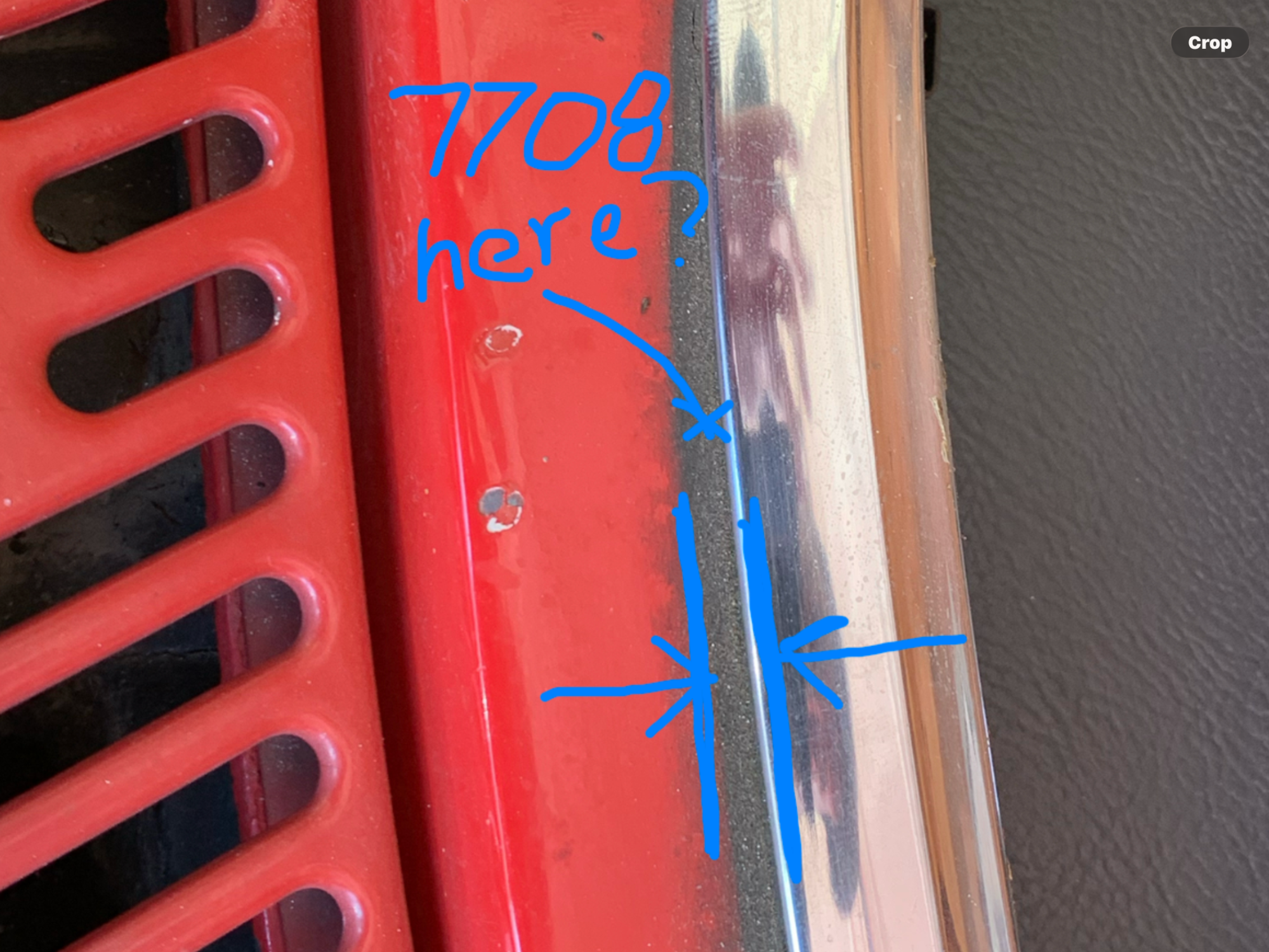

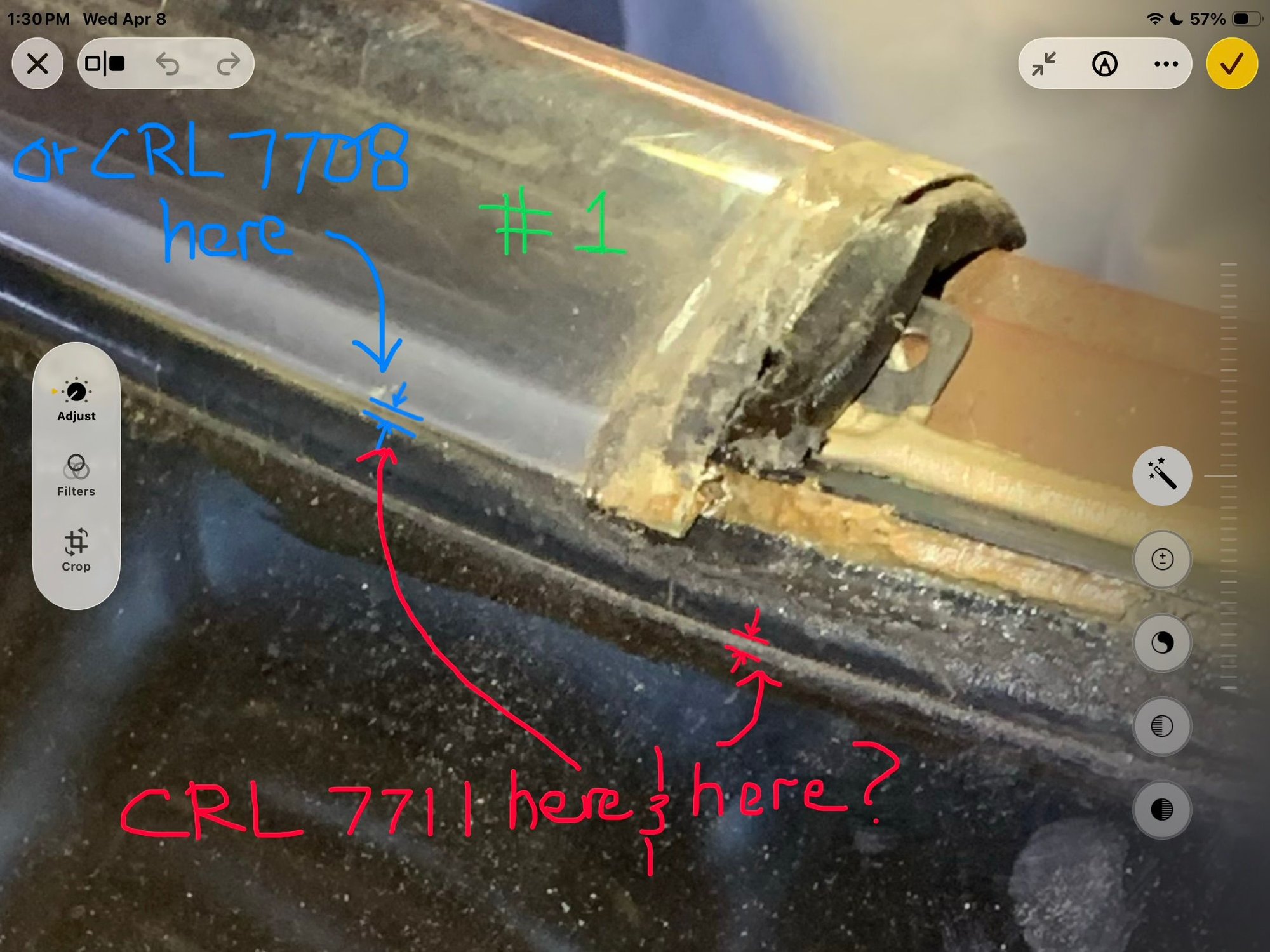

In the #1pic below, there appears to be a factory sealant that was applied - one between the glass windshield and windshield gasket, and another sealant at the windshield to top chrome trim on a convertible. Are both of these supposed to be sealed with the CRL 7711, or just the windshield glass to gasket uses the 7711? If just the windshield glass to gasket, then what’s used at the trim to gasket interface - the 7708?

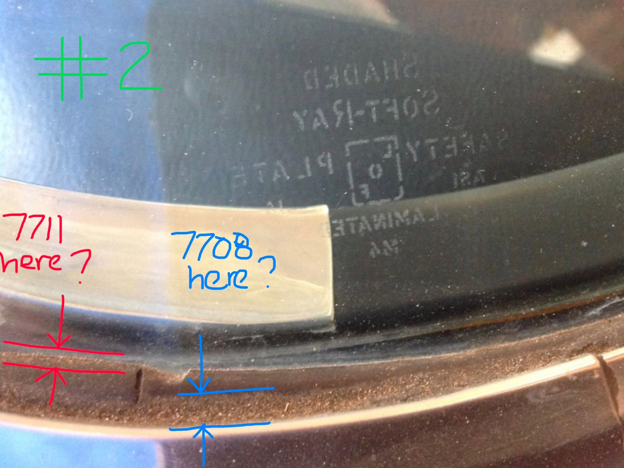

Next, the #2 pic of the lower trim: basically the same questions?
Lastly the last pic showing the trim to body/paint interface- what sealant is used here? 7711 or 7708?
This windshield is the original and has never been out as best I know having owned it the last 42 years. So I believe all the “sealants” pictured are from the factory.
I’d appreciate your comments.

Mine used non-hardening sealant (7708) all around the chrome trim, but it's an '81. I don't know ...about the windshield gasket area on an earlier car. Hopefully someone will chime in. You might ask in the General forum of your gen Corvette ...if someone can check their assembly manual for your year.

My *guess* is a guy would use windshield sealant around the gasket (or urethane/silicone product). Mainly b/c glass can get hot and the non-hardening gets almost flow-able under heat. But yeah, see if it's in an assembly manual.
When I've put on rubber gaskets of older cars and trucks, the gaskets fit tight enough around the glass I usually didn't opt for windshield sealant. But it's probably a good belt and suspenders idea. But underneath the gasket a guy could probably use the non-hardening sealant. I think that's what many mfgr's did that back in the day. Come back and close the loop. Let us know what you found out to be factory correct, to help other restorers.

That's about what I figured. Belt and suspenders approach there ..can't hurt I suppose. 20 years down the road the urethane sealant probably helps a lot. Instead of using solvent to clean off that non-hardening sealant (you can see his didn't clean it off very well), get some 3M adhesive cleaner. That works great and usually safe on paint. But comes at that 3M price premium.
