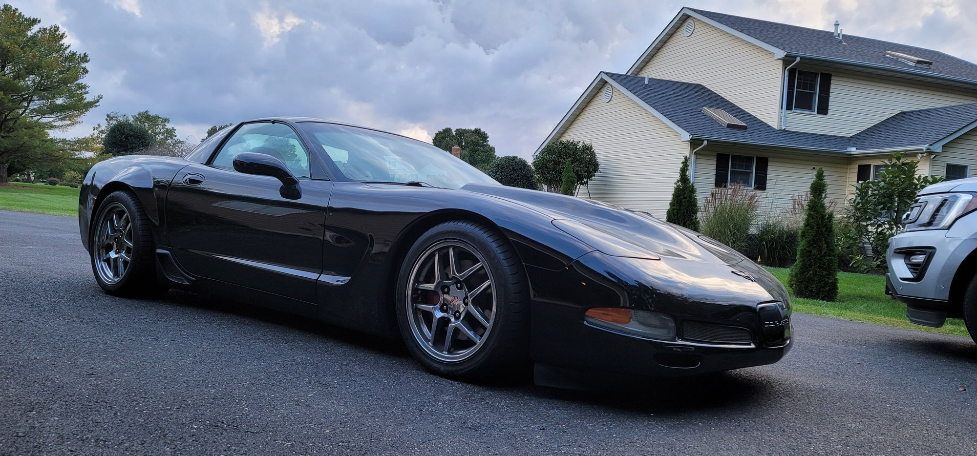

So I have a 99 FRC that I have had since 2011 and when I bought it it had only a vararam intake and which I believe a hurst shifter. first I added the B&B Bullets then I added some 1 3/4 Dynatech Supermaxx headers with gutted cats, a LPE 160* stat and a ECS Mail order tube. it had dyno'd with 331 rwhp and it was running real lean at 13.99. I also added a mantic single clutch and I broke the rear and had it rebuilt at Horsepower Addicts with C6 Z06 out put shafts and I have the stock 3.42 gears as well. Since the dyno I have added the following to my list well since novemeber when I put it on jack stands:
Engine modifications:
TSP stage 2.5 LS6 heads milled 0.020 should bump compression I believe to around 10.5:1 if I remember correctly
TSP Torquer V2 Cam on a 112 LSA
TSP Ported LS6 Oil Pump
TSP 7.4" Pushrods
Comp Cams Trunion Upgrade
Comp Cams Lifters
Cloyes LS1/LS2 Hex-a-djust double roller with z06 chains
Napa LS6 water pump
SLP LS6 160° stat
Slightly Ported LS2 Throttle Body
Peak Speed Ported Fast 92mm intake manifold
SLP 25% underdrive pulley
Bosch 42# injectors
Hinson engine and trans mounts
NGK TR55 spark plugs
MSD supercondutor 8.5mm Spark Plug Wires
Vararam intake with power duct
Elite Engineering Catch Can
Racetronix upgraded fuel pump with upgraded harness
1 7/8 Speed-Engineering long tube headers
Drive Shaft Shop urethane Torque Tube Couplers
RKT Performance built T56 Trans (30 spline main output shaft)
3.90 rear diff (with c6 z06 guts and pinion carrier)
Corsa Sport Exhaust with custom black tips
MSD 2-step (launch control)
Suspension modifications:
Aldan American Coilovers
Progress Front Sway Bar
Progress Rear Sway Bar
Steinjager Front heim adjustable endlinks
Steinjager Rear heim adjustable endlinks
Exterior Modifications:
Corvette creationz wide rear fenders
2 inch motorsport-tech wheel adapters on the rear
Tinted tail lights
Tinted reverse lights
Sharp Light Innovations 3030 LED bulbs
C6 rear splash guards
Vette-Lights 2nd gen smoked 3rd brake light
Vette-Lights smoked rear side marker lights
​BC-Forged LE81 Wheels 19x9.5/20x13
Interior Modifications:
AEM Uego Air/fuel Gauge
MGW Flat stick red anodized shifter
Double din radio
Raptor Shift light
Prosport fuel pressure Gauge
Triple gauge pod pillar
Corbeau FXR Seats with Forged Carbon Shell
VetteWorks Shark Bar Harness Bar
Future Modifications:
Ecs Torque Tamer (need to install)
Nardo grey vinyl wrap (trunk already done)
A&A V3Ti procharger kit 3.8 pulley
The car Should be put back together next Wednesday and maybe 2 weeks after that tuned by Horsepower Addicts in Delaware. my question is what does everyone think my numbers will be once everything is said and done?

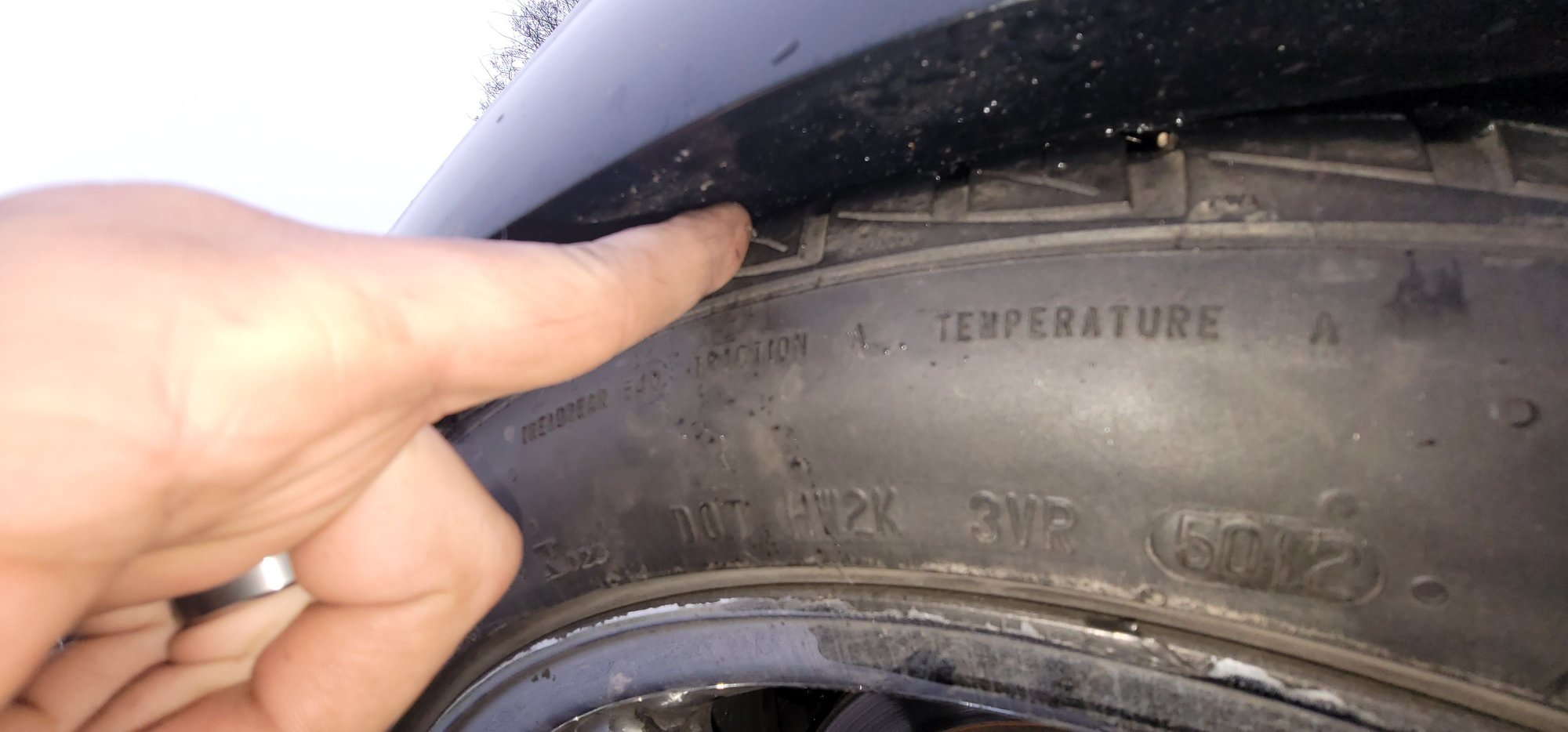

The lip that needs to be cut from the widebody fenders. As you can tell it was rubbing pretty good once I put the coilovers on.

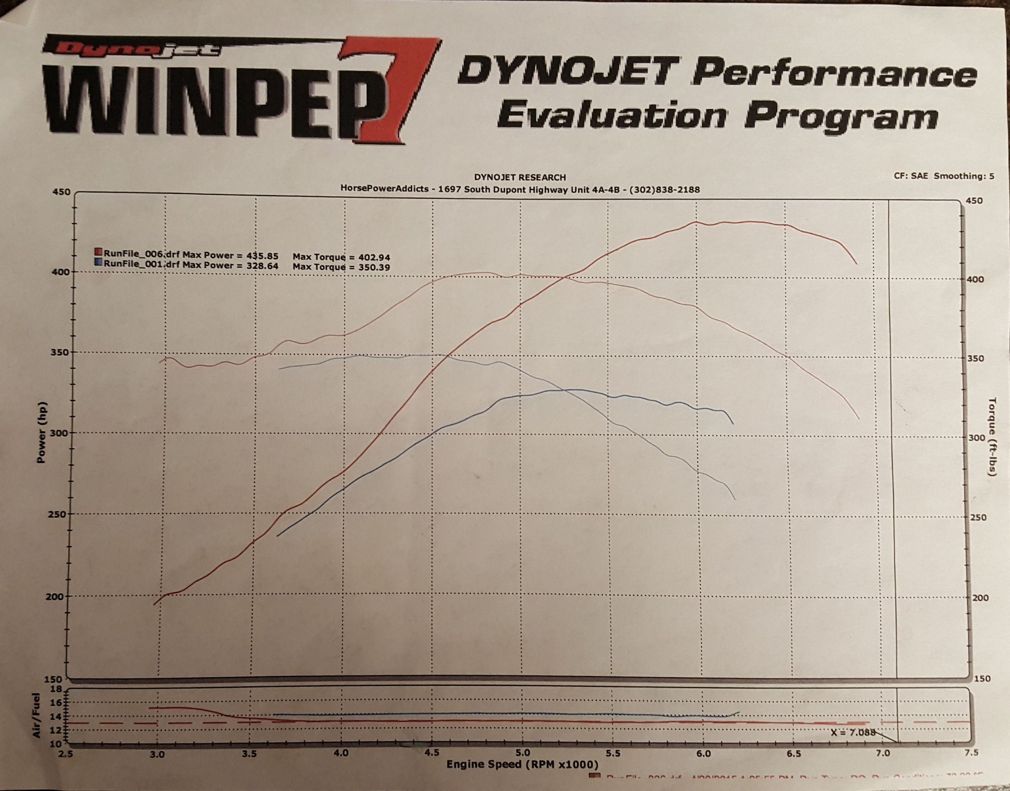

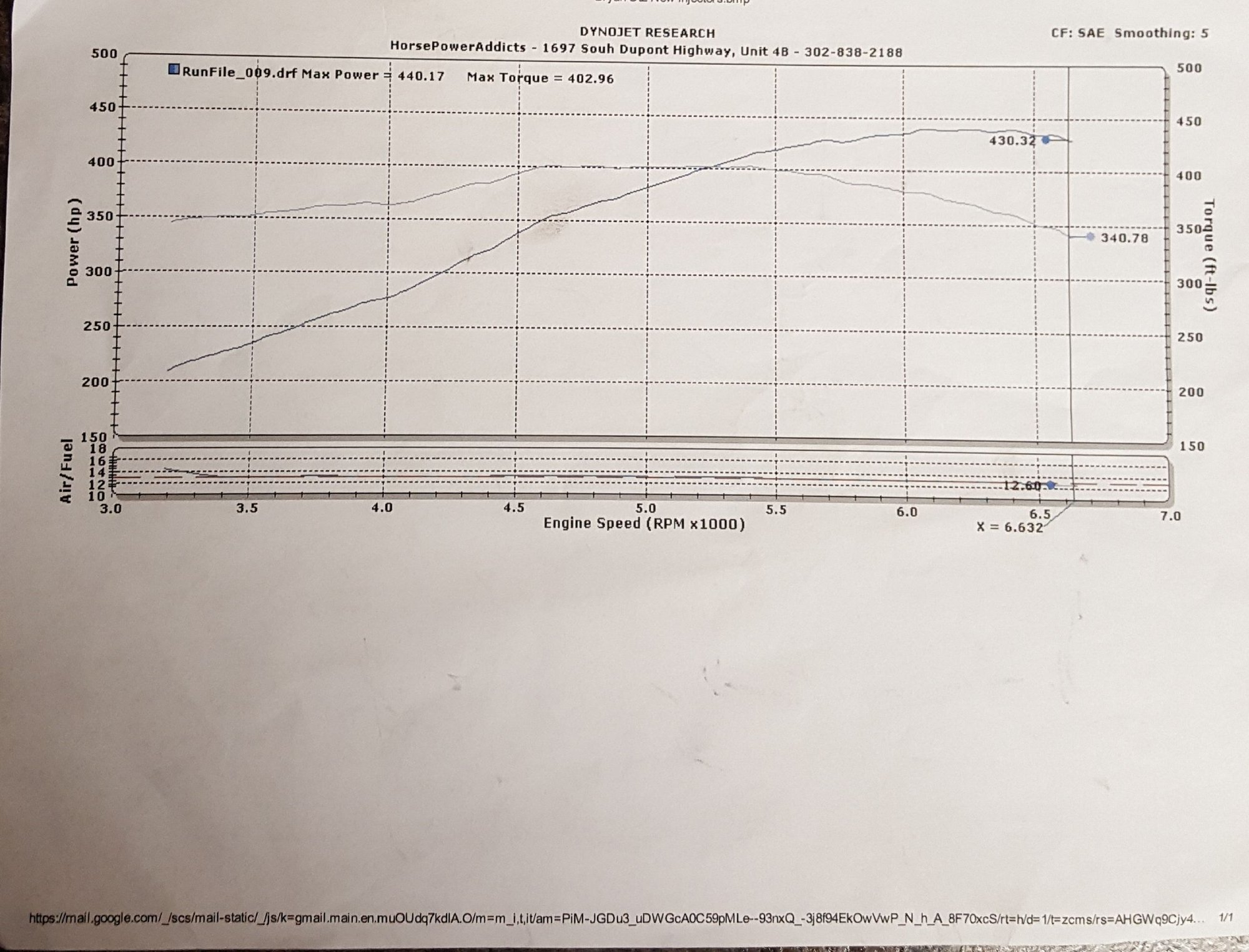

So the car made 435.85rwhp and 402.94rwtrq. Now i just have to get used to driving it lol. Im gonna be installing my air/fuel gauge and motor and trans mounts soon. Just need to try and fix the issue with the active handling needing to warm up and then saying i need to service it. Gonna disconnect the rack and see what happens. I know i accidently moved the steering wheel but i didnt move it very much. Gonna see if the scan tool i have at work will tell me the position of the steering angle

I see u said that a while ago thank u. It is fun. Had to replace those svo injectors with bosch 42lbs injectors and made another 5rwhp. So now its at 440rwhp and 403rwtrq. Now with the 3.90s the car feels awsome. Looking forward to taking it to the drag strip again.

Dyno graph 328 to 435. This is with the crappy svo 42 lb injectors.
This is the 440 dyno graph after the new Bosch 42 lb injectors.

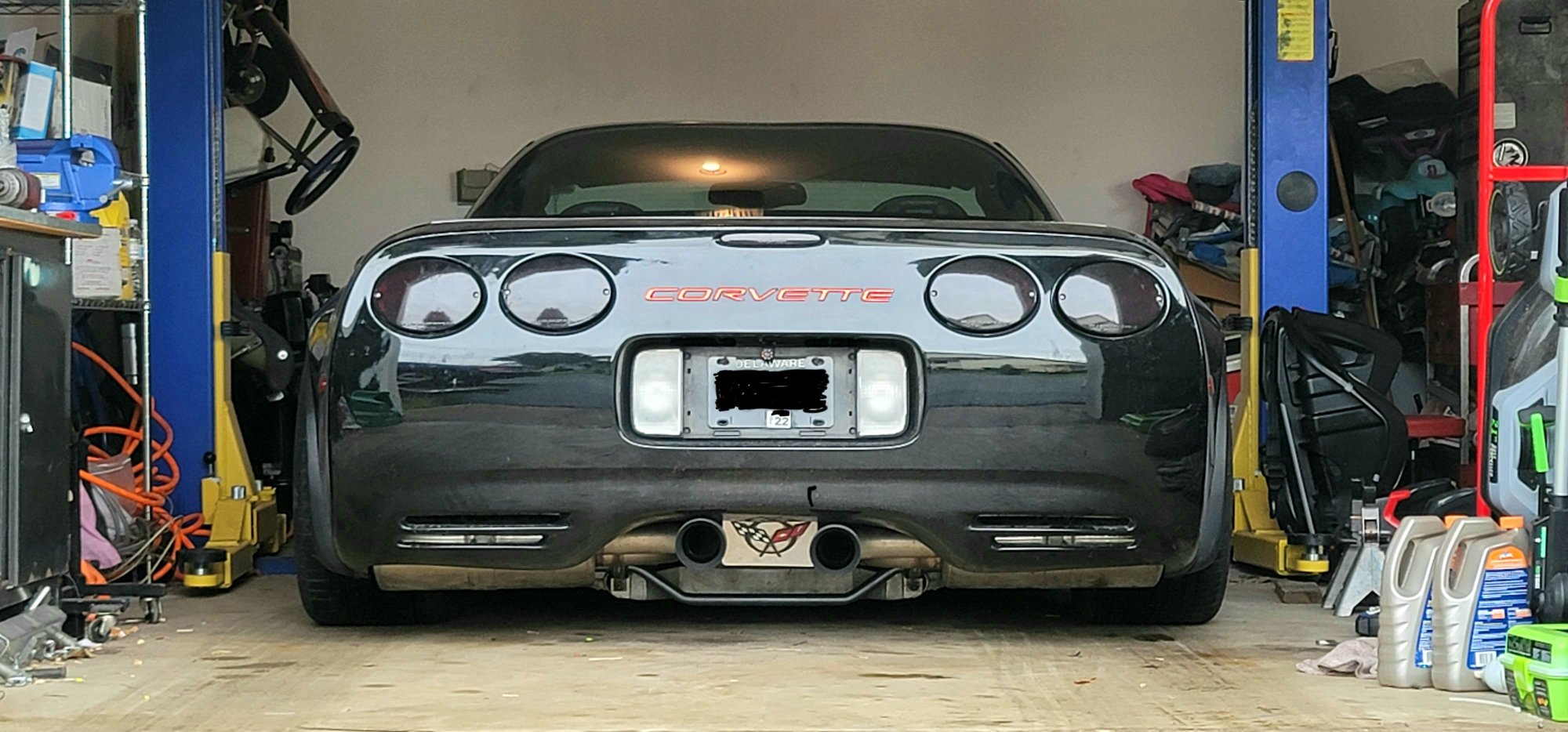

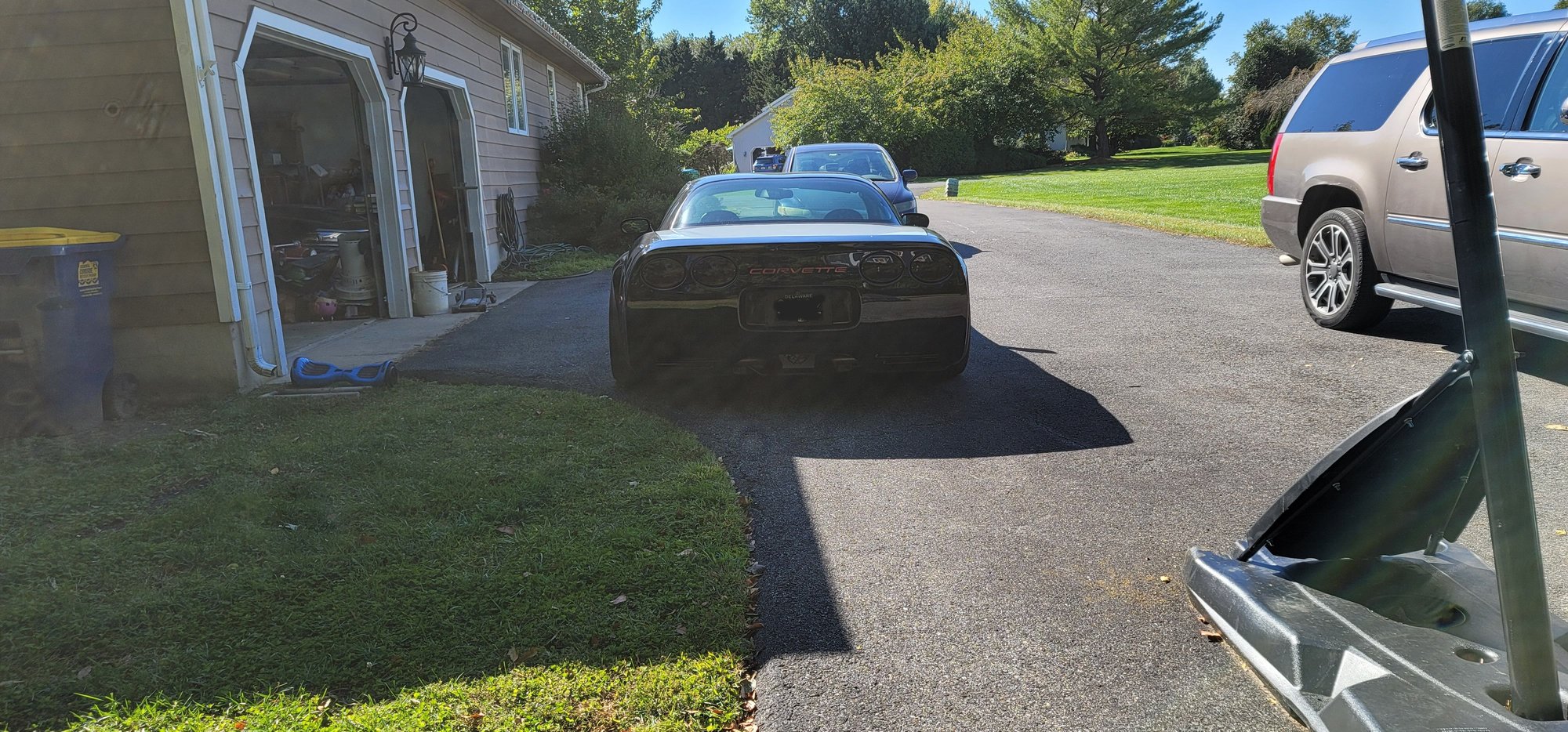

Added the corvette creationz wide body fenders. Now just waiting for my wheel spacers from motorsport-tech.

How do you like the wide body fenders ? Were there any fitment issues ?

Sorry I never got back to you. I love the rear fenders. My body shop guy had to do some work to them to get them to fit better but they look good. Need him to repaint the driver side due to some crows feet in the paint and one spot the bubbles when it gets heated up by the sun but other then that they look good.

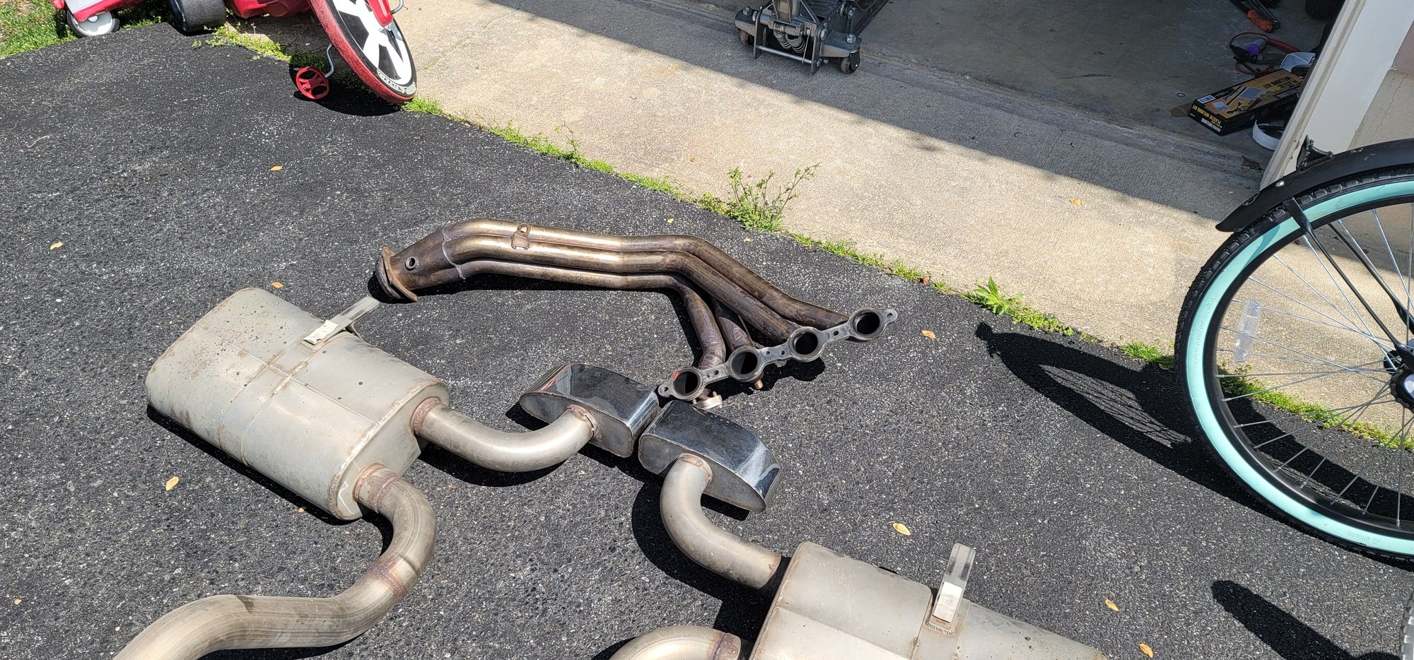

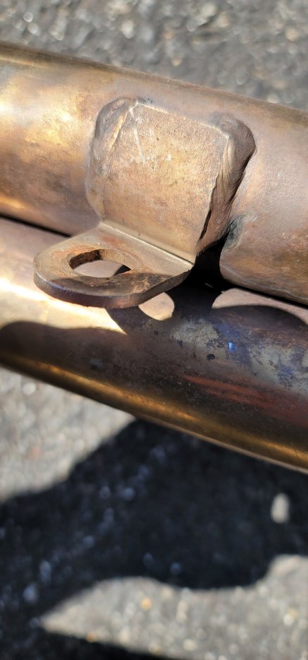

Well sounds like something is coming apart in my rebuilt torque tube. I started pulling it apart yesterday. Gonna pull headers and have a friend weld in a bung for my aif fuel gauge and then look at my passenger header looks like a small Crack causing a very small exhaust leak. If the coupling or what not are coming apart then I'm getting the 1 piece dss coupler less driveshaft.
