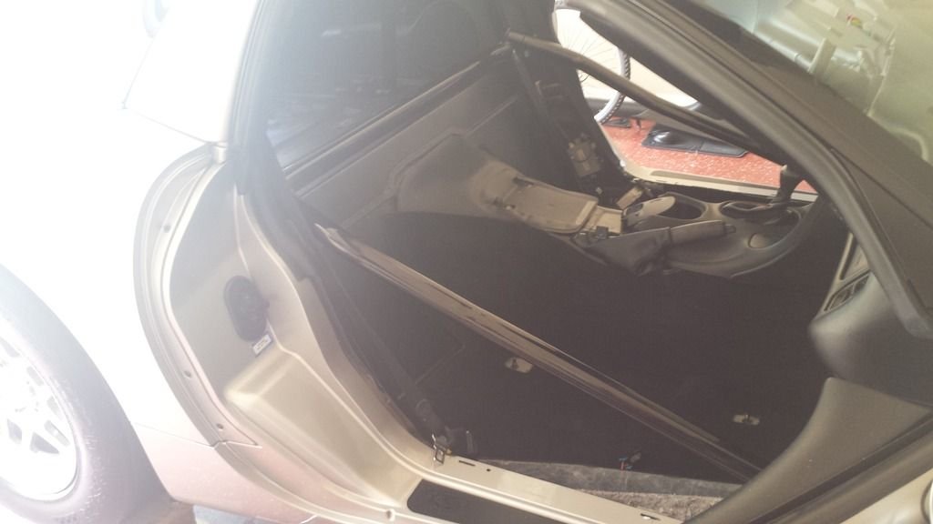

Wendy and I made the 2 hour drive to Ft. Worth on Friday to pick up our 6-point roll bar and 5-point harness from Wolfe Racecraft. They're pretty busy this time of year so it took them about a month or so to complete. We weren't in a hurry so no big deal.
It was 97 today with a heat index of 105 so I thought it would be a perfect day to put it in. Worked on it most of the day and got everything together and in except for the rear carpet in the hatch area and a couple very small trim pieces. Overall it wasn't too bad other than the heat. I think it took about 2 or so hours to remove the interior and get the bar in (worked alone until Wendy got home from work). The rest of the day was carefully installing trim, trimming carpet, etc. trying to get everything back in and trying to keep it looking OEM. Sorry for the poor pictures but it was a long day and I'm too old and too out of shape to be working that hard on my summer vacation!
I was very impressed with the fit and finish and overall ease of installation. For $1K and a day's work we should be legal now to 10.0 and can sort out our nitrous progressive controller and hope to be deep in the 10s without getting kicked out. I'll try to take some better pictures without the sun shining in once I button it all up this week. I'll say this ... when we do our H/C/I it will be during Thanksgiving, Christmas or spring break when it's not a million degrees in Texas!

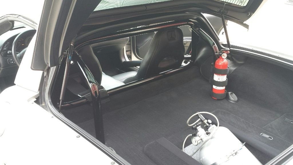

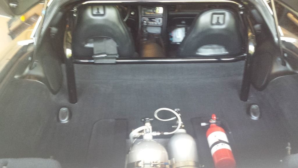

Finished cutting the carpet in the cargo area for the bars and got it all back together. Came out pretty good I think.
Need to mount the fire extinguisher on the roll bar somewhere to be NHRA legal and also would like to put some padding on the door bars to save the powder coating as we get in and out. I'll check with our upholstery guy to see if he can make some vinyl covering for the padding with velcro secure it.
I'll try to take some better interior pictures this afternoon.
Scott

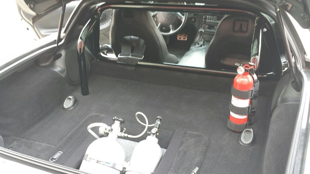

Took some time today to get Wendy in the car to adjust the seat position and belts. Also took some better pictures without the glare of the sun. As soon as it cools down here some (100 again today) we'll get out and test to adjust the progressive controller and get the nitrous dialed-in finally.
Scott

Old Jul 30, 2015 | 10:17 AM
pit-man's Avatar
pit-man
Joined: Aug 2007
Posts: 6,475
Likes: 297
From: Orange Park FL
Nice, what a CLEAN install
