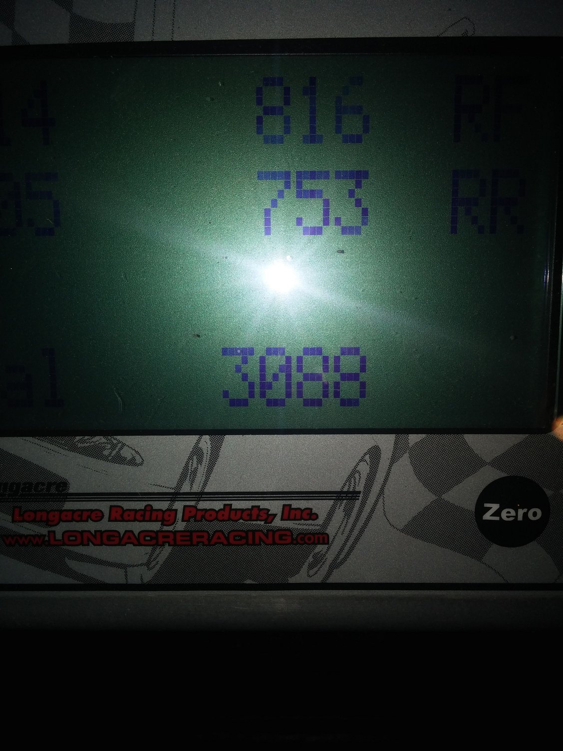

This is what my 2000 FRC weighed with a little less than a 1/4 tank. Only real weight savings is no AC compressor, LT's, air pump crap, and evap crap.
