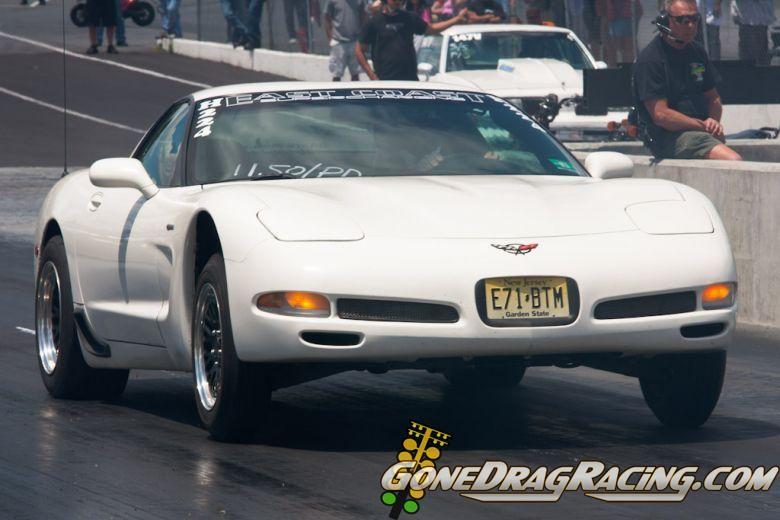

On my 01Z, I used the Lakewood 90/10 shocks on the front. I drove that car a lot on the street and track. No front sway bar. I'm not an aggressive corner burner, but I didn't notice any issues with handling. I had stock shocks on the rear of that car.
Currently, I have single adjustable QA-1 shocks on all for corners with stock springs. This car is not a street car, track only.
I know it's hard to convince people of this, but the stock suspension is very good for most applications, and has been mid 1.3 to the 60' mark by an experienced driver. If you're not getting the launch you'd like, it's more likely the driver, than the car.
And, 18psi is about the lowest I'd go with a drag radial tire. Especially one with very little sidewall.
You know the bias ply tire will help you out... Make that switch and get back to us.
